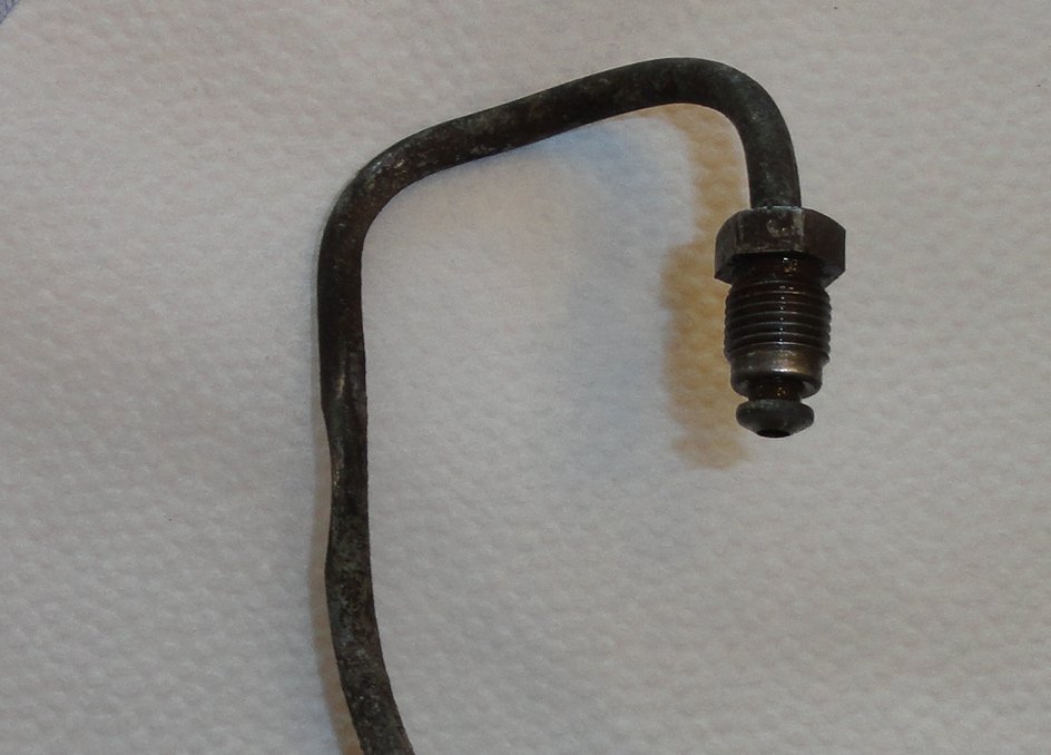

This is the metal brake line between the two front wheel cylinders off a 67 bus. The inner part of the brake drum that holds the grease seal was rubbing on it. I'm glad I examined it closely, it was very close to failure.

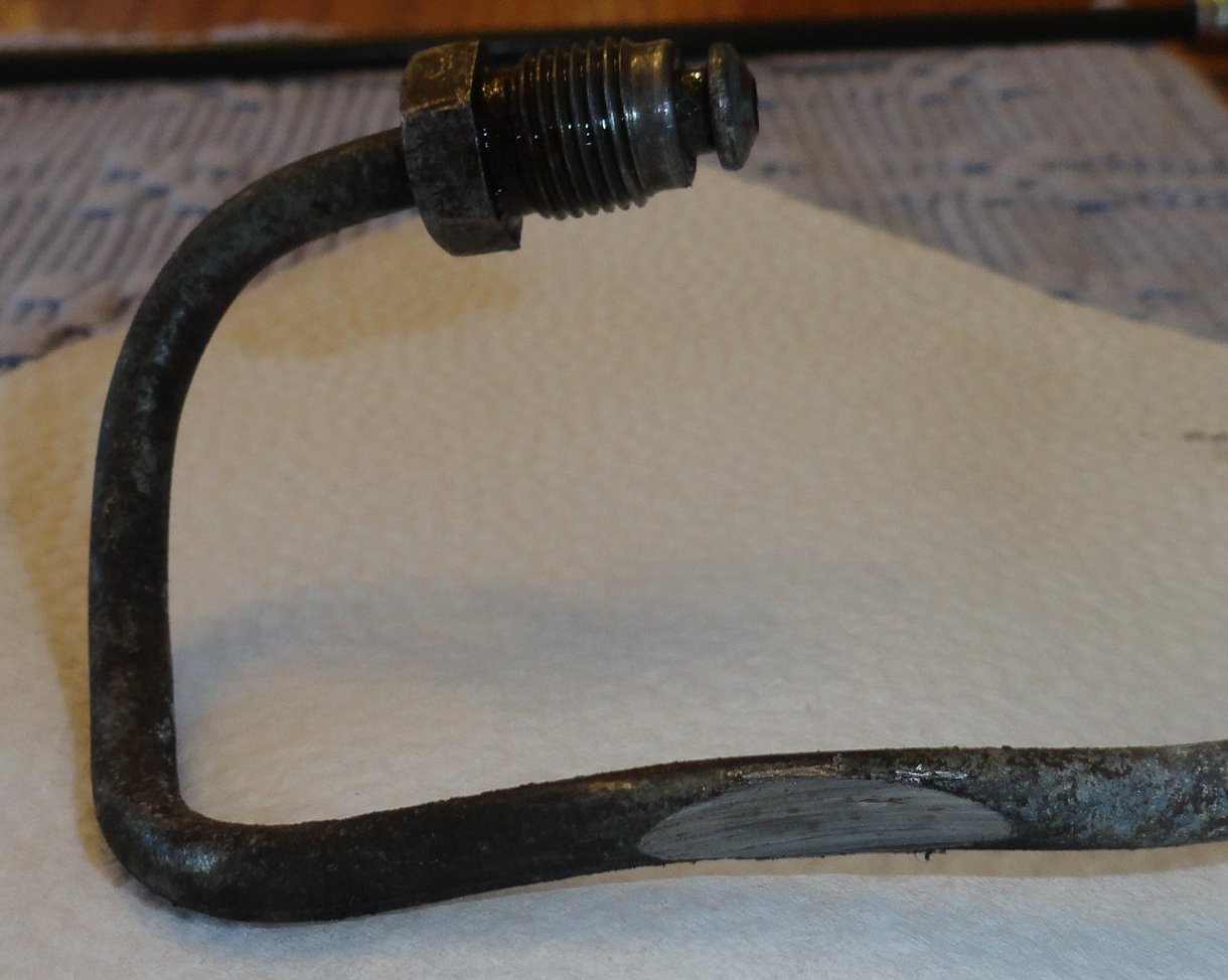

This is the area where wear is likely. This is good installation with the brake line very close to the cylinder. If it is up off the cylinder, it can rub on the drum.
