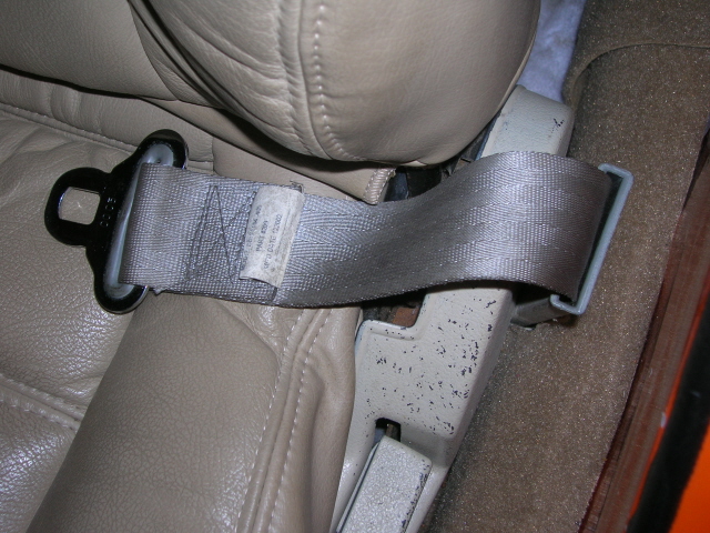

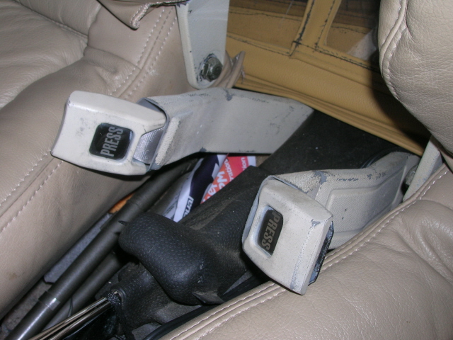

Volkswagen did have an OEM 3 point system on the 181 when it was marketed in England as the Trekker. This system used some uprights that were attached (bolted?) to the middle door upright. Surprisingly it doesn't follow the high and behind rule, just high.
181's first sold in France from 1974 on have also the OEM 3 point system .
It is welded to the middle door upright . Wink[img]
