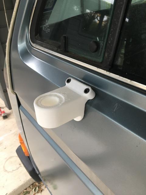

remraf
Joined: February 25, 2007
Posts: 291
remraf is offline
PostPosted: Fri Feb 03, 2017 10:18 am    Post subject: Re: Jeep Wrangler mirrors? Reply with quote
Funny, guess great minds think alike. I bought some of these mirrors a year ago but didn't want to cut holes in van. Started making mounts in CAD and finished the rough design a week ago. Printed prototypes and angle to door and hole mounts are all great. I plan to modify the appearance to make them prettier and will move on to first prototype in billet on cnc in a week.

remraf
Posts: 291
remraf is offline
PostPosted: Fri Feb 03, 2017 10:41 am    Post subject: Re: Jeep Wrangler mirrors? Reply with quote
Franagon wrote:
BAM! Let me know when you get these done! I am in for a set! Sweet! Way to go!
Wow, wasn't expecting a lot of interest to be honest Shocked. One drawback to my approach (not modifying door) is complexity. These will involve a lot of setups on cnc unless I got a quote for a run on a 4 axis, which will not be affordable. I'm currently designing some fixtures to mix cnc and manual machining to make them doable. Hoping to do them on my mini cnc to justify it's purchase to my wife Very Happy . After machining plan to powder coat in black.
Last issue I'm concerned about is how tight VW's tolerances were for door holes. So if some people are interested in being guinea pigs let me know. Appears some folks may be interested in heated mirrors, my design currently doesn't account for them (live in texas). If that is important let me know, I'd need to add another hole to the design.
Franagon
Joined: January 13, 2009
Posts: 228
Location: Savannah, GA
Franagon is offline
PostPosted: Fri Feb 03, 2017 1:02 pm    Post subject: Re: Jeep Wrangler mirrors? Reply with quote
I was picturing a milled slot that goes from the stock vanagon wire pass through hole to some where down into your mount. I think that would be just 2 set ups in a manual mill. One on the plane that the standard vano mirror mount and the other in the plane of the side of the door. You would add a hole in this set up to get the wires into the hole for the mirror to sit in. I don't know enough about the jeep mirrors on how their wires get into the mirror from the mount. This will grow some legs. I will do some trials for you. You can leave them bare for that, then we can powder coat when you are done with the iterations. I just eyed some new FJ Cruiser mirrors today. They are a similar mount and a good size and shape to fit the vanagons. Cool stuff!
