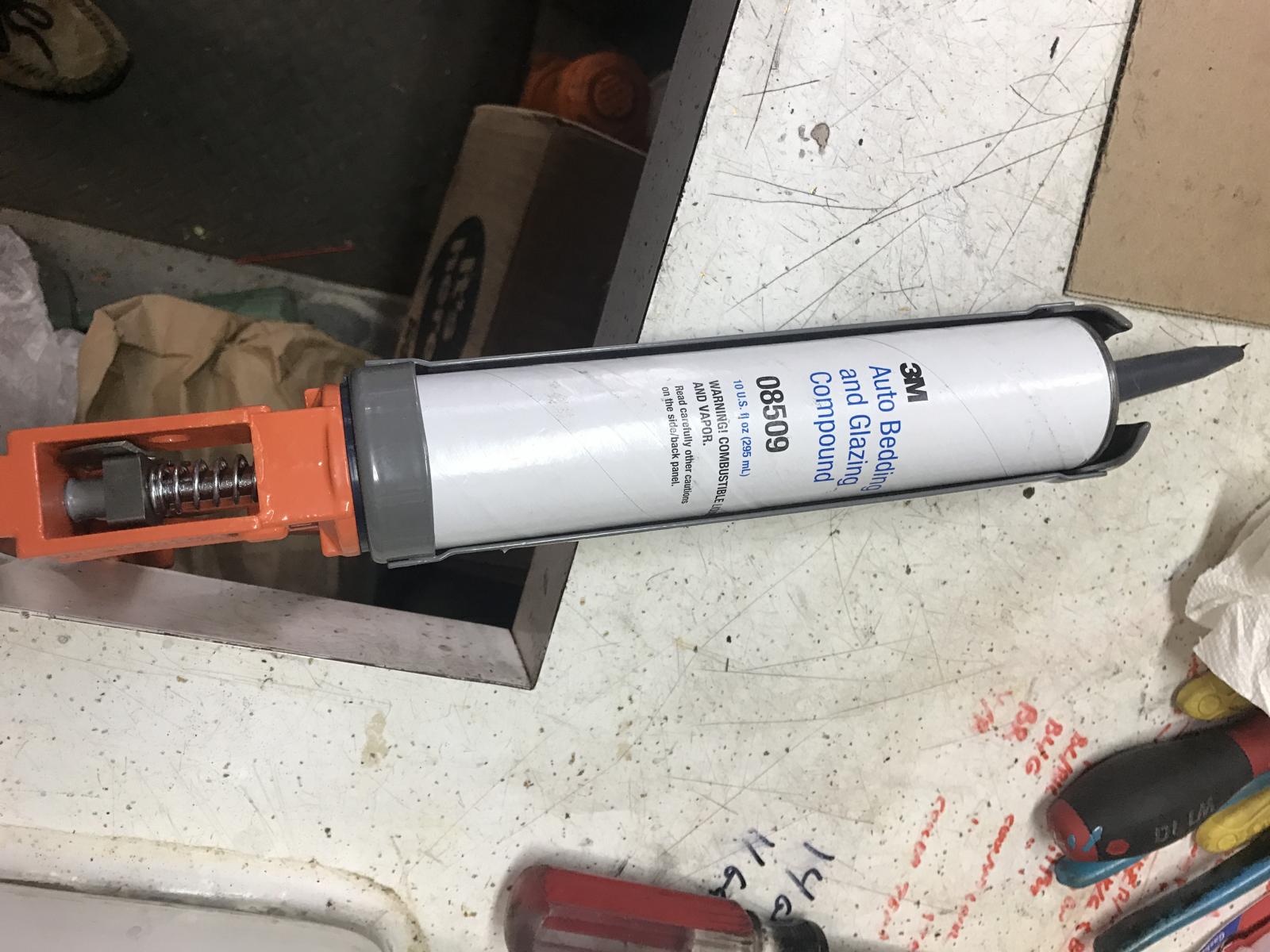

Likely your windshield seal is leaking at the bottom corner. The water can get under the seal anywhere above there. On a dry day have a friend take a garden hose to the windshield and front end while you carefully watch inside and you may be able to see where the drip is. Many have had success by using some sort of sealant under the seal around the windshield.
Here is your "some sort of sealant".........
It is non hardening, flexes and still seals.
It also does NOT glue your windshield into the body!
Old rubber mounted glass needs to have some flex, modern cars sometimes use glass almost as a structural component.
Dave

So Dave, if I want to try and seal the windshield, can the 3M product you suggest be injected under the gasket, or do I need to remove the glass?
