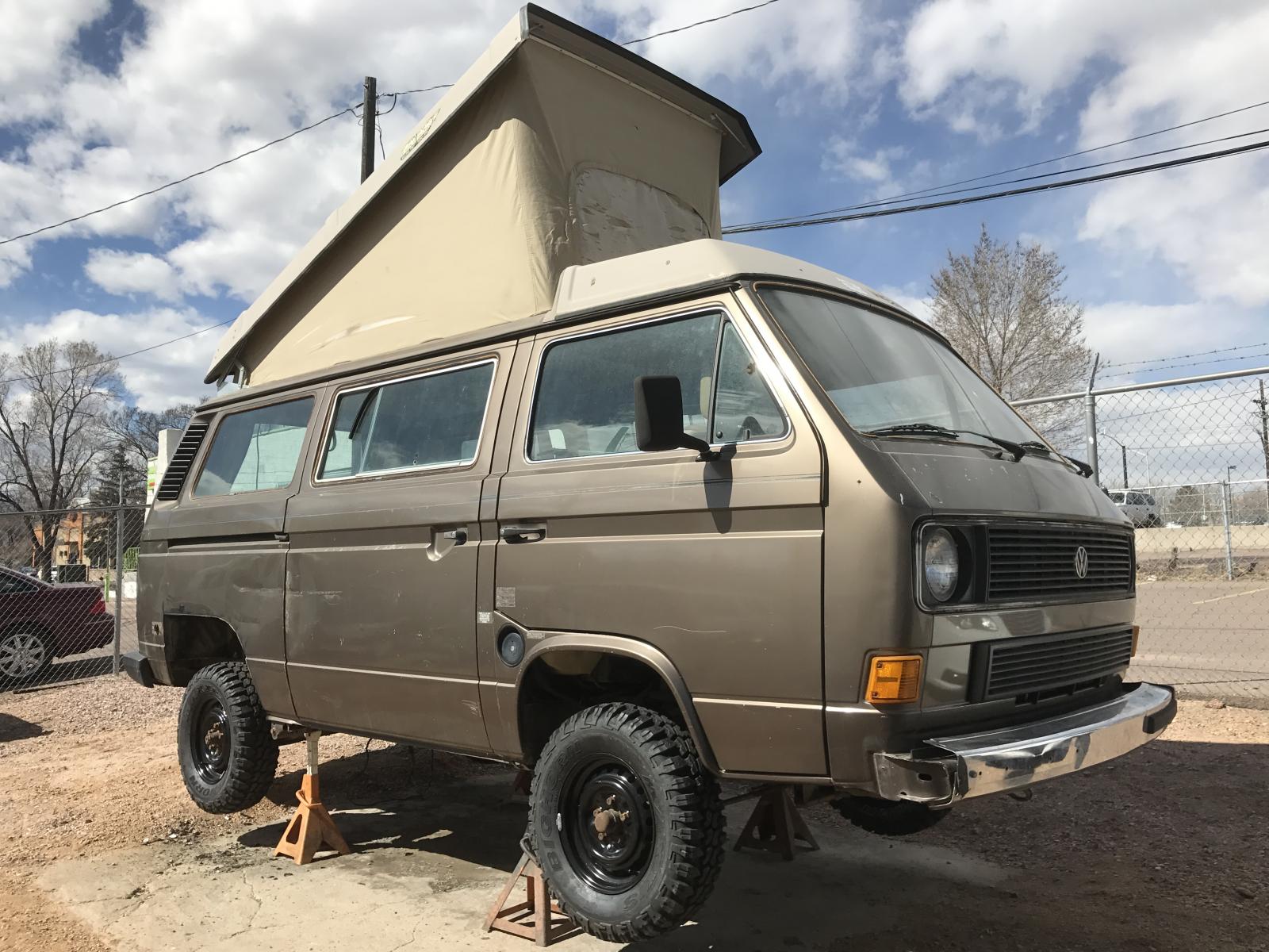

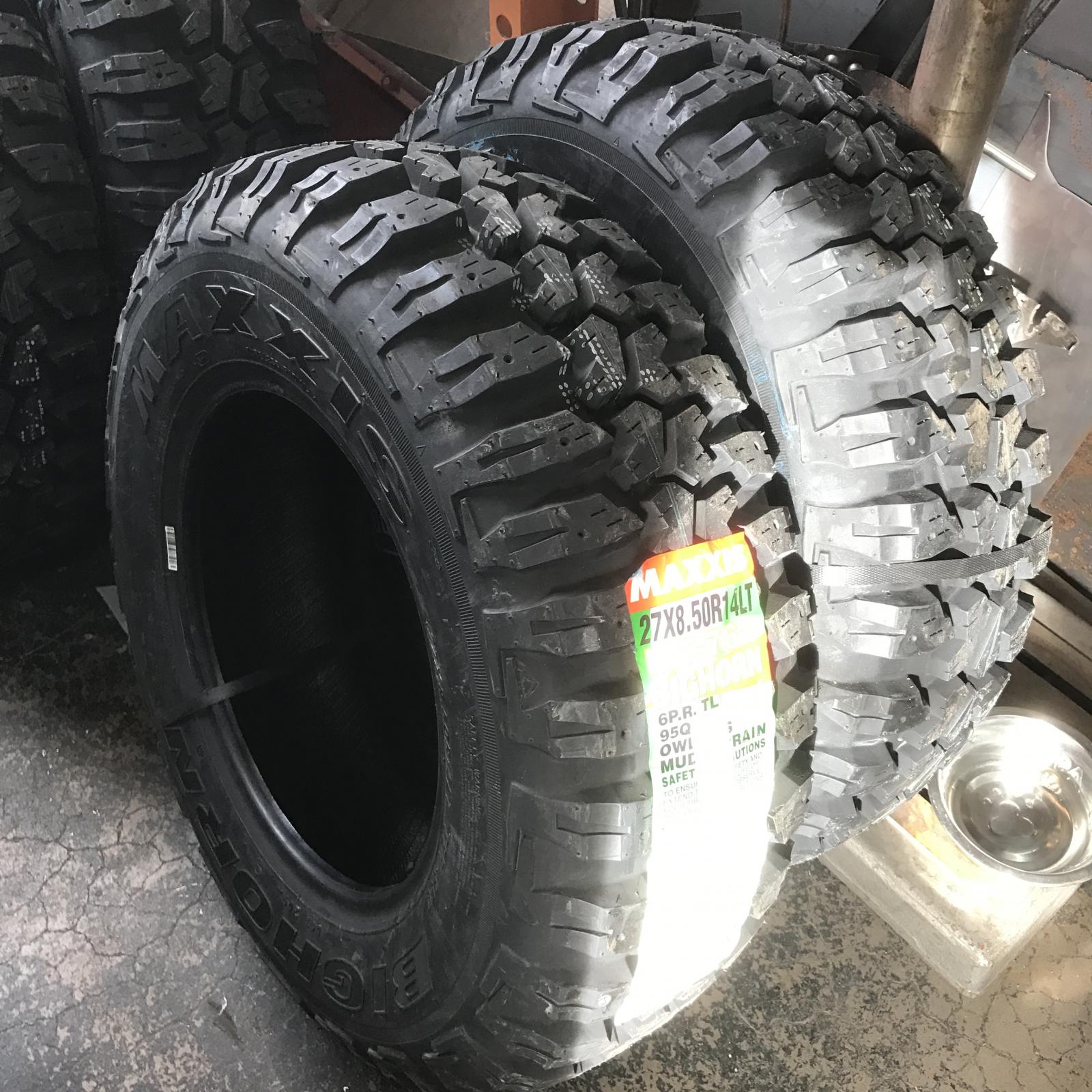

I ran 15"s on my old Dormobile. I have friends with later Buses who run 15's with BFG's as well. I think they run a Passat rim? There's some options from the Vanagon world.
I have these 14" Bighorns on my Vanagon. They would fit your Bus as well.
