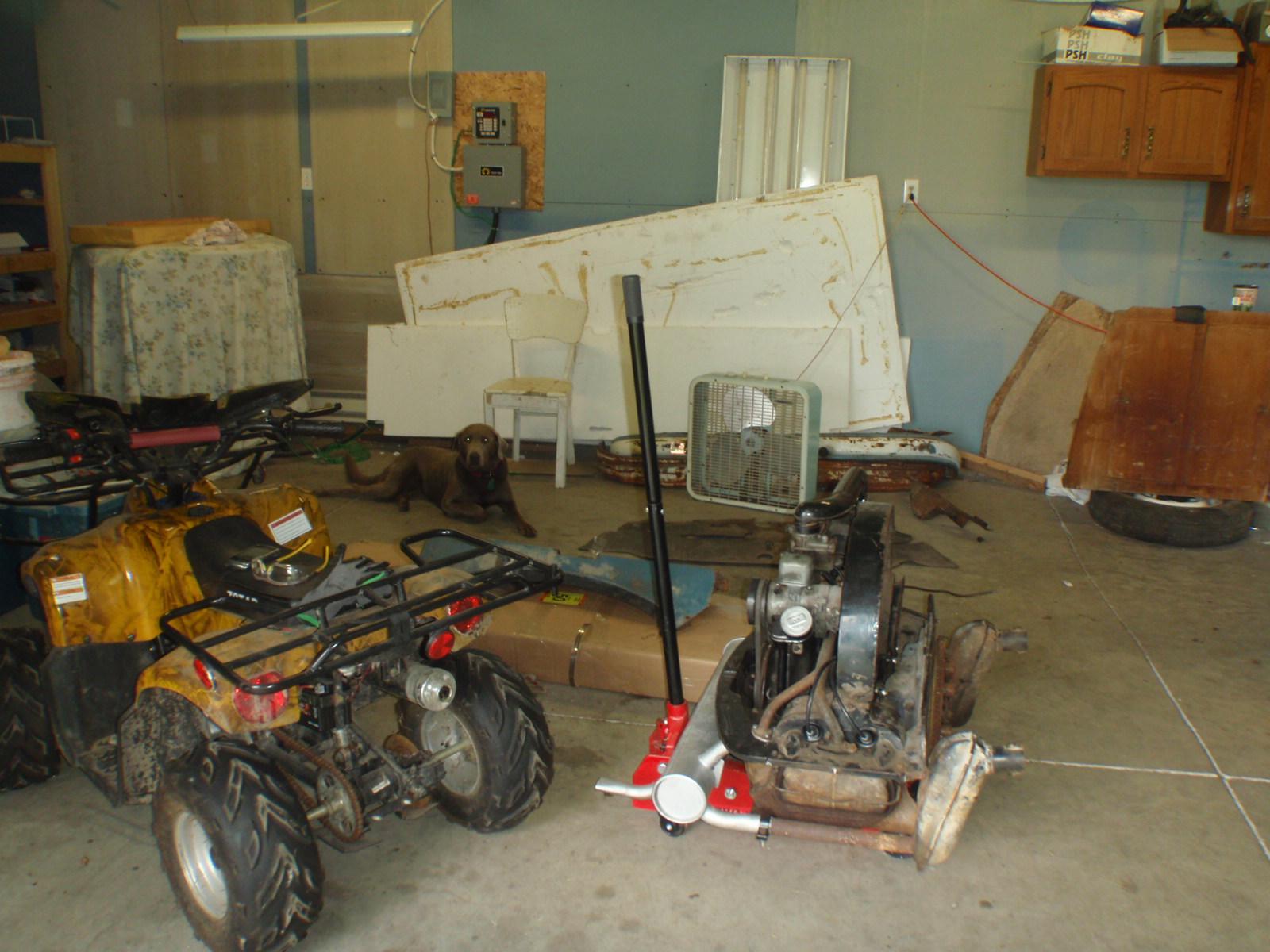

The bus came with a 36hp that was 'supposed to run' with a ring job sometime in the past 10 years although the rest of the motor is unknown. It came out as well for servicing and installing of heater boxes and single tip muffler.

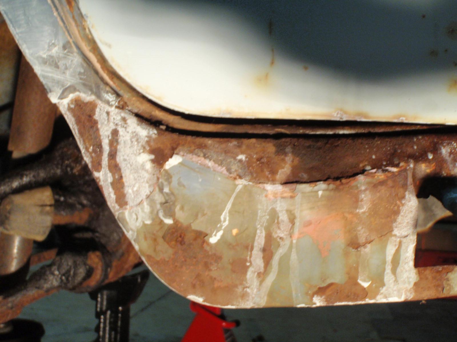

Also dug out some old bondo on the pass. dogleg. It was over an inch deep! used to fill dents that were to hard to dolly out due to the inner dogleg being in the way on the back side. The bus must have taken a small hit in the front corner at some point in the past. I have some og paint dove blue dogleg sections that I may use to repair and blend with some Glasurit L31 I had mixed up.
I also stripped the white paint of the pass. front door, it was mint dove blue underneath! I have no idea why it was painted as I expected to find damage as per the dogleg but there was none!
