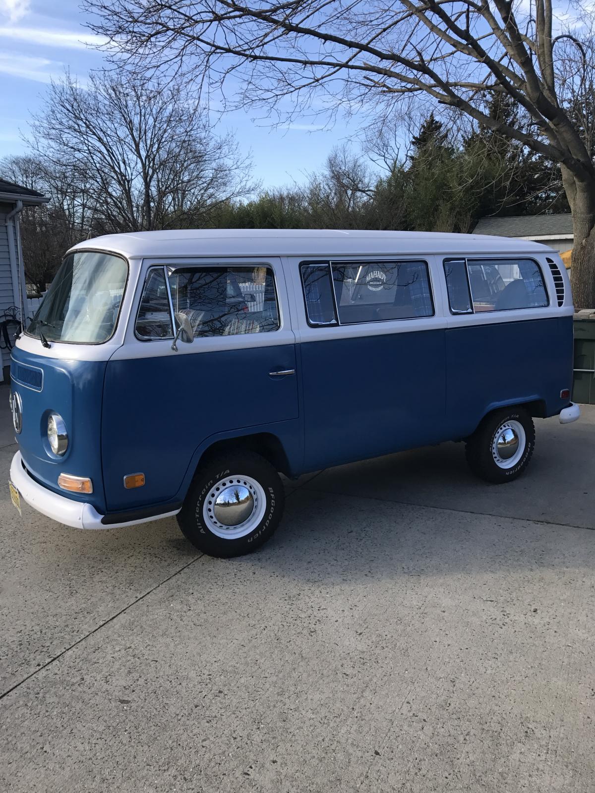

painted my bus last year in my driveway, used a cheap Harbor Freight HVLP paint gun with my little compressor. Yes I used the Rust-Oleum oil based paint, I used 2 quarts of the Royal Blue and 2 quarts of white. I mixed the paint with acetone and Japan dryers, the acetone thins the paint and makes it go on smooth and it dissipates quickly un like paint thinner. The Japan dryers helps the paint cure quickly since oil base paints take a long time to dry. Took me 3 days to complete. I drive her everyday and have taken numerous camping trips all year, the paint is holding up very well, yes I know oil base paints aren't made for automobiles but I wanted a quick inexpensive paint job to make her look pretty for awhile

PostPosted: Tue May 09, 2017 6:07 pm    Post subject: Re: DIY Painting Reply with quote
Looks good! What was your ratio of paint/acetone/Japan dryer?
