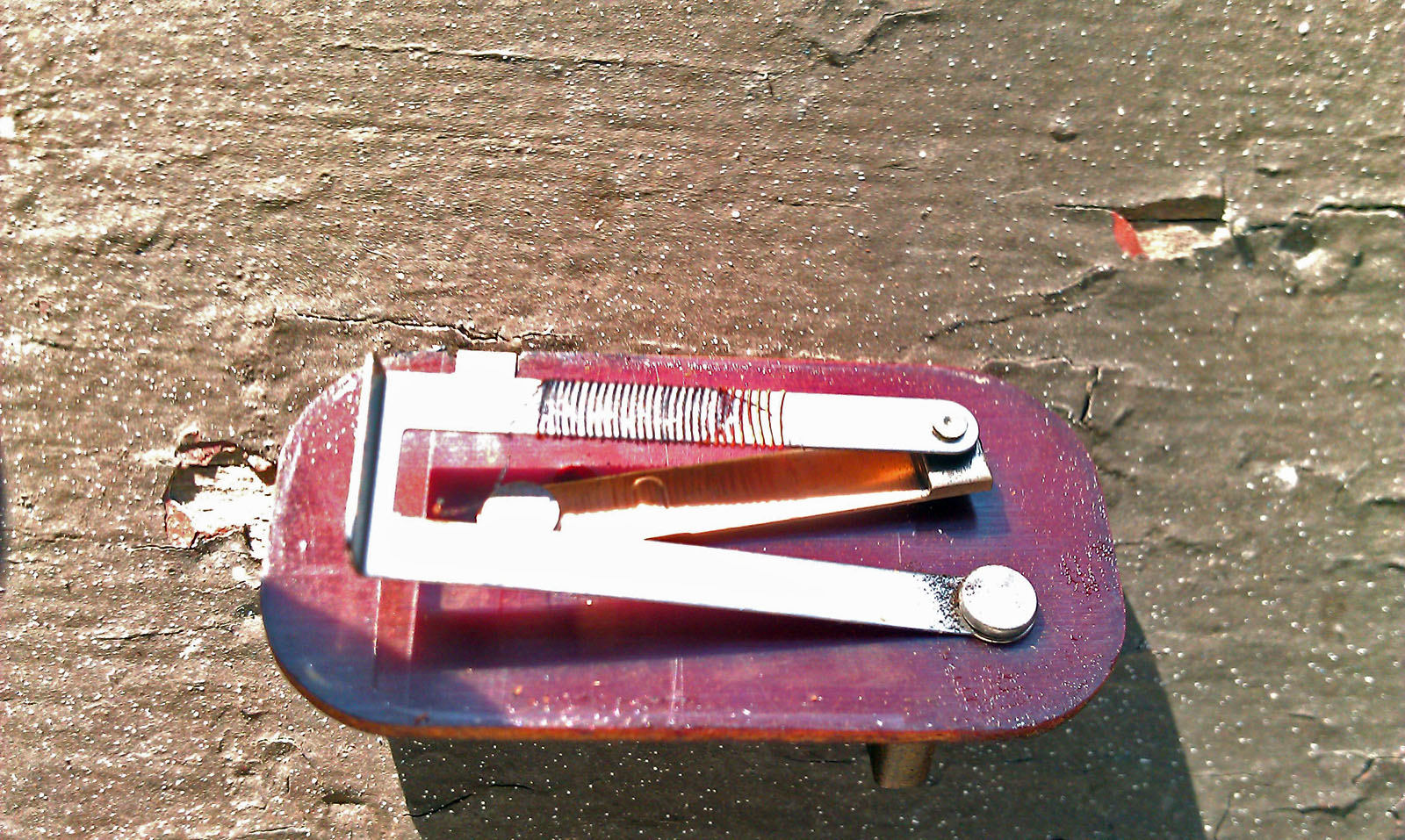

Inside a VW Fuel Vibrator
Works something like a Christmas light flasher. Cheap, but functional.

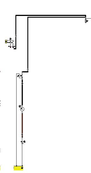

This is a simplified current track for the fuel gauge system
Power is supplied to the circuit when operator turns ignition key to "On" position. Power is then applied (via Black Wire) to the hot side of Fuse 1. Note: This is the hot unfused (input) side of the fuse box therefore the gas gauge circuit is not a fuse protected circuit. The voltage (12VDC) is then applied (via Black Wire) to the Regulator which reduces the voltage to a range of 5-6 VDC. Output of Regulator is connected to fuel gauge. Excess voltage is burned up and sent to ground by using a load resister, light bulb, or other solid state device. Note: Regulator must have a good ground in order to function properly. Normally, mounting it on the back of the speedometer is sufficient. Fuel sender with its variable resistance is connected (via a Brown Wire) to the other side of the gauge.
