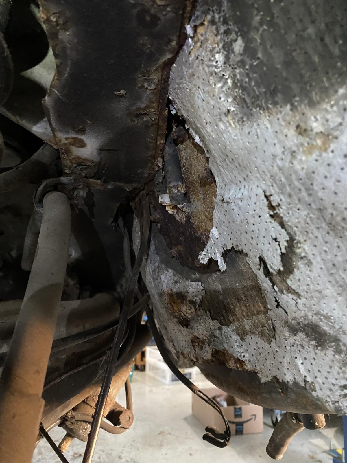

PostPosted: Mon Nov 08, 2021 10:16 pm    Post subject: Re: Syncro tank removal advice needed Reply with quote
Hah! The only fluid in that tank is a gummy mess from 15 years of sitting. Notice that the drain hose is not plugged.
Does not seem to be structural rust yet. But plenty of surface rust to deal with. We will see what awaits behind the tank….
Dave O

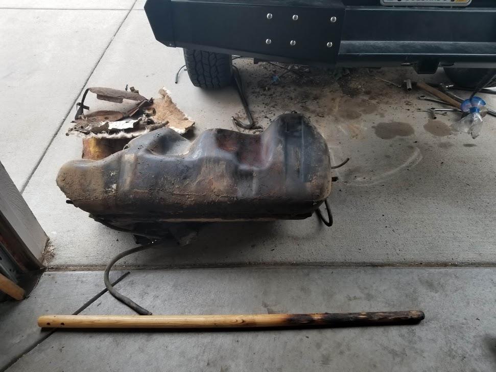

PostPosted: Tue Nov 09, 2021 6:24 am    Post subject: Re: Syncro tank removal advice needed Reply with quote
This worked for me:
http://syncro.org/removing-the-syncro-gas-tank/
Good luck!
ETA: This post hole digger pole was the tool that finished the job:
Joe T.
