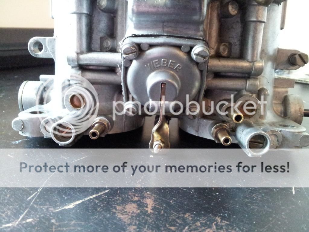

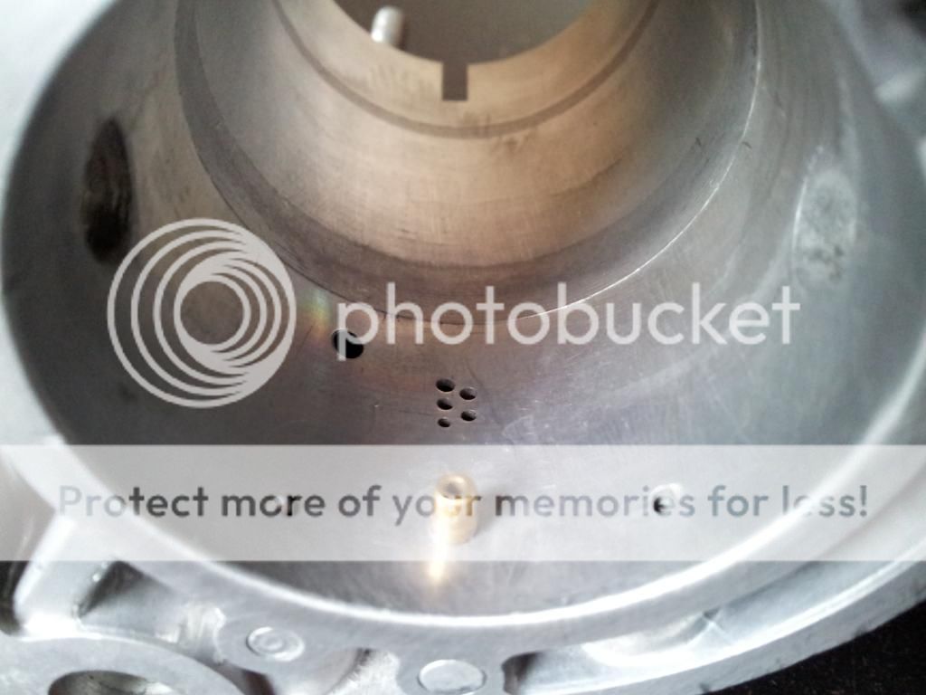

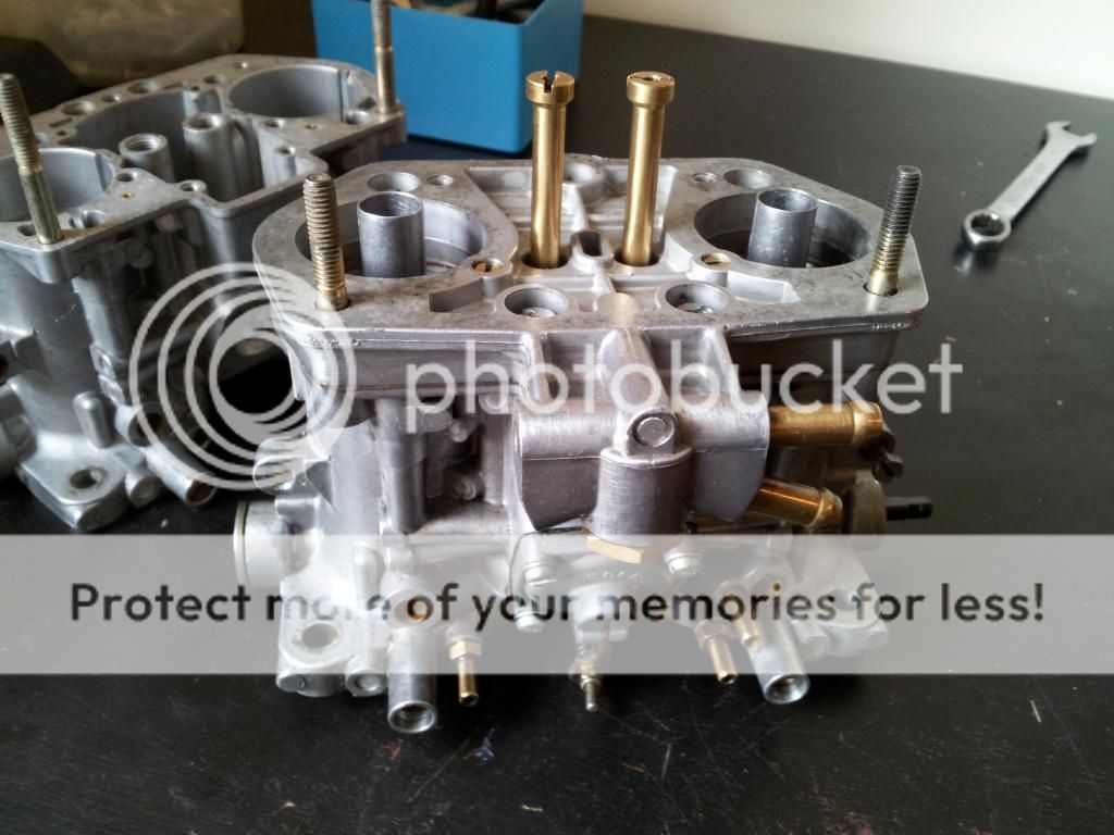

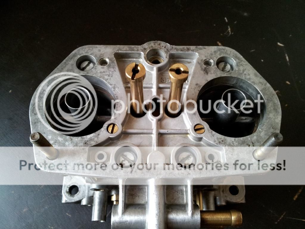

Apologies for the slow reply! time difference and shift working patterns tend to interfere with important stuff Smile I thought I would post some pictures so you can see what we're dealing with. they have 5 transfer ports , but am not sure where to measure for idle air bleed size? excuse my ignorance Embarassed

PostPosted: Thu Nov 22, 2012 1:22 pm    Post subject: Reply with quote
No problem man, I'm impressed with the pictures Very Happy
I can SEE that yes, in fact these carbs are very different. They have all the same features as my alfa 36 IDFs, and MORE.
I see LARGE idle air bleeds, these are the brass inserts pressed into the top of the main body, about 1 CM away from where the idle jets screw in.
The large idle bleeds and five large transfer ports REQUIRE a large idle jet. I'd start with .60
I also see they have large diameter tops and extended aug.vents (much like the 44idf Very Happy ) SWEET
SO, yeah, they are quite different than usual, but different in a GOOD WAY Very Happy
A lot of folks have wished the desirable qualities of dellortos and webers could be combined, to create the web-orto Laughing I believe that these hybrid carbs already exist, and YOU have a set!
The odd emulsion tubes may also be part of the improvements, but unfortunately I don't know for sure. If I were you I'd get some normal emulsion tubes(like I listed earlier) to use to get these running and tuned in on your engine, then go back and try these f-67 tubes later on.
