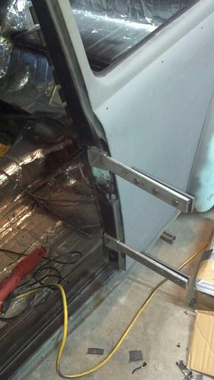

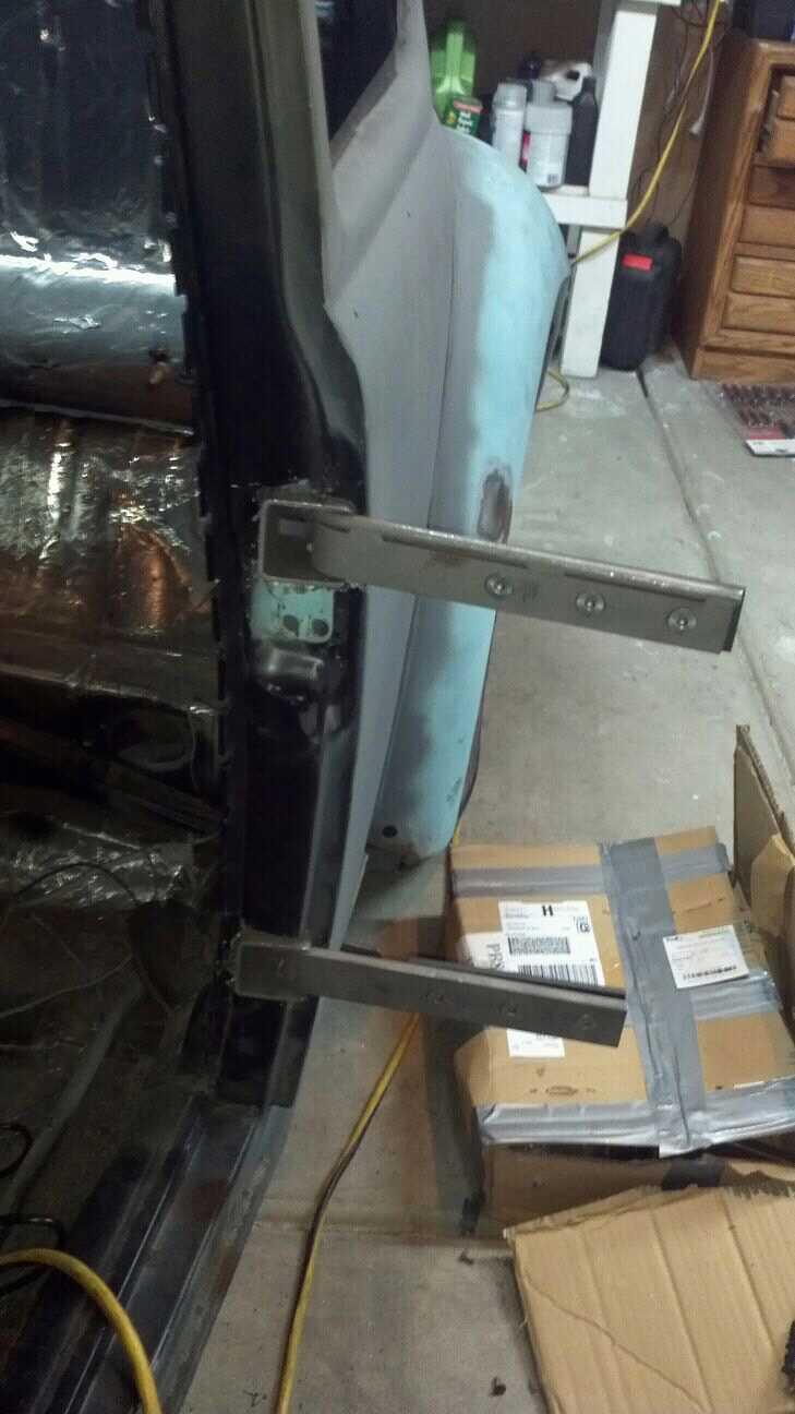

So i decided to install suicide doors in the 72 VW Standard I have. I am sure there must be a post but wanted to make it easier to find... here is the website I am following and what I have done on the driver door just to show how easy it can be.
http://www.kustomcoachwerks.com/forums/viewtopic.php?t=972&start=0
Also, I found these Hinges on Ebay for $100... There are cheaper options then just AutoLoc or Suicidedoors.com....
These are the hinges being used:
Tools so far:
Angle Grinder w/ Cutting Wheel
Vehicle Body Saw w/ (Specifically) Metal Cutting Blade
Screw Driver
Level
Pliers
Gloves
MiG Welder (This has not been Welded Yet

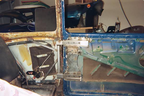

There are a bunch of pics of my suicide in my build thread
http://www.thesamba.com/vw/forum/viewtopic.php?t=496558

I was looking for this thread. i had seen this thread before but didn't remember where from.... Due to the fact that i needed to see where to place the braces in the quarter panel area... thanks!

I noticed on this picture that your hinges were placed on the outside of the door jam area (then welded to he door). I just cut a square hole into the door jam area and fit the hinges in the square through the pillar. Love your thread though...
Zacharysayre
Joined: July 03, 2004
Posts: 589
Location: Scottsdale, Arizona
Zacharysayre is offline
PostPosted: Mon Jul 16, 2012 6:54 am    Post subject: Reply with quote
We cut the pillar and placed them in. That is why it looks like it does.
