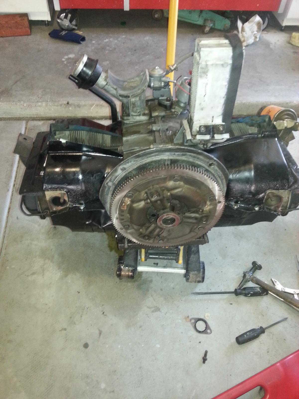

I've included two older pictures of the clutch and pressure plate. I didn't inspect it during disassembly in the past but it looks like the Sachs German 3 arm pressure plate. I have no idea how old or how many miles are on it. This was on the bus when I bought it in 2014.

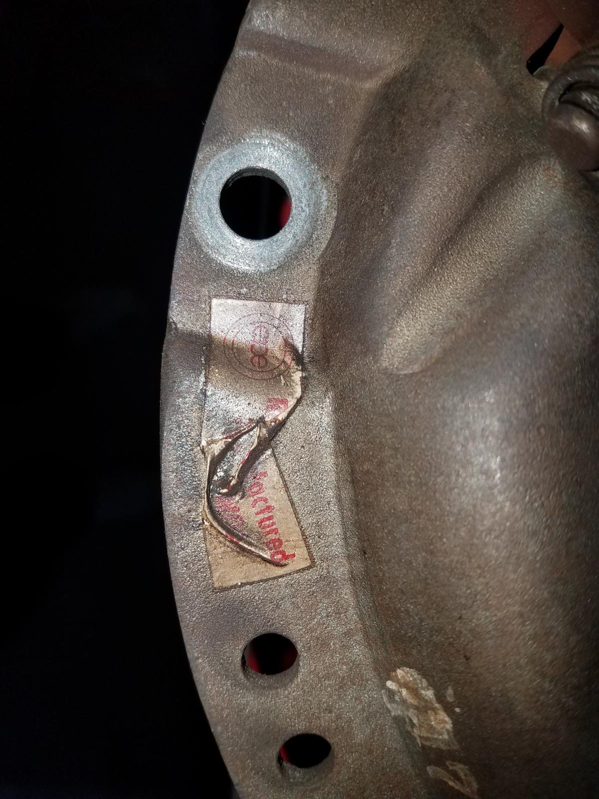

Here's my suspect pressure plate mounted after the engine pull.
It's a reman pressure plate. From what decade who knows? The brand is LUX or LUK? It looks really old and my guess is it's shot and is causing my weak clutch pedal feel and engagement.

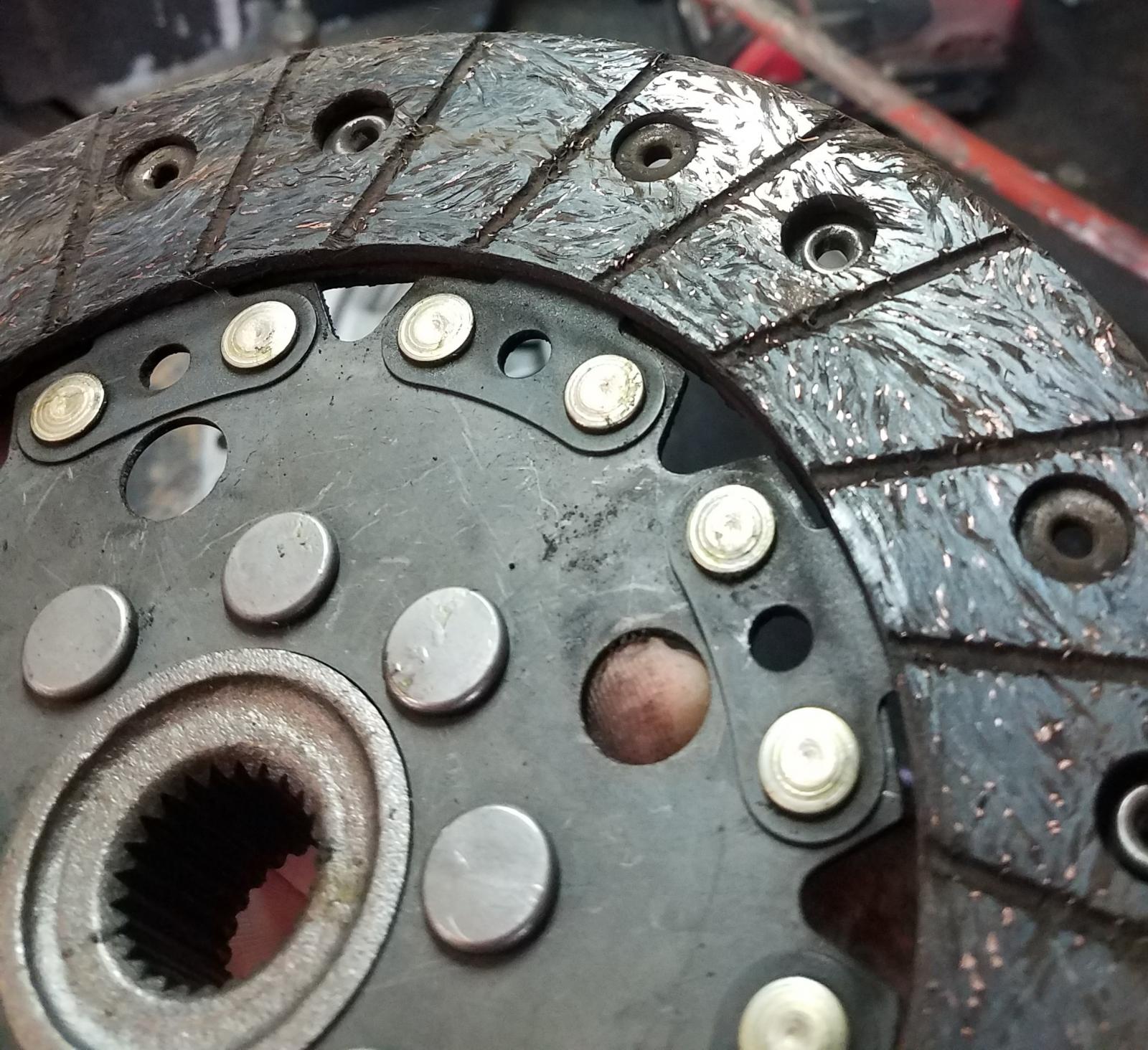

The Sachs rigid clutch disc still looks fairly new. It does look like it was only contacting on the outside of the disc.

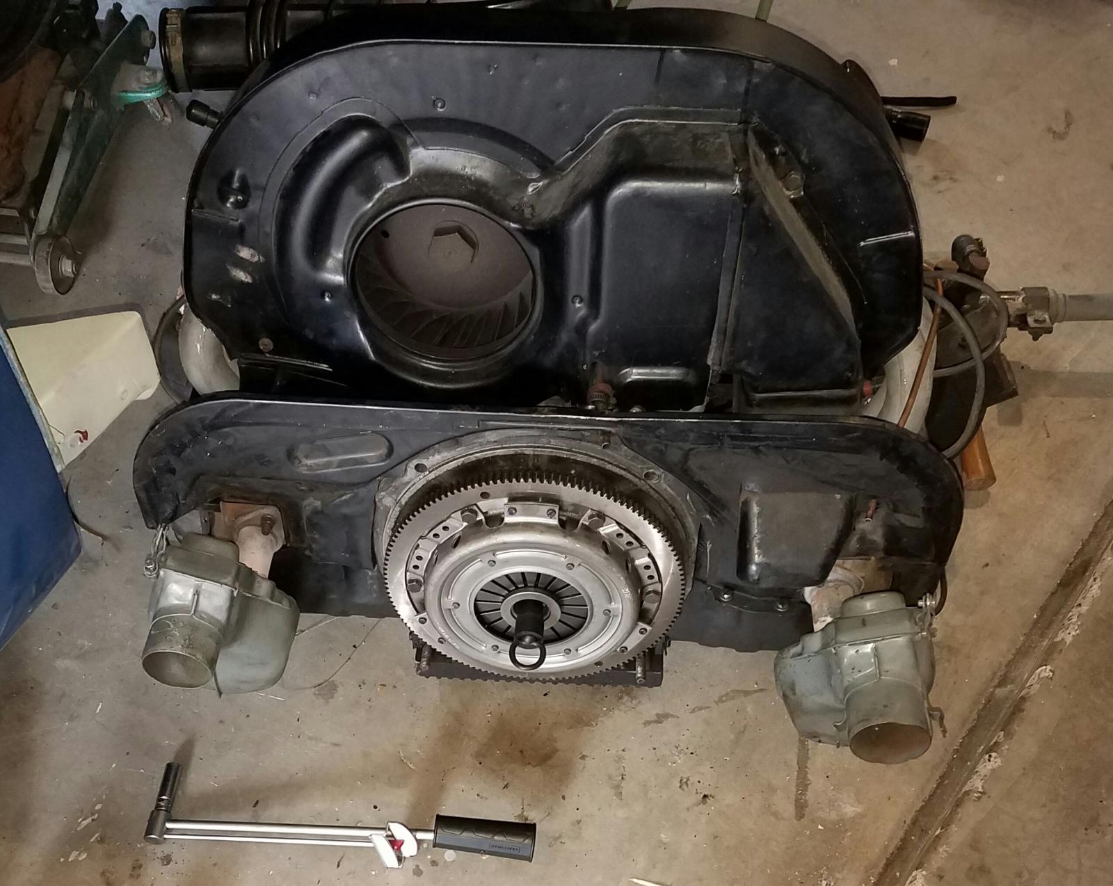

Final recap-
Removed the German clutch cable to inspect it or breaking strands and the clutch hook. Both looked brand new and were only two years old. Pulled the engine and found a reman Luk pressure plate from who know what decade. It looked really old. The clutch disc was a rigid Sachs unit that was barely worn.
I regreased the clutch cable and hook and reinstalled it. I installed a new Sachs spring clutch disc and a new Sachs spung pressure plate along with a new throwout bearing and pilot bearing.
After the engine tormented me for too long to slide back into place, I buttoned it up and drove it. WOW.. night and day difference in how the clutch feels now. It feels amazing. So, clearly that old, remanned pressure plate was going south.
