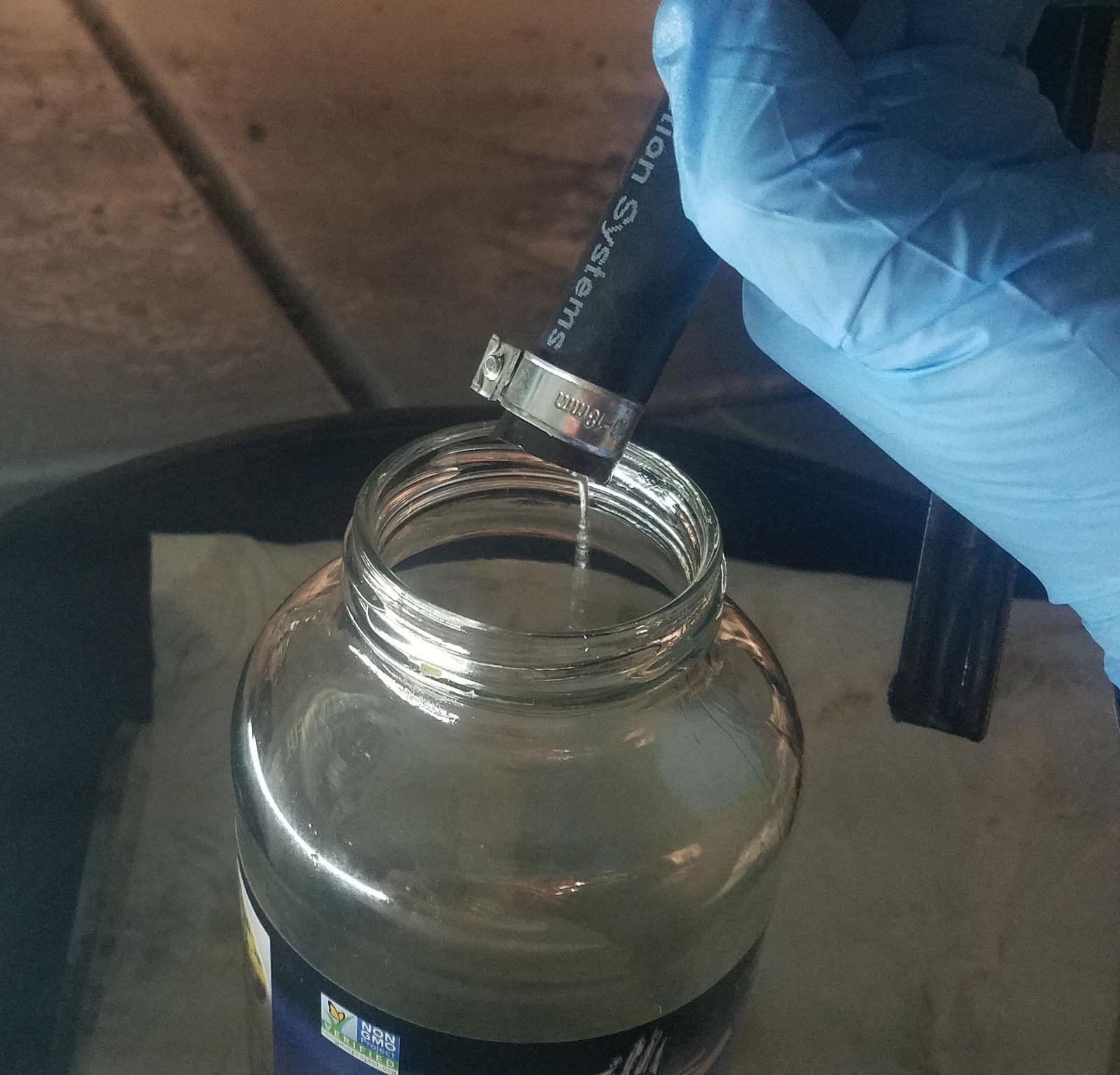

What ibulib, MarkWard and Ron say above is dead-on and I disagree with the previous posters saying noisy pumps are normal and just fine.
My experience is that quality fuel pumps are NOT noisy, a noisy fuel pump indicates a problem, and I wouldn't be comfortable taking any trip with a noisy fuel pump. Yes, you can hear the fuel pump run briefly then shut off when you first turn the key without starting the engine. But I don't hear the fuel pump when the engine is running.
Here's my tale of tracking down and fixing three noisy fuel pumps (all OEM Bosch).
    The next day we were out again when the fuel pump started whining louder than usual and the hesitation became progressively worse. Hummmm, the fuel pump must be dying. It's not that old, but who knows anymore. Good thing I keep a spare fuel pump & filter on the shelf at home for just this scenario....
    I installed the spare fuel pump & filter. But it was just as noisy as the one it replaced. Rats, my spare was bad, too...
    I found a new Bosch 69414 pump online... However, once installed, the new pump was just as noisy as the previous two....
    A quick TheSamba search for "Noisy fuel pump" gave the expected wide spectrum of returns where I read things like "Many new fuel pumps are noisy, just live with it", "these pumps are too powerful and cavitate, use an inline resistor to slow it down", and "water in the tank can result in a noisy fuel pump." The true value to TheSamba search isn't that it will always give the answer, but that it will give one many different solutions and viewpoints to consider. One post stuck in my mind where they said that whenever they replace a customer's fuel pump, they always drain some fuel out of the tank to check for fuel contamination. I had been very careful not to spill any fuel, so I hadn't checked into this in my two recent fuel pump changes.
    That sounds easy to do (even though I hate dealing with open gasoline and the potential for fire after seeing the aftermath of a friend's shop fire). So I carefully opened the fuel line from the tank to collect a sample, but, to my surprise, only a tiny dribble of fuel came out. I removed the gas cap and no change. The tank and all the lines are only 2 years old, it shouldn't be rust clogged. What's going on?
    (see picture below)
The full story on the problem here: https://www.thesamba.com/vw/forum/viewtopic.php?p=9788506#9788506
And fixing it, here: https://www.thesamba.com/vw/forum/viewtopic.php?p=9812154#9812154
Of course, this may not be your problem at all and I am sure some here who can say that they have driven for years with a noisy fuel pump without problem. But, for me, a noisy fuel pump is one of those mechanical red flags that you ignore at your peril, just like hearing a faint engine knock, smelling a whiff of coolant, or seeing a wisp of smoke from too-hot wiring. Once I tried being frugal by buying a non-OEM fuel pump and, while it worked fine on the flats, it couldn't keep up on the hills and left me in a very bad position on a big climb up a mountain pass with no pull-offs. Never again.
Gravity-only flow directly out the fuel tank, upstream of the fuel pump, should NOT look like this. Instead, it should be a full steady flow.
Restricted flow like this will cause your fuel pumps to cavitate noisily
    (see picture below)
I agree with your disagreement Very Happy
it's bullshit to think a noisy pump is "ok"
I wrote up how to fix this and told the poster I'd buy his pump if I was wrong. Never heard back from him
https://www.thesamba.com/vw/forum/viewtopic.php?p=10208532#10208532
