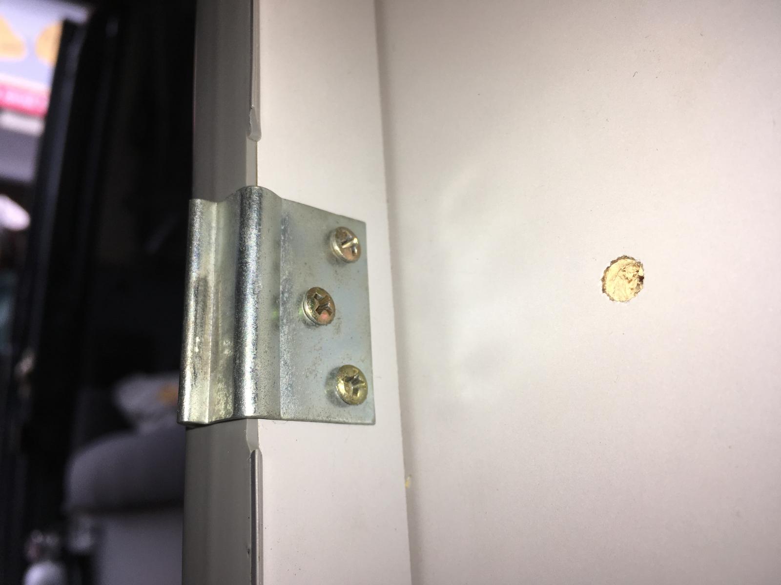

Here are some photos of the OEM catches for reference:
During a trip to a Rockler store today, after scouring their catches, I found this item, linked here: http://www.rockler.com/ball-catch
This is the only catch I've found that has come close. The bend in it is correct, and although quite small, is a very sturdy piece of metal with zero flex. The single screw with dual tang attachment points is a bit lacking to the original 3 screw attachment, but this should be more than sufficient for regular use (sans catastrophic accident), especially if you're using quality 3/4" baltic birch for your face frame.
To keep things safe in the event of an accident, a second ball catch can be installed on the lower end of the cabinet door, so the forces can be distributed to two catches. This will require a little tug to open the cabinet door (to compensate for the actual ball catch, which has quite a stiff spring), instead of an effortless opening, but should give a nice solid feel to the door.
Hopefully this helps others who find themselves in my shoes, cause I sure didn't find **** anywhere online about this!

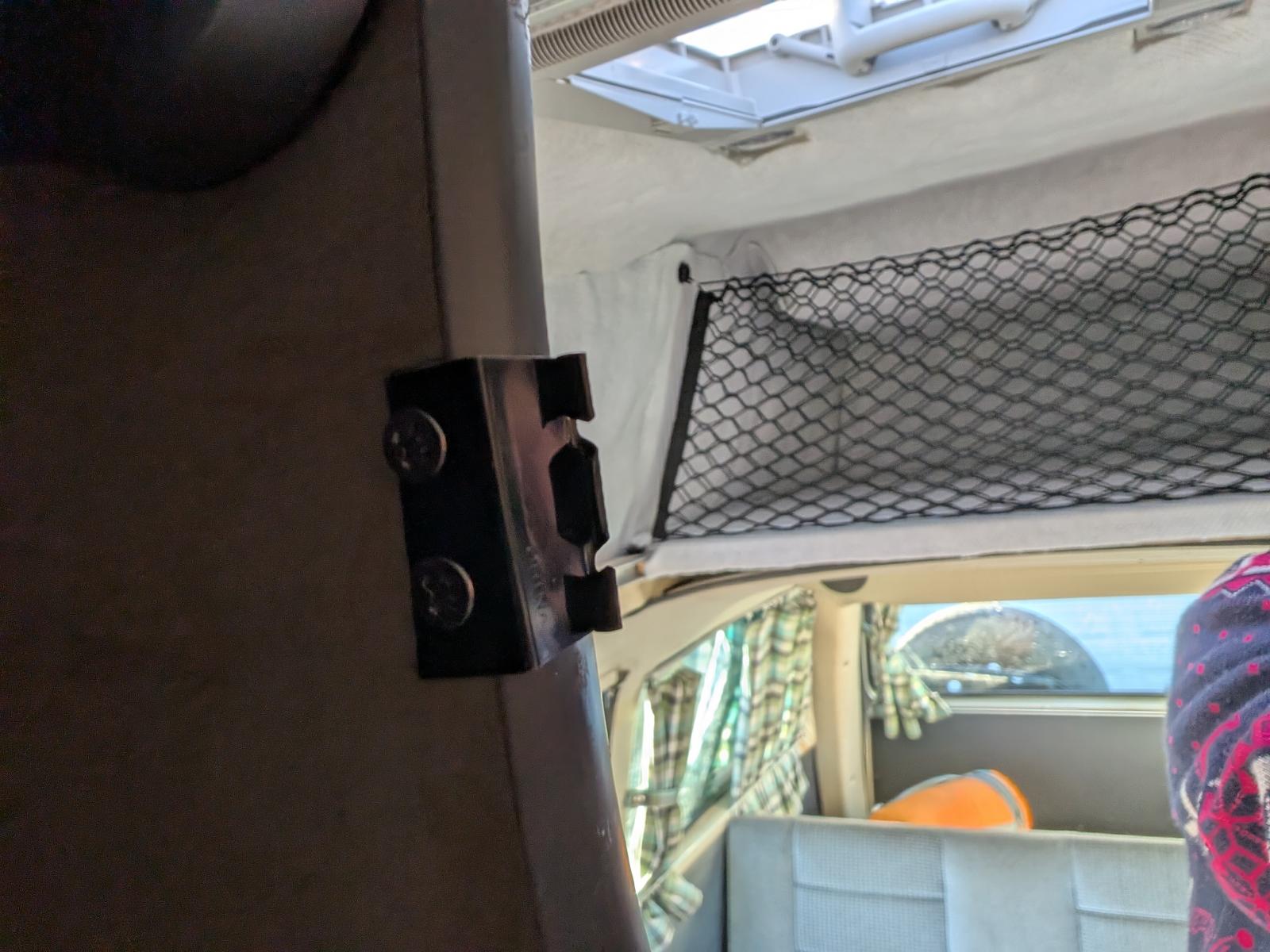

I too liked the idea of maintaining the westy style cabinet door latch throughout the van. I discovered that binder clips actually have the perfect shape for a catch. You'll probably only yield one latch catch per binder clip but it really does seem to work well.

Do you have a picture of the binder clip? I’m having a hard time figuring it out from your description.

PostPosted: Wed Dec 25, 2024 3:20 pm    Post subject: Re: Westfalia Cabinet Catches - Suitable Replacement Found Reply with quote
Yes, here are a couple photos of the binder clip catch and one photo from the outside1

PostPosted: Wed Dec 25, 2024 8:34 pm    Post subject: Re: Westfalia Cabinet Catches - Suitable Replacement Found Reply with quote
Thanks, this makes total sense now. Very inventive!
