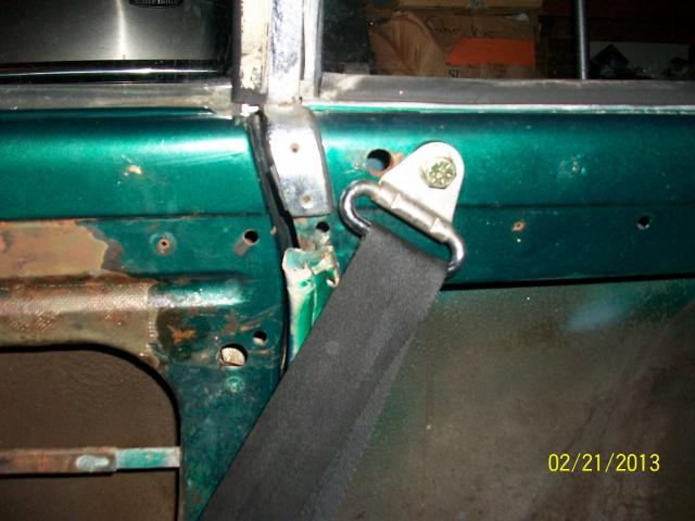

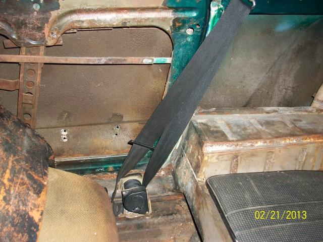

Here are a couple of pictures showing how I installed the belts in my 63 Coupe.
Notice the EXTRA hole next to this belt that the PO drilled.
I did NOT use the holes that the PO drilled I used the 24mm holes that were already in the body. To accommodate the late style hardware that came with my belts I used 6 of these parts;
http://karmannghia.com/viewDetail.asp?idProduct=2345
You also want to get the shoulder bolts to fit them.
I think that your 62 will probably be the same as my 63. I hope that this helps,
