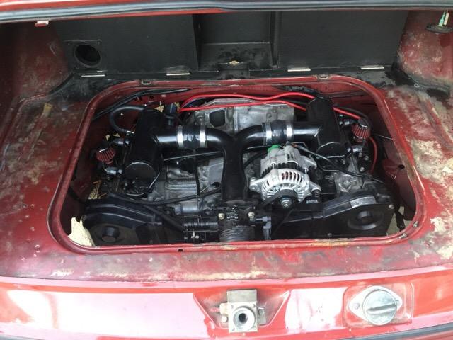

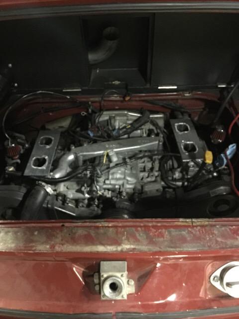

Updates; I have been on a quest to make this swap look as stock as possible. That said, I can't have the intake and alternator sticking up out of the back like this. It's time to make it so the engine lid is back where it belongs. I'll also have a fully operational oil fill/dipstick in the stock location.
Chop, chop

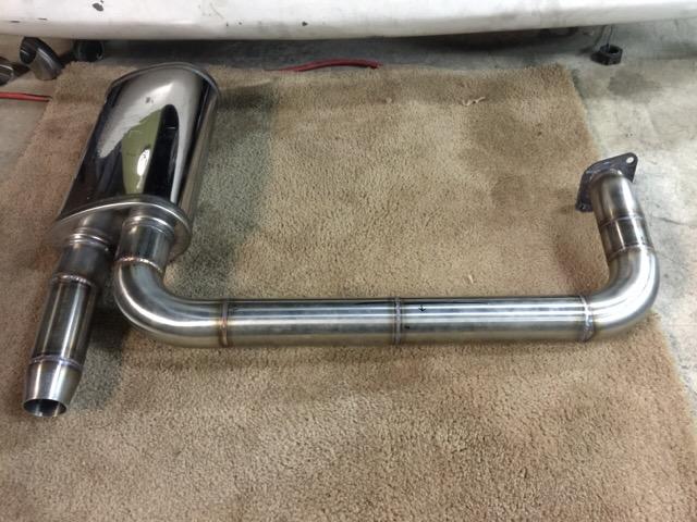

Stainless part of the intake
Old exhaust was in the way, so getting a custom, stainless one

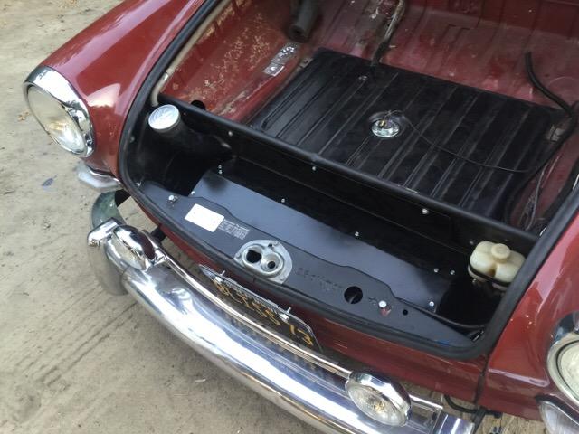

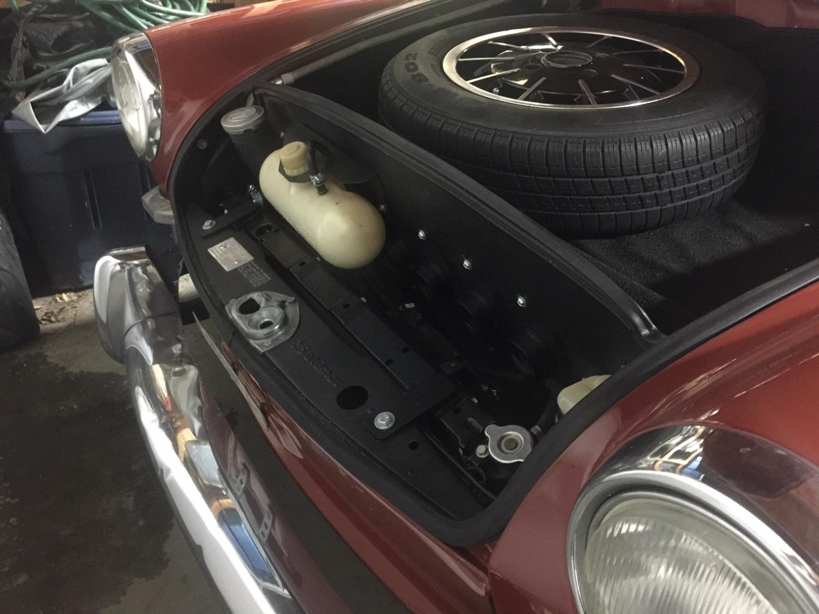

So the fasty is getting closer and closer to being "done". Andy the suby swap guy (littlebuggie) has been cleaning up the install quite a bit. Check it out:
Radiator is completely sealed and hidden now
Intake sucking air from the stock location, with filter box. Also notice the fully functional dipstick/oil fill
And most importantly, the engine fits under the cover now

Now that IS beautiful. It all fitting under the deck is a bonus. Love the "re-use" of the air vents into a fresh air intake. Nice job of repackaging.
Up front being sealed off like, where do you add/top off fluid at? Also, are you going to add a "real" heater? Wink
The fill is under the shroud. It will take loosing a few screws to get to . . .
I don't think I will be adding a heater or ac to this one. I have a subi in my vanagon, and that will get the full climate control treatment
