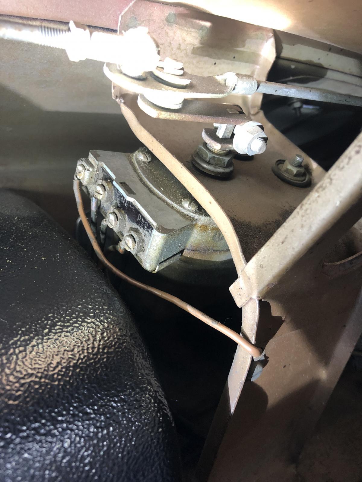

I think because the single speed switches are unavailable you are using a 2 speed switch to run a single speed wiper and that's not a direct substitution. Here's a very thorough article describing the solution you need. In particular it talks about a loop wire between 53 & 53b that gives you two "on" positions instead of off-park / on / dead.
https://web.archive.org/web/20161214025432/http://www.oldvolkshome.com/wiperswitch5866_OVH.pdf
Earthing 31? I think yes.
In this picture from the gallery, it appears already bonded to the wiper case but without the wire earthing / ground is fortuitous and unreliable. The motor is mounted with rubber grommets to isolate vibrations and electrons too.
