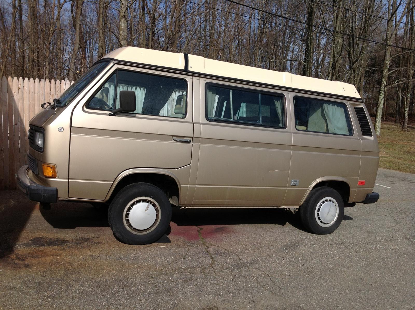

My poptop was painted to match the van with a base/clear coat. I couldn't be happier with the results. It will last for a very long time with little to no maintenance. Here's what it looked like after painting. There's a bit of a glare in the photo but you get the idea.

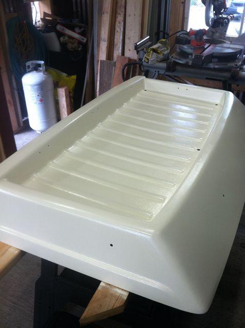

I recently used a Rustleum boat paint on my top. Got it at Home Depot and rolled it on.

This is the Rustoleum product I used -
