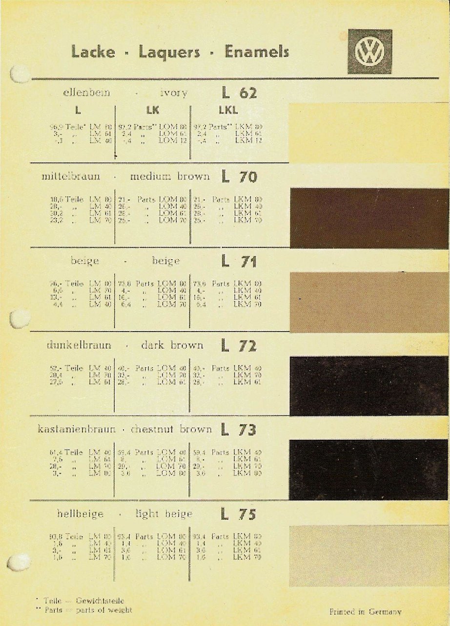

Here is a scan of the original VW color code sheet:
The original resolution is low but IMO it reads:
L70 Medium Brown
18.5 parts LM80
28 parts LM40
30.2 parts LM61
23.2 parts LM70
L73 Chestnut Brown
61.4 parts LM40
7.6 parts LM61
28 parts LM50
3 parts LM80
Hope it is correct! Feedback is welcome Smile
Have a nice day!
DavidJean

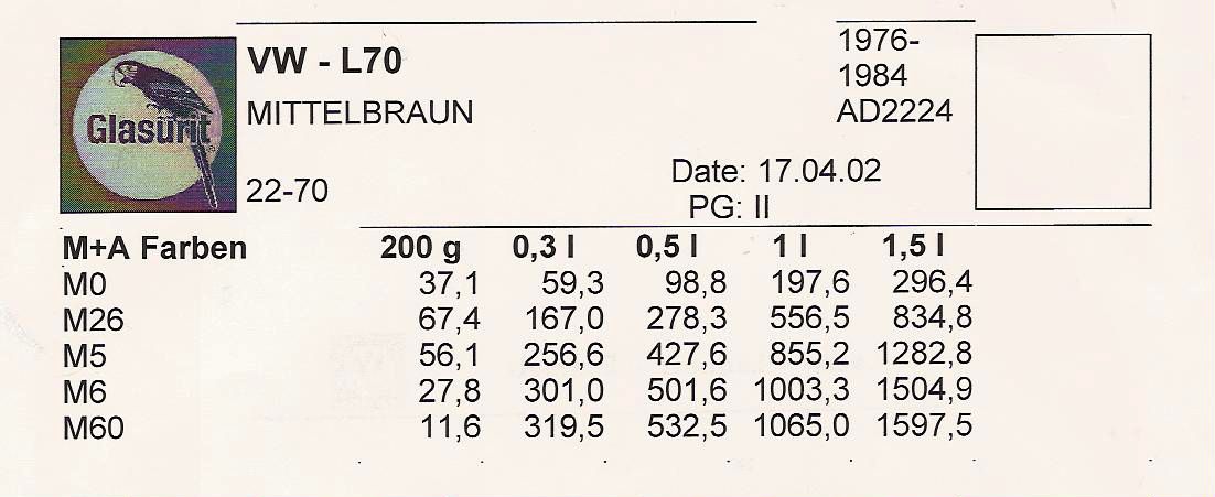

Also found the Glasurit formula for L70 Medium Brown:
Let's try it out Surprised
Cheers,
DavidJean
