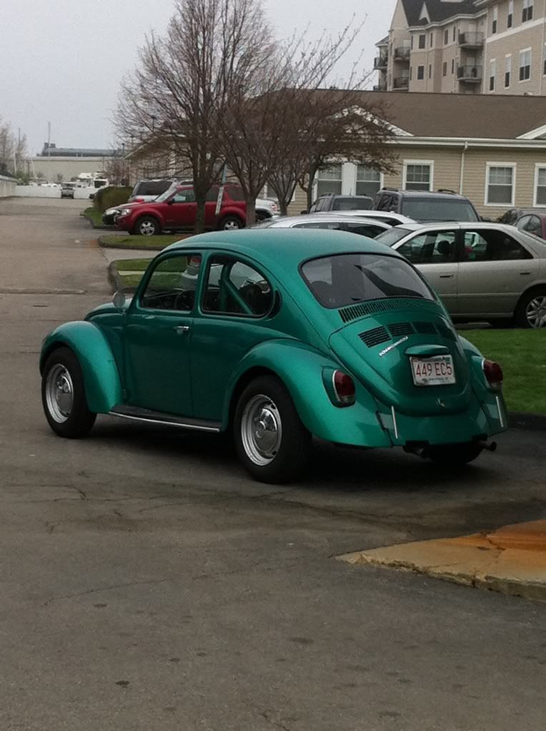

few months back my 72 super has become mine and like others said keep it maintened and carry spare parts, and of course enjoy Smile URL=http://s1122.photobucket.com/user/gp981/media/bebb54e5.jpg.html]
[/URL][/img]
