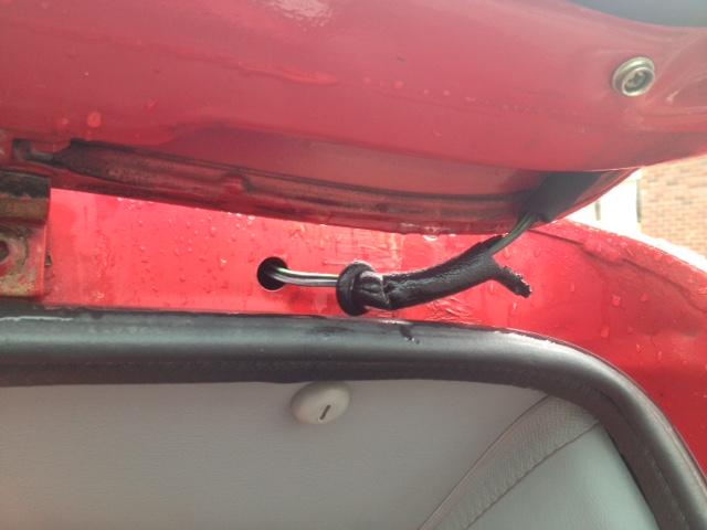

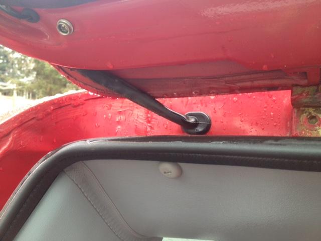

There are quite a few threads on this topic, many of them with proposed solutions. Just adding mine, with part numbers.
So it's basically a variation on what teej posted here.
Parts:
- Two 1/2" OD, 3/8" ID grommets. I used P/N 54-817-0 from Mode Electronics
- About 8" of clear water tube, 3/8" OD, 1/4" ID (similar to the Westy's drinking water tube, but different size)
- 12" of 3/8 PVC tubing (ordered from Cycle Terminal, P/N VW-1 10mm)
Notes:
- the 1/4 water tube is inserted into the black PVC tubing (it's a tight fit, WD-40 is your friend)
- purpose of the water tubing: much thicker that the PVC tube, that barely keep its shape if used without "reinforcement", but still flexible enough
- purpose of the black PVC tubing is treefold:
A) visually nicer than the water tubing
B) tighter fit in the grommets - the water tubing was not very tight
C) also replaces the OEM PVC tube that runs inside the van to the connector behind the overhead AC cabinet. Better protection for the wiring, since it no longer has to "jump" from one protecting tube to another.
One BIG caveat: the water tube's ID is too small to run the rear windshield wiper's fluid tube. I only ran the two wiper wires. I haven't used the rear wiper fluid ever, so not a loss in my case. In fact, it's a gain, since otherwise, you have to disassemble significantly more to reach one of the ends of the fluid tube. Since it was already broken in the grommet in my case, I didn't even have to cut it.
One small caveat: the water tube's ID is only marginally large enough to run the two wires with their connector. The female connector is the toughest to run, but it's also a standard one, so it can be cut and replaced. The male one has a latching pin, so it's not obvious to cut and replace. I "fished" both, using a small nylon wire, passing the female one first, and using a heat gun to make the water tube temporarily softer.
Next thing will be to see how long it stays in one piece...
Before:
After:
