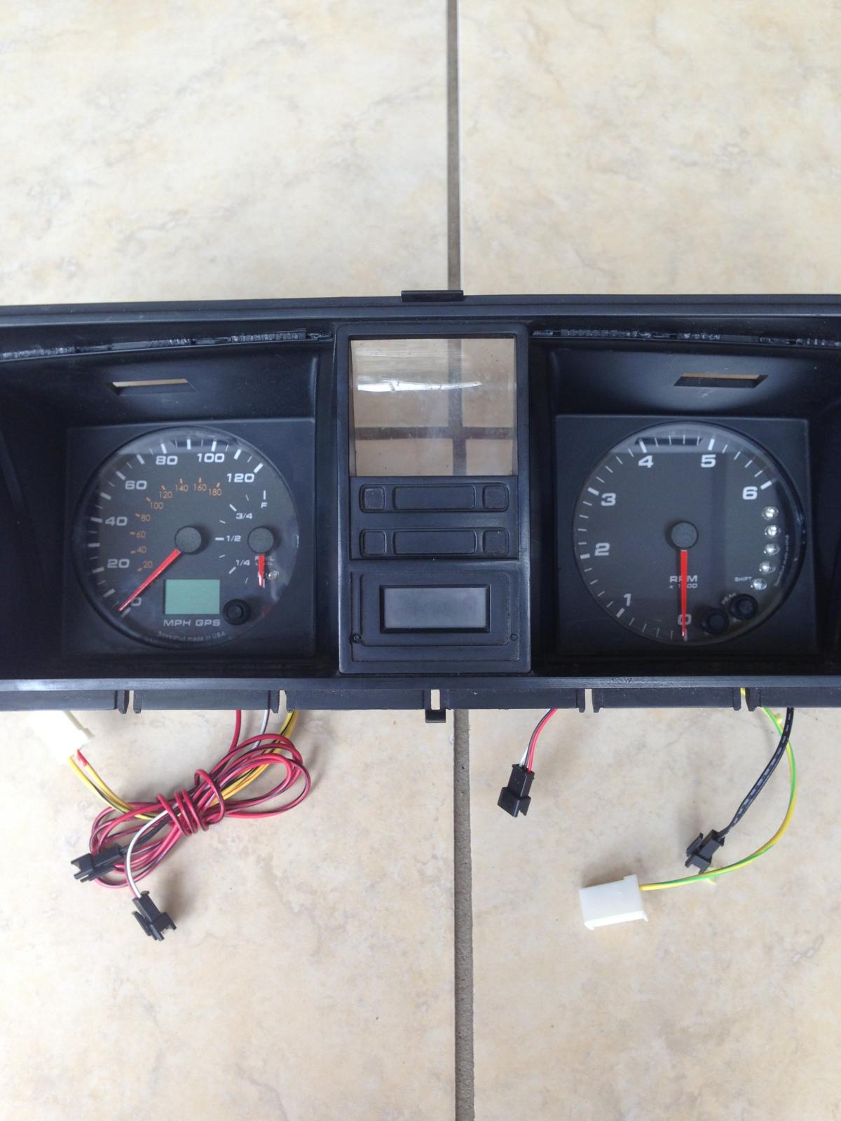

For years now I have been unhappy with the instrument cluster and all its problems due to age. Blinking water lights, fuel gauge never going to full, speedometer always off due to tire size changes. It was one of the most frustrating, costly, and time consuming issues I have had with the vanagon.
Well after countless times replacing sensors and adding speed correction devices (broke after 8 months) I decided to find a permanent fix that was as close to stock looking as possible, yet with lots of modern conveniences and functionality. My Ebay searches ended up here http://www.speedhut.com/gauges/GPS-Speedometers-Dual-4-inch/37:4%7C1:10
Perfect! because GPS eliminates the speedometer cable for a bullet proof system and provides a nifty little trip computer. It also has a fuel gauge build in. Sweet!! The tach is also from them and can be programed to work with the Subaru 2.2 tach sig. It is too good for me to pass up so I pulled the costly trigger.
When I order the gauges I did some modifying. I requested no turn siginals inside the gauge and that saved me some money. I also requested KM on the inside of the gauge because I often travel sown to Mexico for surfing and sometimes wine tasting. Speedhut was every easy going and accommodating to all the requests. Nice people over there.

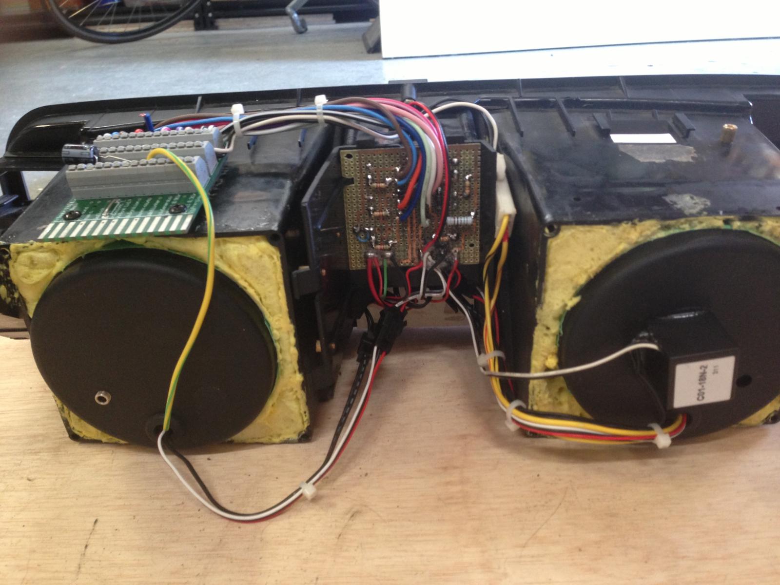

The first thing to do was carefully pop out the glass because it was not needed and in the way. From here it’s all or nothing!!!
The glass is out and the gauges don’t fit perfectly in the case, so a lot of drummeling was done to cut out about a 1/8 of the side walls for each gauge.
Little painters tape to create a barrier between the foam and the gauge. Note: the foam will spread under the front of the gauge, so leave a gap for the foam to expand. Learned this the hard way.
All foamed up. The gauge can be removed if needed, yet it’s really tight.
Coming along
I took some advice from others here on Samba and bought the card adapter for $50ish. It was a life saver. This is my first attempt at a board to replace the blue ribbon. The only thing that worked was the oil light and turn signal... I have never had electronics training, can u tell?

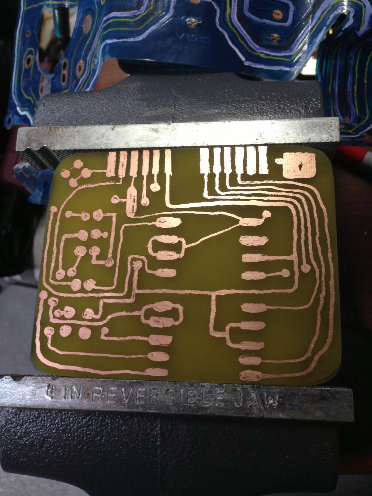

Attempt #2 I went all out. Even created a board and etched it myself! the only problem was now the battery light worked and nothing else.... Grrrr.. I’m about to through this peace of $!@% out the window!!!
That’s when I found out about San Diego Electronics www.sdelectronicssupply.com [email protected] I went in there to get a couple of resistors and the owner (Manny) told me he could work on it if I needed some help, so I jumped at the chance and handed over everything I had. From there he reverse engineered the foil and created a new board. He also replaced some LED'S and adjusted there voltage so the new LEDs weren’t blinding. It took him some time because the guy is crazy busy, but said he enjoyed working on the project. Everything worked great when I got it back.
Night time without the center light fixed yet.
The last thing was to create a new center symbol peace that I did with Corel draw and internet pictures. The final version was printed on transparency paper and glued to the original plastic symbol sheet that was cleaned with a solvent to strip the old printing. I added a water faucet because I’m hoping to have the low coolant level warning light there. Two more 2 1/16 gauges are on the way for coolant temp and battery voltage. The coolent temp gauge has a programble warning light; along with the low water light on the instrument cluster, it should be enough for me to know if there are issues in the cooling system.
The only issue I have with this mod is the fuel gauge moves like crazy when driving. It reads correctly when still or flat, but the new gauges do not like the original VW fuel sending unit and at some point I’m going to have to replace it for a Speed hut sender. Anyone know what the depth of a 2WD fuel cell is and if the bolt pattern Standard 5 bolt SAE pattern?
New toys from the trip computer. My 0-60 is 14.5 secs for a Subaru 2.2
