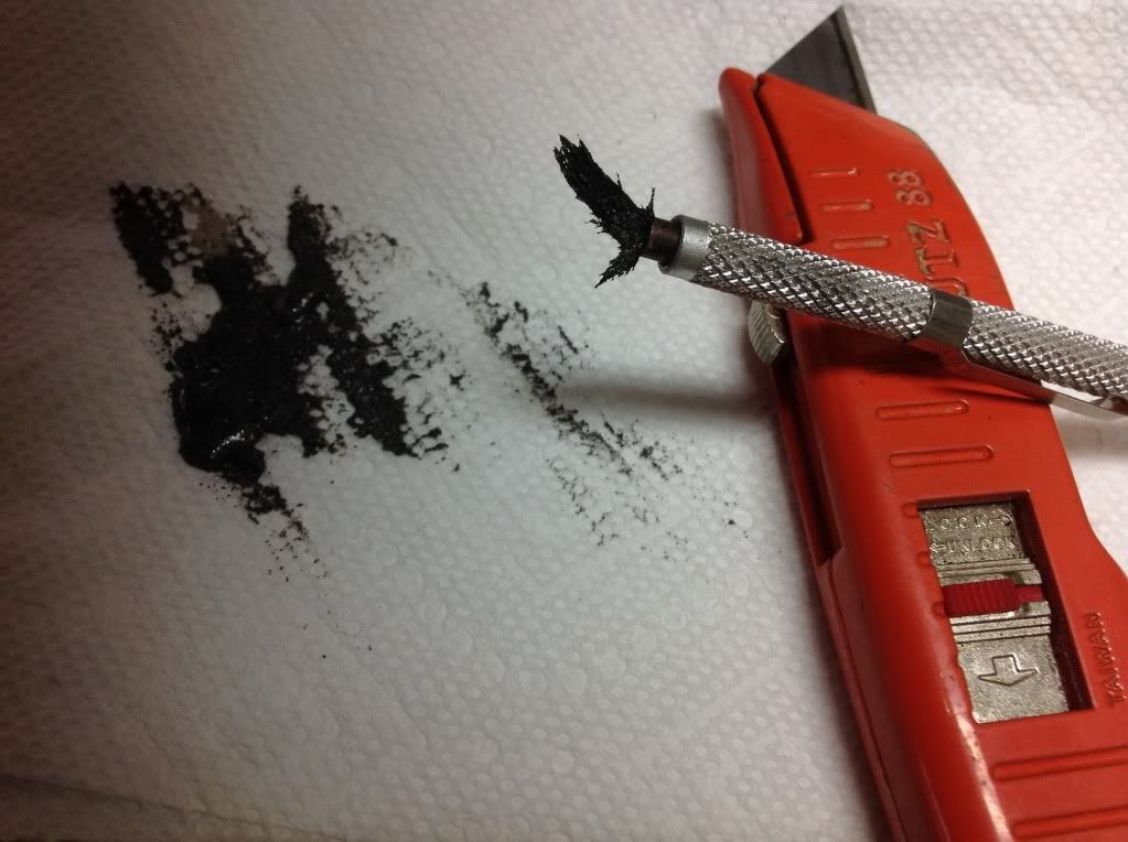

Look! It's magnetic........ It must be pulverized iron or steel in some sort of high temperature adhesive suspension..............
