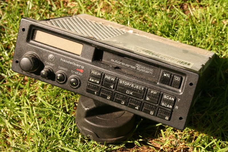

Ahwahnee wrote:
I'm not sure there was ever an official 'stock' unit so perhaps what you have is just an old unit.
There was. From 1985 onward, they were Heidelberg units (for the USA), similar to this:
The brochures show cassette radios as an option for the vans (weird 'cuz the Cabriolets came standard with them).
1983: http://www.thesamba.com/vw/archives/lit/1983_00_vanagon_and_vanagon_camper/Seite14.jpg
1984: http://www.thesamba.com/vw/archives/lit/1984_00_vanagon_02/Seite16.jpg

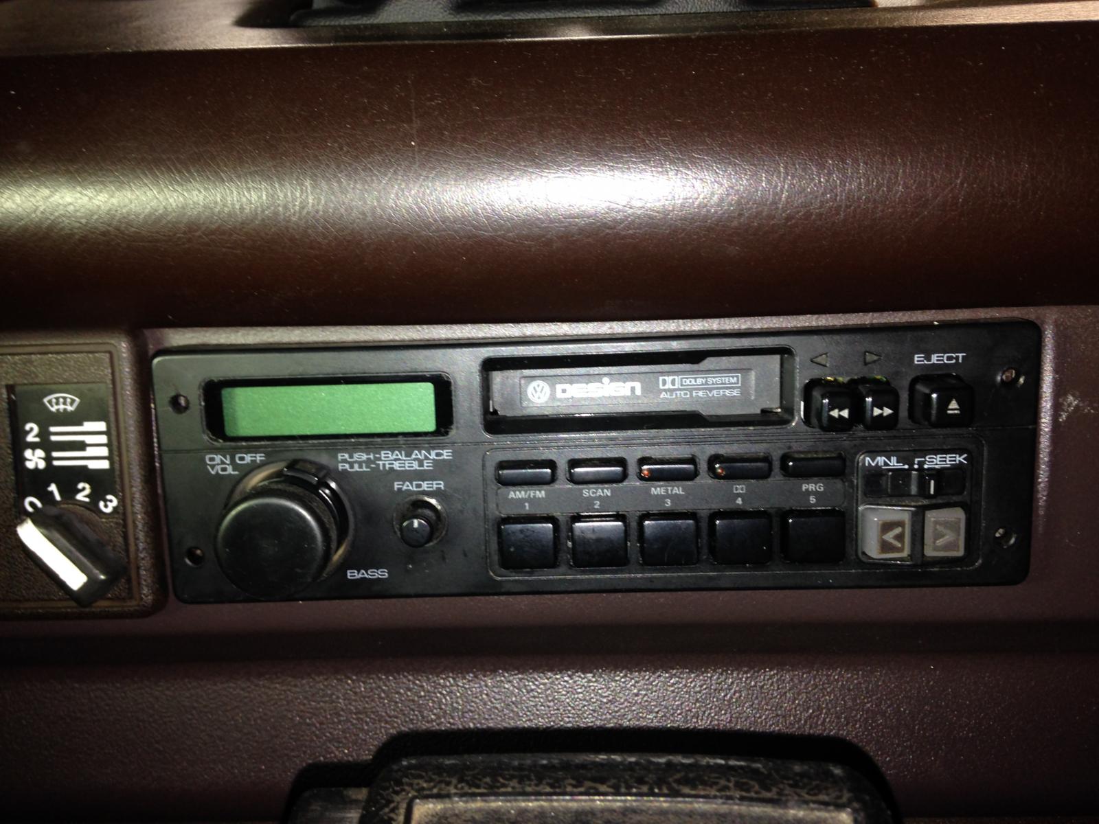

Having just bought some busses with original stereos, something i've never dealt with up until now....
MAN ARE THEY WEIRD!
First, VW wired it so that you can leave the stereo on and kill your battery without the car running. REALLY!?
Also, it doesn't illuminate unless the headlights are on! REALLY!?!?
Then lets talk about the knob.
I love a stereo with a knob, infact I won't own one with volume buttons....I HATE them. But this knob..... this knob is something else.
I'm not positive that you can't control the horsepower, shift points of the automatic transmission, and brake bias from this knob.
Push it in, it controls balance. Turn it normal it controls volume. Pull it out it controls fade. Push it in slightly and down while turning it clockwise and WEIRD things happen.
So far I guess i've been blessed with busses that had aftermarket stereos already in them. I can't wait to rip this creapy thing out and stick in a modern, simple, and highly affordable pioneer unit (gota make all the busses match so I know how these things actually work) that can play all the music in the world off a $10 flash drive and charge my phone.
