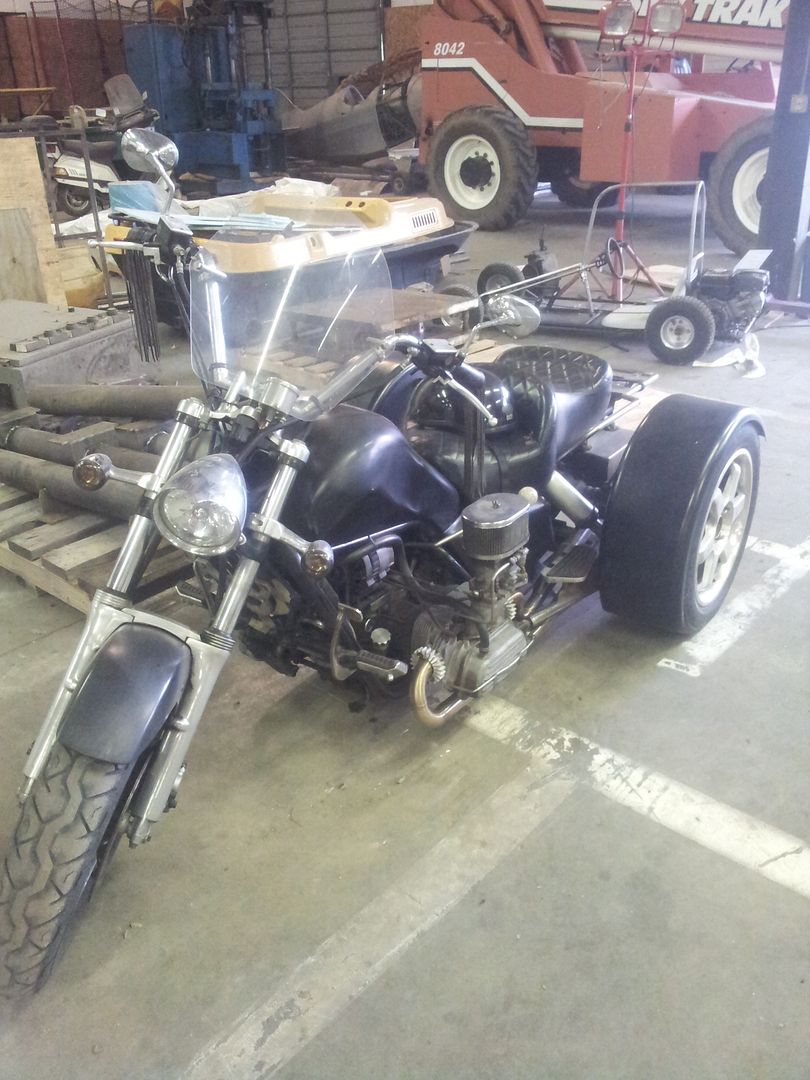

Here is an old pic so you can see the area I have to work with.
The straights have serves me well for the past couple decades.
But I am looking for a better tuned exhaust to go with my mega squirt fuel injection I am setting up now.
I like!!! Cool
That thing looks cool.....
I run MS-2 on my buggy. You will love it.
Will you be doing ITB's again or a single TB???

Independent throttle bodies.
43mm Mikuni
320 cc injectors
the rubber hoses on the far side you can barely see
Are the original map sensor and idle air connection points.

looks great,paring #1&3 and 4&2 may of worked a little better....but ...that all depends on oh soomany things,like driving style,engine size,rpm range,camshaft etc. very nice work. Ive been thinken on a over the top of the tranie exhaust like the mid mounted buggys use,and doubble walling the exhaust after the merge for heat to the car.....well in my head anyway. as for the scooter I would pair 1&3 THEN 2&4 into that. with free flowing muff. or 1&3 with muff&2&4 with muff onthe other side.or duel it.

Yeah that is what I am thinking.
1 and 3 out one side
2 and 4 out the other
Prob never have a muffler on it.
Been running it since 81 without a muffler. ..lol

The 2110 I always estimated at 160hp. That may be a little generous with the open primaries I have always had.
It handily performs with a 100 hp crotch rocket that weighs almost 200 lbs less.
It is going back a 2286. 86 x thick92.
I had been fishing for cam suggestions. About decided on a fk10.
With the lack of a true header I am thinking I can not handle a duration over 270.
