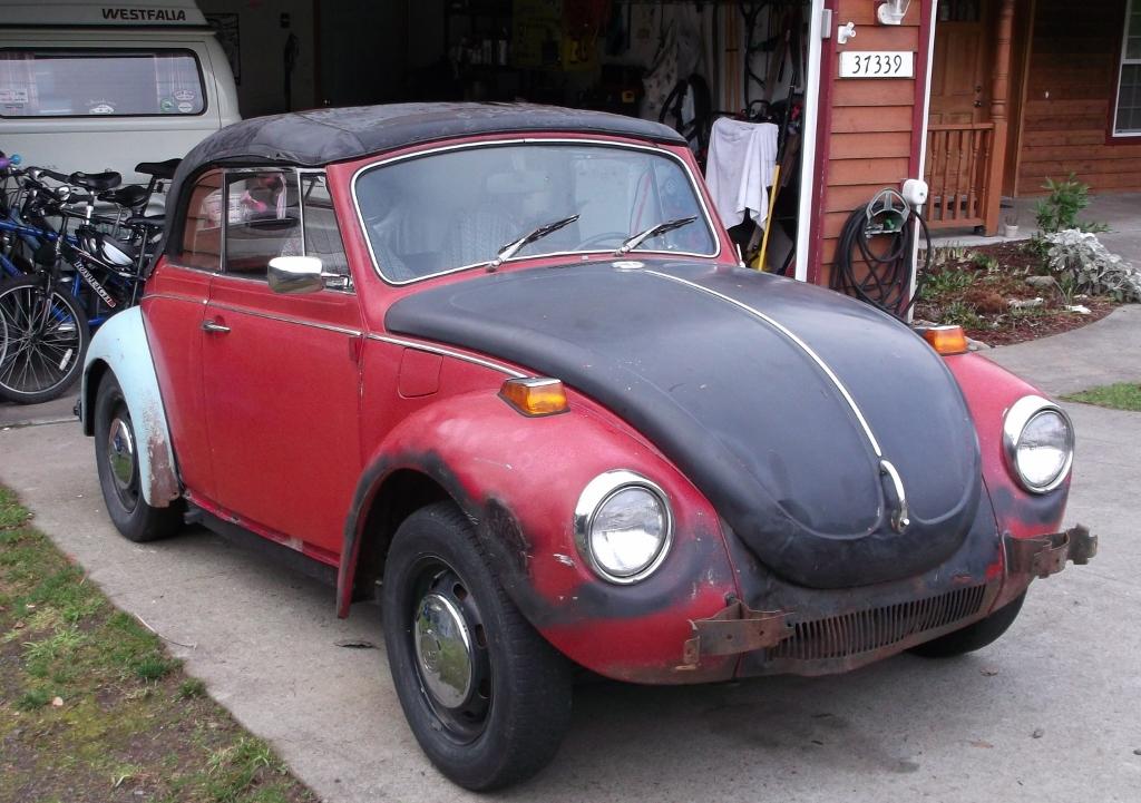

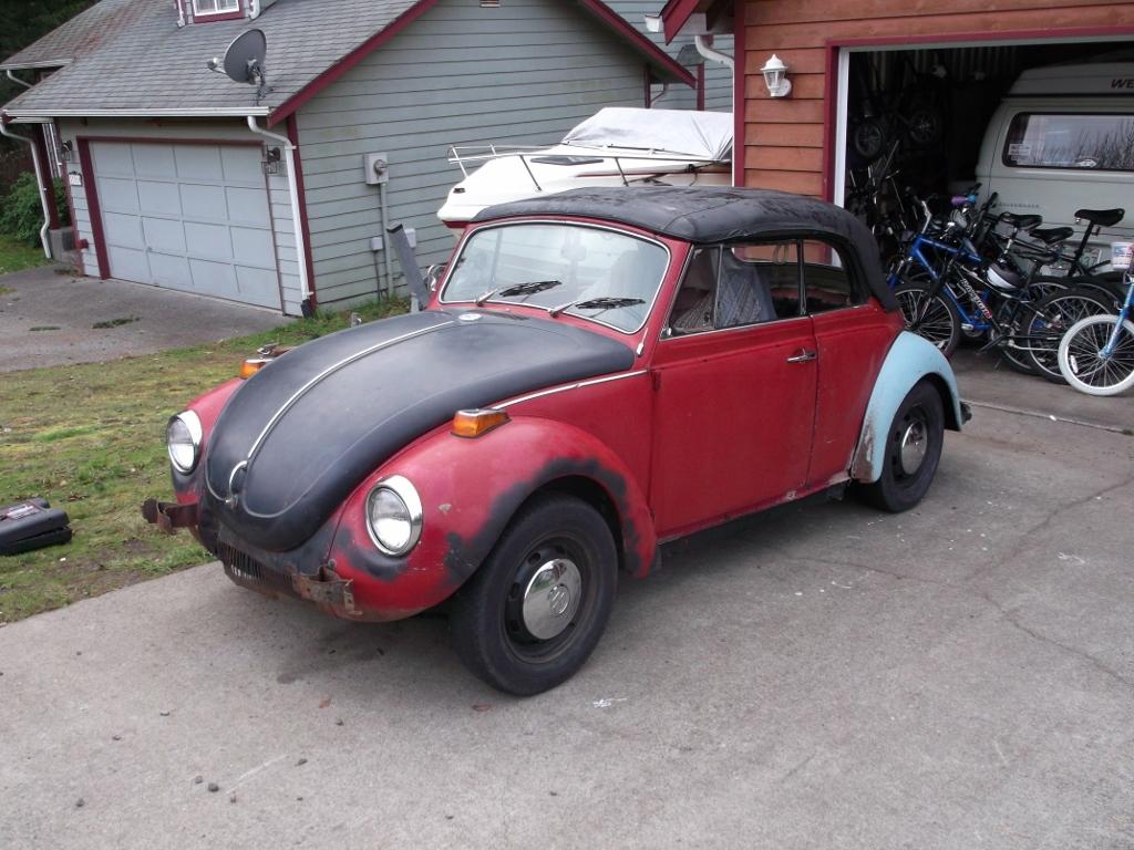

I've decided to start a post to document my progress on my recently acquired '71 super beetle convertible. This project must be done in a very short amount of time because the money I make from it when I sell it will be going towards sending my wife and daughter on a mission trip for our church. The idea was that we needed to raise some money and I could think of a better way than to find a solid project car, fix it up and sell it. I found this on craigslist and got a really good deal on it. The lady I got it from was recently divorced and her ex-husband told her to just get rid of it. The good news is that mechanically the car is very sound. I drove it home on the freeway and it was able to do 65 without any issues. All of the electrical works and the brakes are new. The body is fairly solid but has some definite rust issues. It will also need a new interior and a new top. Enough rambling, here are the pictures.

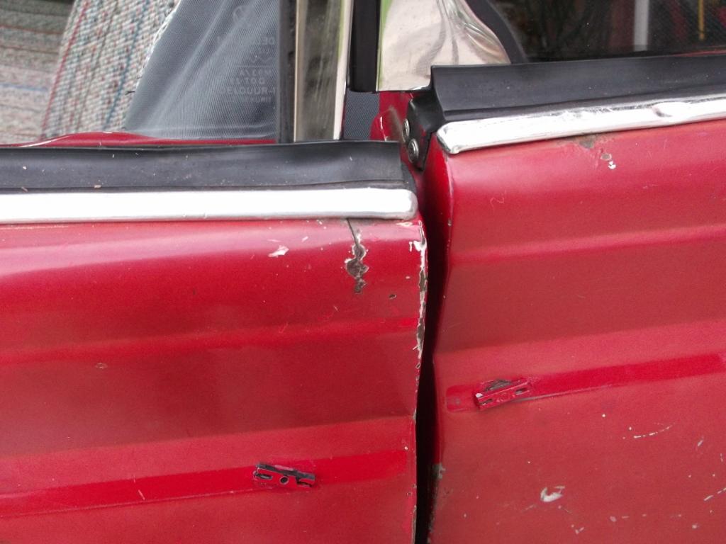

And now onto the issues. It has the typical convertible door gap problems and there are cracks in the doors too. It was hit pretty good in the front and so that will all need to be fixed. It also has rust in the front wheel wells and as you can see the PO did an awesome fix on the battery tray area of the pan but a new pan half was included with the sale. I've already began sourcing parts and got a new bumper, antenna, trim pieces and little stuff like that from the local junkyard. Here is some of what I'm talking about.

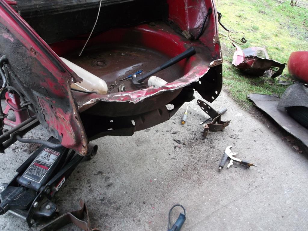

Not one to mess around, I started tearing into it today. First up was to get that banged up front apron off. For those of you that haven't done this before it is actually not that hard. First the fenders have to come off to get to the spot welds that hold the apron on. Once the front fenders are off it's just a matter of finding the spot welds and drill them out. I highly recommend buying a spot weld drill bit for this because it makes real quick work of those spot welds. The hardest part was separating the apron from the front of the car in the trunk area. It is held on by spot welds but good luck finding them since they are buried under a ton of factory seam sealer. I ended up using my angle grinder to cut it off since the apron was junk anyway, it's not like I needed to be gentle! Laughing
On with the pictures;
Thoughts, comments or suggestions are always welcome. Stay tuned as I continue to tackle this project....

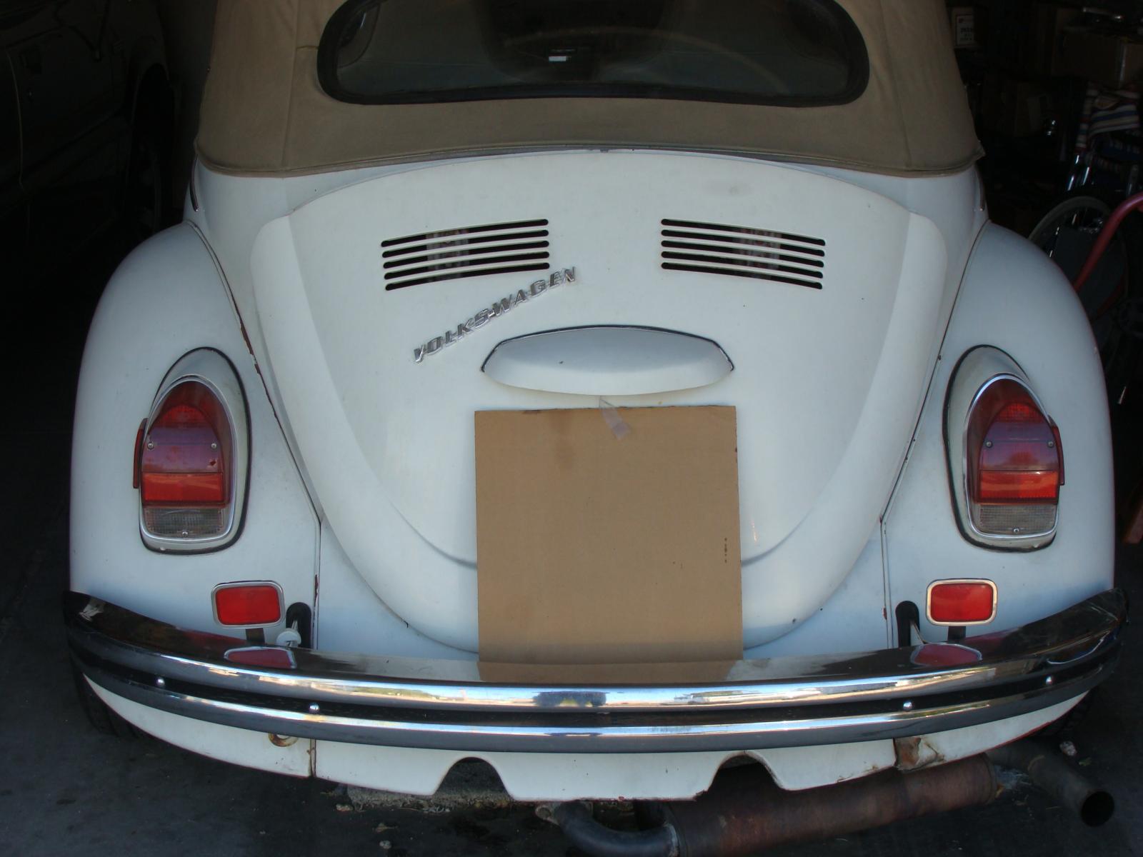

That's the wrong deck lid for a 71, it should have 4 sets of slats in it. Good luck on the project, mine isn't quite that rusty.....but its rusty.

Good eye, I didn't realize that was the wrong decklid. It will probably stay though since it is rust free and it fits!
If it has the DP motor it will run hot, cant get enough air through that lid.
I run that type of engine lid on my 1835cc DP engine in Arizona (30 years now) but I have decklid stand-offs and an exteral oil cooler (mine's non-doghouse).

DP is dual port, which was stock on 1971 and later USA engines.
But over the years, anything can happen on these VWs. Look at the intake manifold: if one piece, then it's single port. If it has center section with separate end castings (which "split" into individual runners to the two ports on that side), then it's dual port. Some call it twin port.

Also, I'd like to know more about overheating with the '71 hood. What are your plans as to your build, e.g. stocker, custom, etc.? Best of luck on your project!
I have also had a '67 convertible with even smaller vents on the decklid and it had a 1776cc and it didn't overheat. I have heard that running any convertible with the top down at prolonged highway speeds can make them run hot because with the top down it will make the air go right over the decklid.
My plans are to bring it back to stock with the exception of empi 8 spokes. I need all the luck I can get, it seems like to more I work on it the more stuff I find that needs to be fixed.

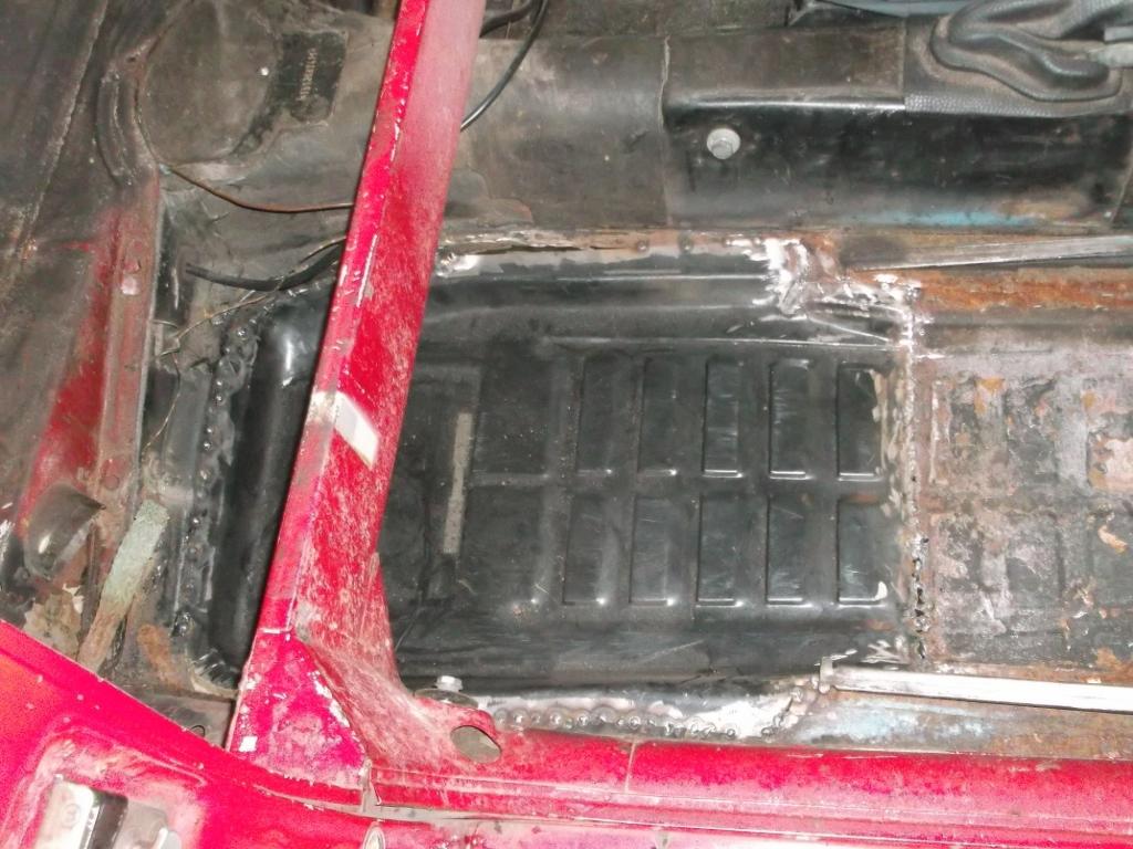

The new section all welded in,

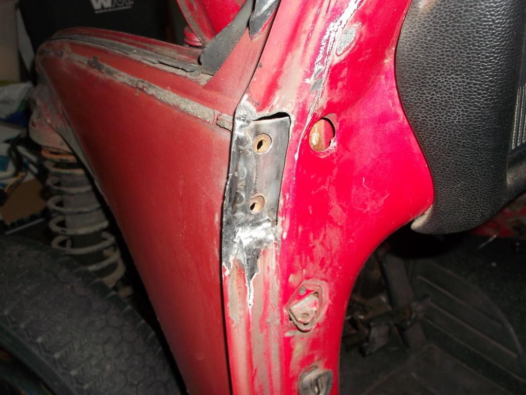

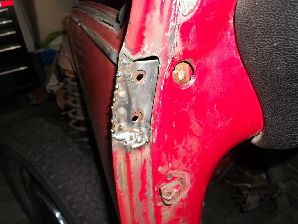

I had the typical door sagging problem but on this car it wasn't the hinges that were loose it was the hinge mount was broken and in pieces,
I cleaned up the area and made a patch for the area,

Once I got the metal formed I drilled the holes for the mounting screws,
I drilled holes in the patch to spot weld it on and then welded the edges also,
All cleaned up and ground smooth. I test fit the door and it doesn't sag and closes really smoothly now.

It's only an issue with convertibles because they lack the vents under the window like sedans have.
It may not overheat but it will dramatically shorten engine life, but if your building it just to sell off then its probably not of concern to you.

I do have to make another trip to my local junkyard to get a rear quarter panel off of a 71 or 72 Super that is there. I seem to remember this car having a pretty clean decklid laying inside of it. Maybe I'll get lucky and it will have 4 vents, if it does I will snag it for this car.
About the repair to the door hinge area, if anyone is going to try this I have dome helpful hints. It may be hard to see but one has to jog the metal patch when installing it because it is not a perfectly flat area. From inside to outside it jogs down to meet the outside area of the car, if that makes sense. The other thing to keep in mind is where this hinge area meets the windshield pillar the Karmann factory used liberal amounts of lead there to fill that gap. Why is this a big deal? Well, when one is looking for solid metal to weld to, you don't want to try to weld to lead, it just melts. So I ended up grinding back quite a bit of lead until I saw sparks and then I knew I was back to steel. But the lead in that area was literally 1/8" thick in some spots. This is best illustrated in this picture. Notice where the windshield pillar ends it looks jagged? That's all lead. You can also see what I mean about this area not being perfectly flat. Where the hinges screw in to where it meets the outside vertical running seam is about a 1/4" difference.
