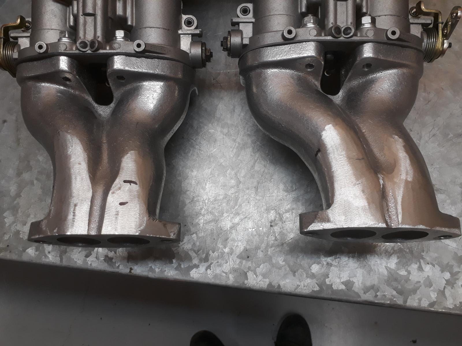

Did some looking around and did not find anything about this

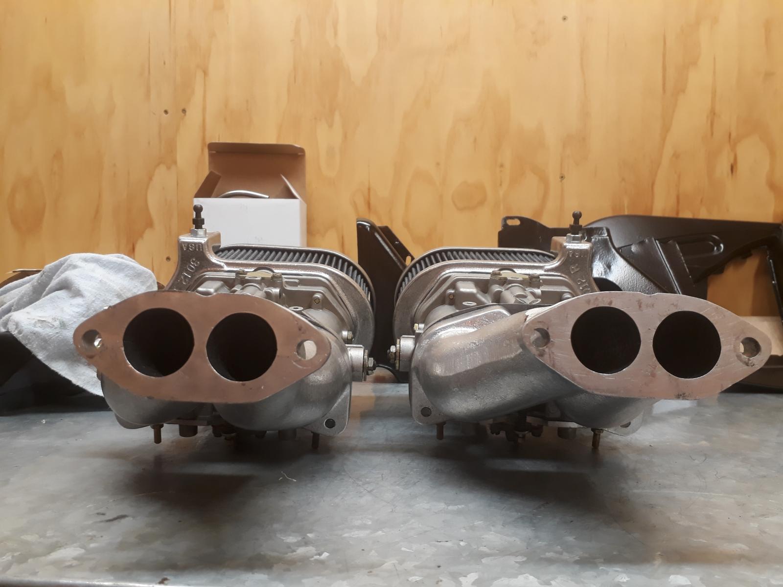

These intakes are from CB and for the IDF 40s I'm going to mount.

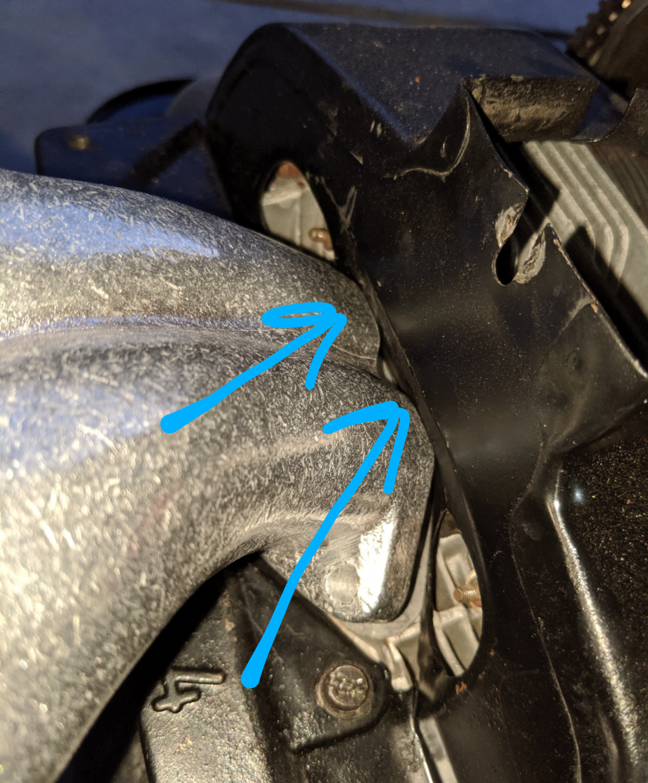

They are too wide to fit due to the tin. There is no room for me to bend the tin out of the way, so curious of you would grind the intake (it's pretty thick right in that spot) so that it fits.

I cut the tin at the spark plug hole at the thinnest point at the bottom by the intake gasket, then bend them in behind the manifold. It just takes a tin snip not metal removal.

If you have good German tin, grind the manifolds.

I had the same issure with my cb manifolds, and german tin1 There is plently of meat there.Used a flappy disk and gave them a trim up,

Nice!
Yeah, good German tin so going to do the manifold trim.
Thank you for your time and the great info!

Make sure to clearance the manifold flanges to clear the hold down nuts. I found that the nuts would fit on the head studs. But without a washer.
Also you want to be able to get a socket on the intake manifold nuts. So you may have to clearance the manifold above the head to intake flange as well.
These dual carbs can be a bitch to install with the engine in the vehicle. It's a good idea to have a 1/4" drive ratchet and extensions. Sockets too, to slip between the forward manifold hold down nuts and the forward tin.

PostPosted: Wed Aug 14, 2019 9:10 pm    Post subject: Re: New Intakes Too Large and Rub on Tin Question Reply with quote
In progress. Going good so far.

Make sure the manifolds slip on with both the cylinder tins and fan shroud bolted together. Sometimes the shroud will push the tins outward and this will cause more interference.

Manifolds are on and fit great with the fan shroud on.
