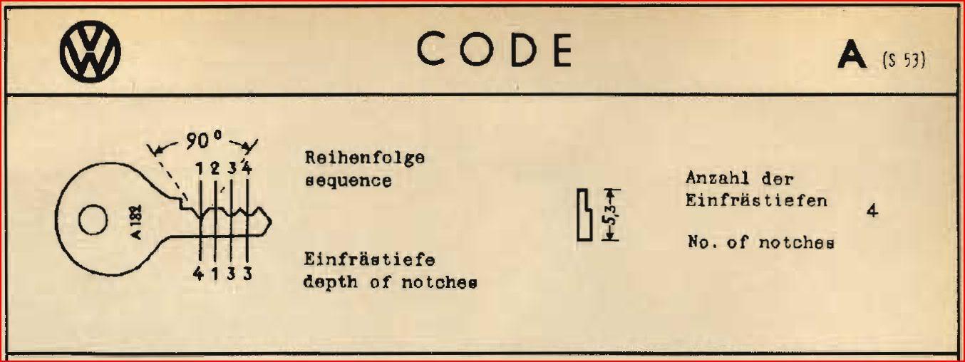

I'd like to try to cut keys for my ignition, but I'm missing a few critical pieces of information, maybe someone can help fill in the blanks? I have a P code ignition, which is supposed to use a 90º angle at the notch like the A code. I have the code for the 4 tumblers, 1-2-3-4. What I don't have is how the number corresponds to the depth of the cut. Is a "2" in the code a 2mm deep cut? Is it 2mm from one of the grooves on the key?
Any help is much appreciated, I'm trying to find something I can do in the house while it's 10º out in the barn.

Here is the spacing from the shoulder and depth info for P key.
Excellent information. Thank you! Where is this from?

This info isn't in the VW locksmithing books or the old Reed code books.
I have access to locksmith information - looks like your depth code 1 2 3 4 starting from the shoulder of the key corresponds to key code P172
I just typed the info into an excel spreadsheet....
Good luck!
Good luck!
Thank you so much for sharing. 1-2-3-4 was just an example. But now that I know what the depth of the cuts are, and distances from the shoulder I should be able to decipher the codes I have. The lock I'm working on is probably P59, but may be P69. Wish me luck!
