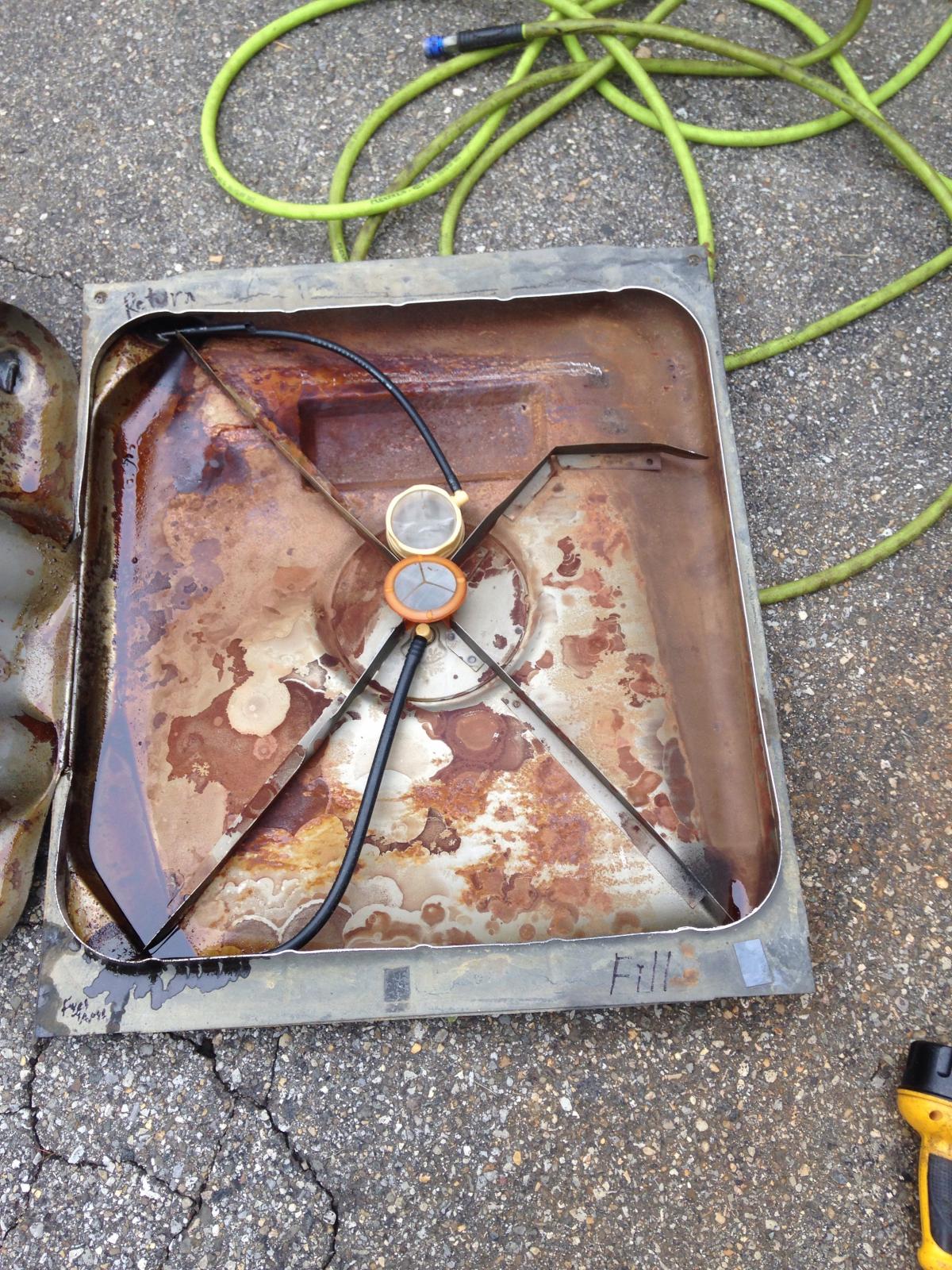

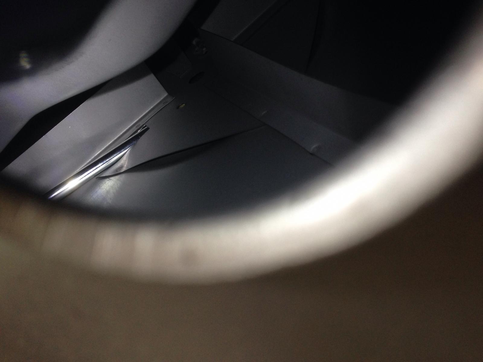

I just thought some might like to see the "mysteries" of the Vanagon Fuel tank.

tpinthepack
Joined: July 11, 2004
Posts: 847
Location: clearwater,florida
tpinthepack is offline
PostPosted: Sat Jun 20, 2015 1:17 pm    Post subject: Reply with quote
Does not look as bad as I would expect. Do you feel the same or no? Thanks for sharing.

PostPosted: Sat Jun 20, 2015 1:37 pm    Post subject: Reply with quote
shows why coating is a bad idea
- what is the function of the slot?

PostPosted: Sat Jun 20, 2015 1:51 pm    Post subject: Reply with quote

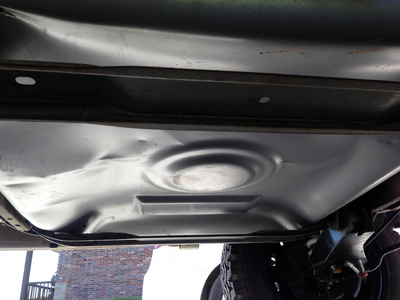

If you look at the bottom of your tank you will see a protruding circle in the center.
That circle is where the fuel is both sucked out of the tank and returned to the tank.
When your fuel level is low. It no longer floods the intake screen. It still gets sucked in the edges of the screen but also seeps under the plate into the intake well.

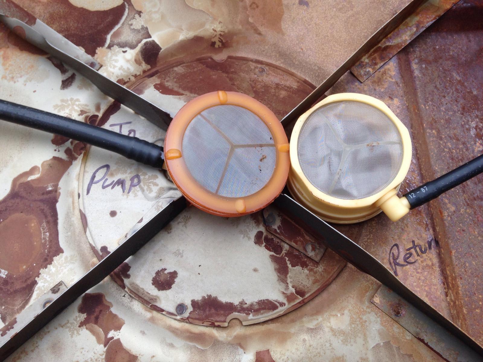

I cut away the cover of this circle inside the tank, where the two plastic filter screens are fastened.
The cover is spot welded in four spots, in between the spot welds are the slots that let fuel drain into the pump pickup area.
Bottom of my new Tank.....

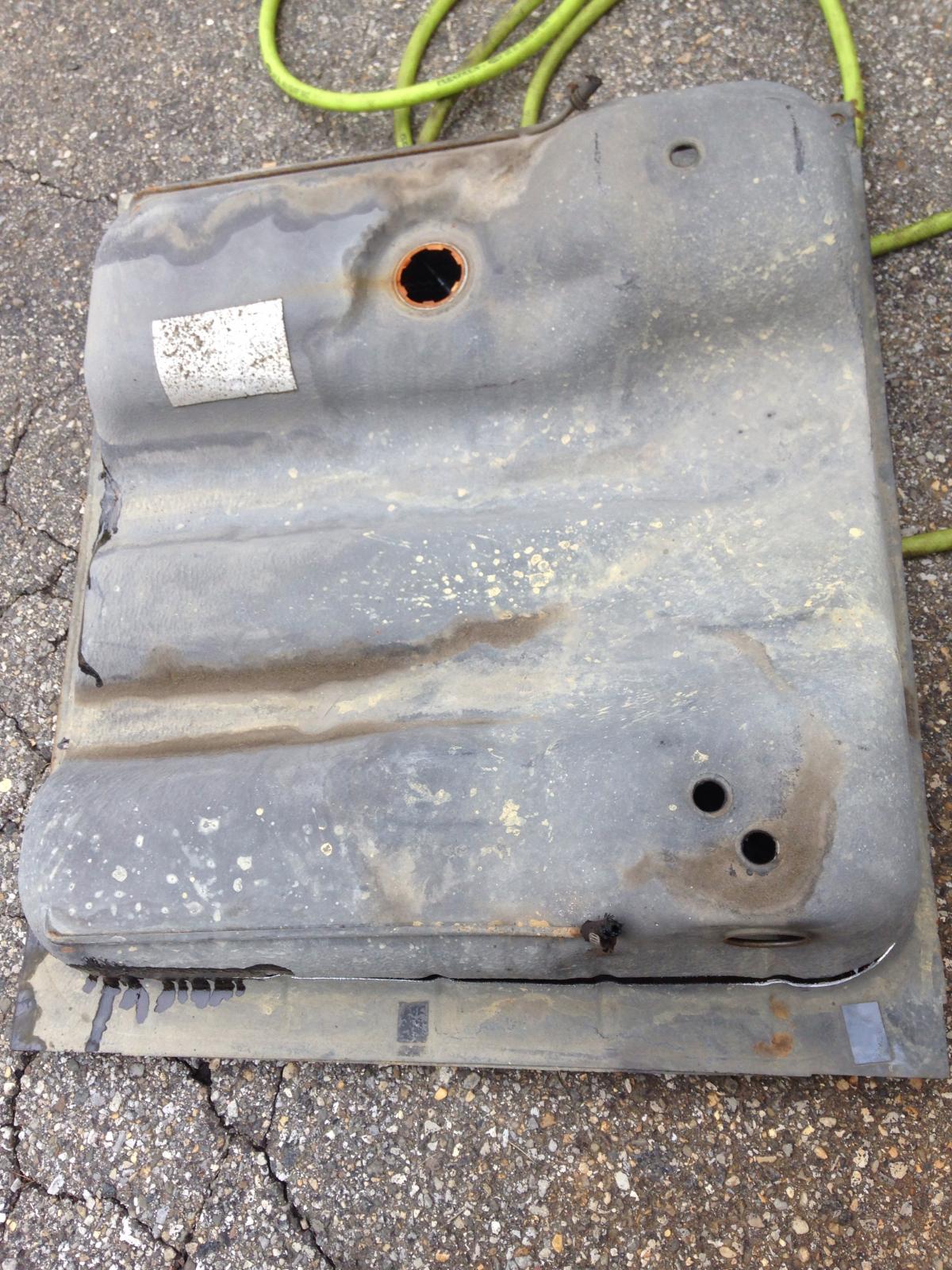

Inside of my new tank. Much simpler, notice that there are no filter screens.
The pick up and return hoses still feed into the circular well but just enter through slots cut into the square sheet metal cover plate.
The new Slots are much bigger and easy to see. The bigger openings are needed due to the lack of the plastic intake filter screens.
There are still baffles to reduce sloshing.
Is it better? Probably not but certainly cheaper to build!

PostPosted: Sat Jun 20, 2015 2:38 pm    Post subject: Reply with quote
if I follow you correctly the OE tank allows unfiltered fuel to flow out - esp. when the level is low
is that right???
why would someone design it that way?
djkeev
Joined: September 30, 2007
Posts: 32989
djkeev is offline
PostPosted: Sat Jun 20, 2015 3:04 pm    Post subject: Reply with quote
It Isn't a huge slot, only the blade of the putty knife fit. It seems to be an "Oh Well, if some unfiltered fuel gets through the slot..... No big deal" situation.
Most of the fuel will have obviously passed through the screen..... And did by the residue evidence on the intake screen.

PostPosted: Sat Jun 20, 2015 4:31 pm    Post subject: Reply with quote

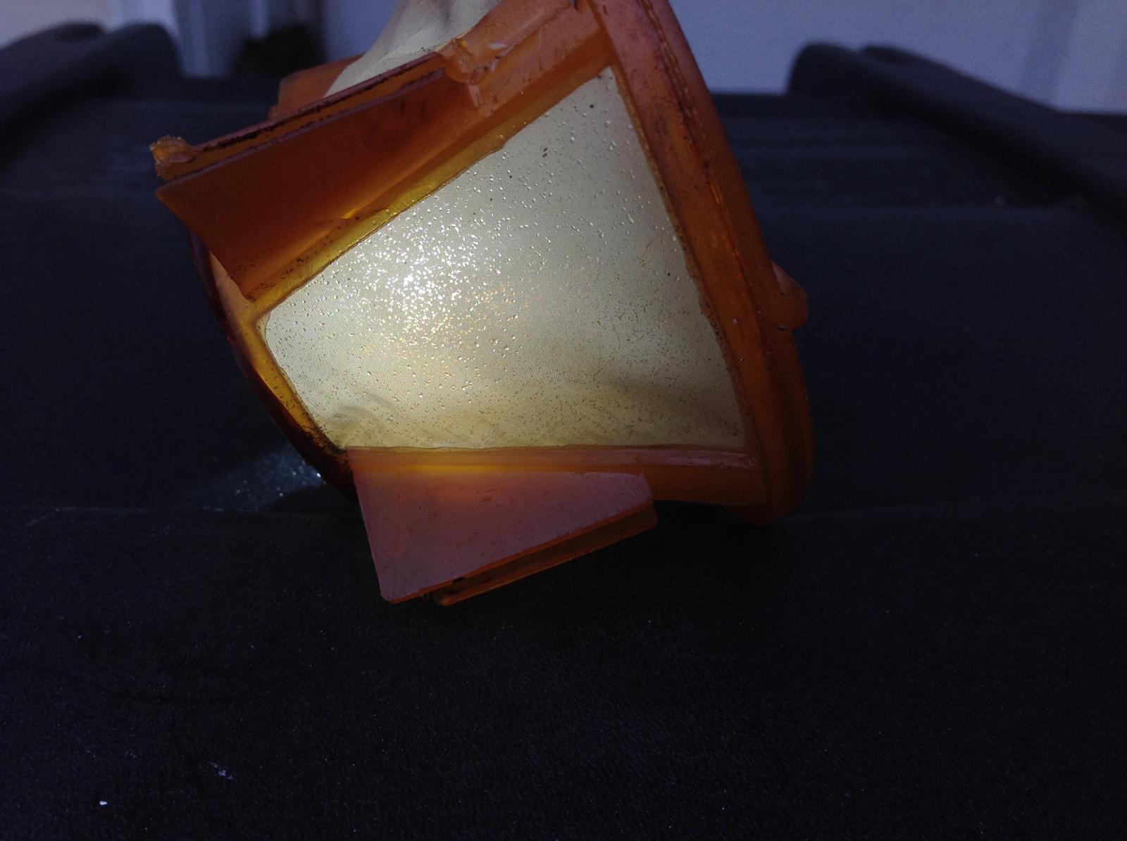

Wildthings wrote:
The question is how to do on the road repairs when the fuel pump starts to cavitate in the middle of nowhere.
Well........
I may Very well have the answer to life's persisent Questions........Guy Noir......
No, no, NO!!

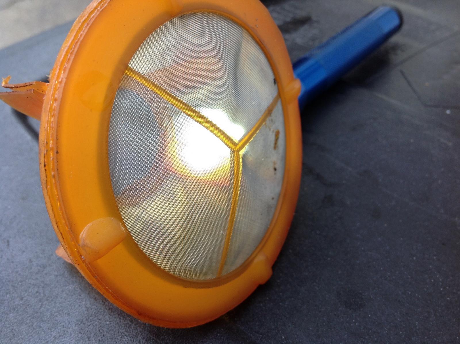

Look at these photos of my 1986 108,000 mile screen TO the fuel pump.....
Top view......
Lower portion of screen...... See how little light gets through? Clogged screen!
"As Baby sucks harder, baby gets Air in tummy"........ (You've got to old to get that one kids)
Dave[/u]

The outgoing and return fuel from/into the tank is filtered.
The gaps left for a very empty tank.. understandable, at least to this dolt.Smile

IMO, you really don't want a filter in the gas tank.
It looks like you could swap the feed line with the return line if for some reason you had a no-flow situation

PostPosted: Sat Jun 20, 2015 7:57 pm    Post subject: Reply with quote
You COULD with a full tank.
But once you got down to 1/4 tank or so you would start sucking air rather than fuel. The return filter screen doesn't have a sealed pipe to the fuel well.
The hose terminates on the upper edge of the return screen..... Several inches above the fuel tank bottom.......

I disagree.
Honestly, after seeing how clogged my fuel feed screen is on the lower sides, I now advocate tossing that old tank and that one get a cheap replacement that hasn't any filters in the tank. ..........

I appreciate what you're doing here but I don't buy the visual light test you are doing on that filter unless you are using that light show to demonstrate a flow problem that you confirmed by some other test with fuel not able to flow through that lower screen section. By your reasoning the fuel would only flow through the top part of the orange screen and when the fuel level got below the top it stopped flowing. Was this actually happening to you?
Remember those baby bottle nipple commercials? They often used animations to try to convince you that there was a problem with old fashioned nipples so that you would rush out and buy their nipple for twice as much money, using that baby screaming as a guilt factor, you bad bad parent. Your light test seems more like that baby cartoon trying to demonstrate a problem where possibly none exists.
djkeev
Posts: 32989
djkeev is offline
PostPosted: Sun Jun 21, 2015 5:43 am    Post subject: Reply with quote
Nope, no confirmed problem for I've never driven this car with this tank installed.
So,
When you look at my inlet screen photo it begs to be asked how you think fuel with this screen would get to the fuel pickup well at the rapid pace that a 300 liter per hour pumping rate would require once the fuel level dropped below the top screen.
I haven't any flow rate tests..... Sorry.
The light behind the filter screen is a visual aid I used in an attempt to clearly show how clogged the screen is.
How would you photographically show something being clogged?
Please enlighten me.
Are you saying that you don't think it is clogged?
I fail to grasp your point here.....

PostPosted: Sun Jun 21, 2015 7:34 am    Post subject: Reply with quote
Well.......
I got to wondering, how pourous is that filter screen?
I cannot scientifically measure the volume that passes through but I can by simple observation SEE what passes through.
I cut out one of the filter screens and using duct tape strengthened the edges and formed it into a slight bowl shape.
I know that the adhesive on the tape has a very short half life in gasoline so this is a one shot deal.
I wondered if the screen has a residue from sitting that gas will cut away?
Anyway, I placed my bowl over a small shot glass and then using a straw and finger over the open end siphon transferred some fuel (Shell E85, oxygenated, unleaded regular) to the filter bowl.
What did it do?
It filled the bowl and then slowly.... Ever so painfully slowly seeped through the screen, not unlike water seeps through coffee grounds to make coffee.
Rube Goldberg flow test results?
Fail!
Even if one were to suck fuel through this membrane, it would be hard going.
Dave

PostPosted: Sun Jun 21, 2015 7:58 am    Post subject: Reply with quote
Maybe you could also repeat that rube-ish test with the portion of screen from the top of the pickup too. Though its pretty obvious that screen was loaded up with tank sealer.
