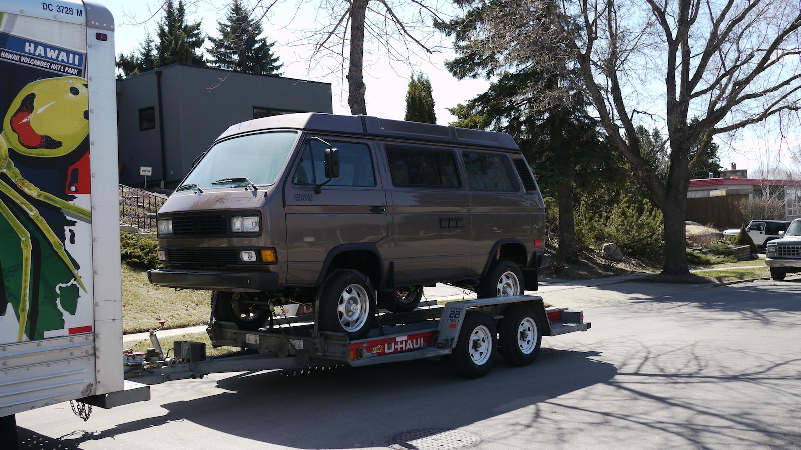

I have spent a lot of time on the Samba over the last few years, but so far I haven't posted much about my van. I purchased my Syncro in March 2012, it looked OK, and I had worn my wife down to the point where she finally said yes.
Here are a couple of pics of what it looked like then.
I got it home, still happy with my purchase. It passed an out of province inspection, and I was ready to go camping with the family. That didn't happen. The first time I filled-up I learned I had bad seals on the roll-over valves on the gas tank. Over the next few months I found a few other problems, didn't really drive the van much, and didn't camp in it at all. That fall I started what would turn out to be a nearly two year project. Still haven't camped in the van, but we recently did our first family trip, a test drive out to Elk Island National Park. Introducing Syncro Braunbaer:

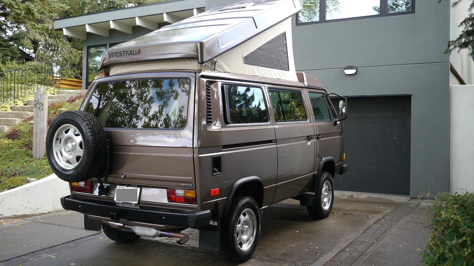

I still have a few things to do (like hook-up all the camping equipment and install an aux power system), but this past weekend I decided to give it a good wash and take a few glamour shots.
I'm really happy with how it has turned out. I want to give a quick shout out to all the people who contribute to the Samba. I didn't have a lot of mechanical experience going into this, and the Samba has been a great resource for me. There have been a lot of really great build threads over the last couple of years, and when I have a question I can usually find the answer here.
I'll post some more details and photos of the build, but some of the highlights include a Vanistan 2.2L with new throttle body, VSM, oil cooler, and tuned exhaust. Transmission rebuilt by AA transaxle with 5.43 ring and pinion, 1.18 3rd/0.82 4th, decoupler, and front and rear lockers. Burley upper control arms with syncro.org springs and OME shocks. Burley tire carrier and hitch, Terrawagen flares and podz, along with European H4 square headlights. The paint and body work, and suspension and brake work, was done by Barry at Werke 1 in Vancouver.

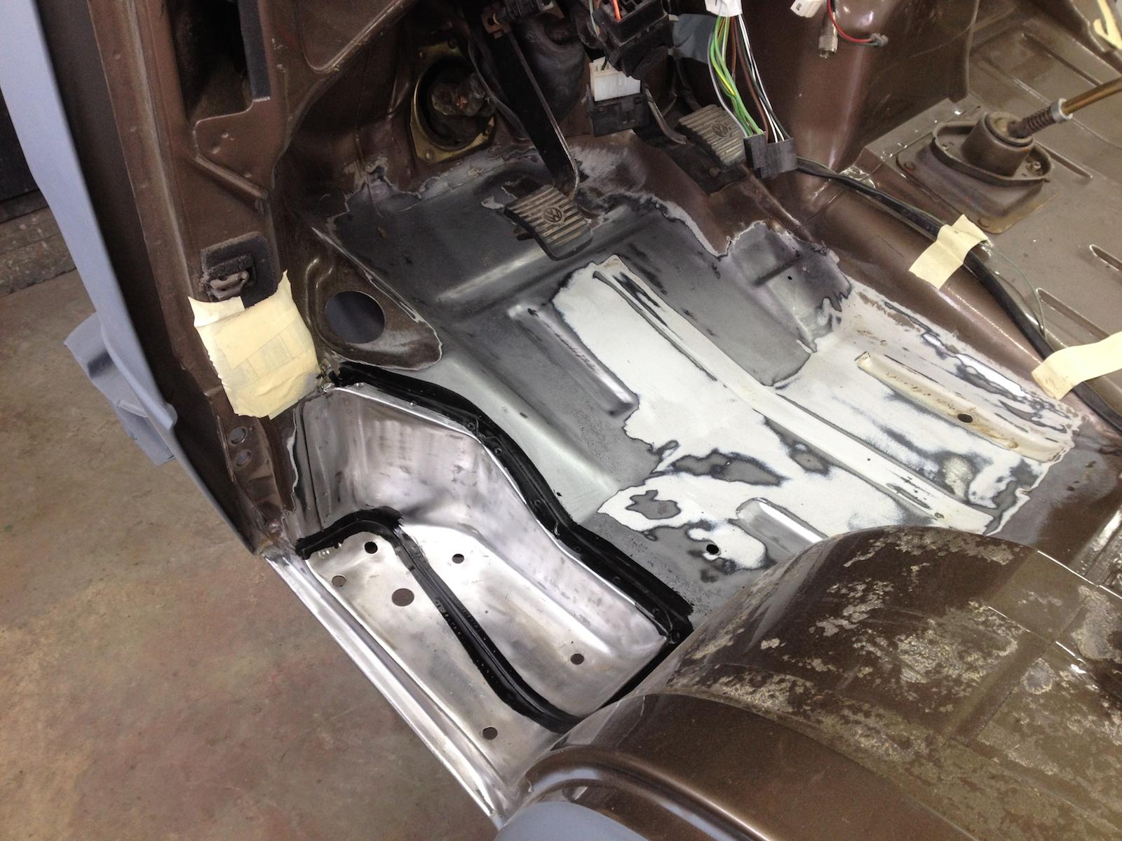

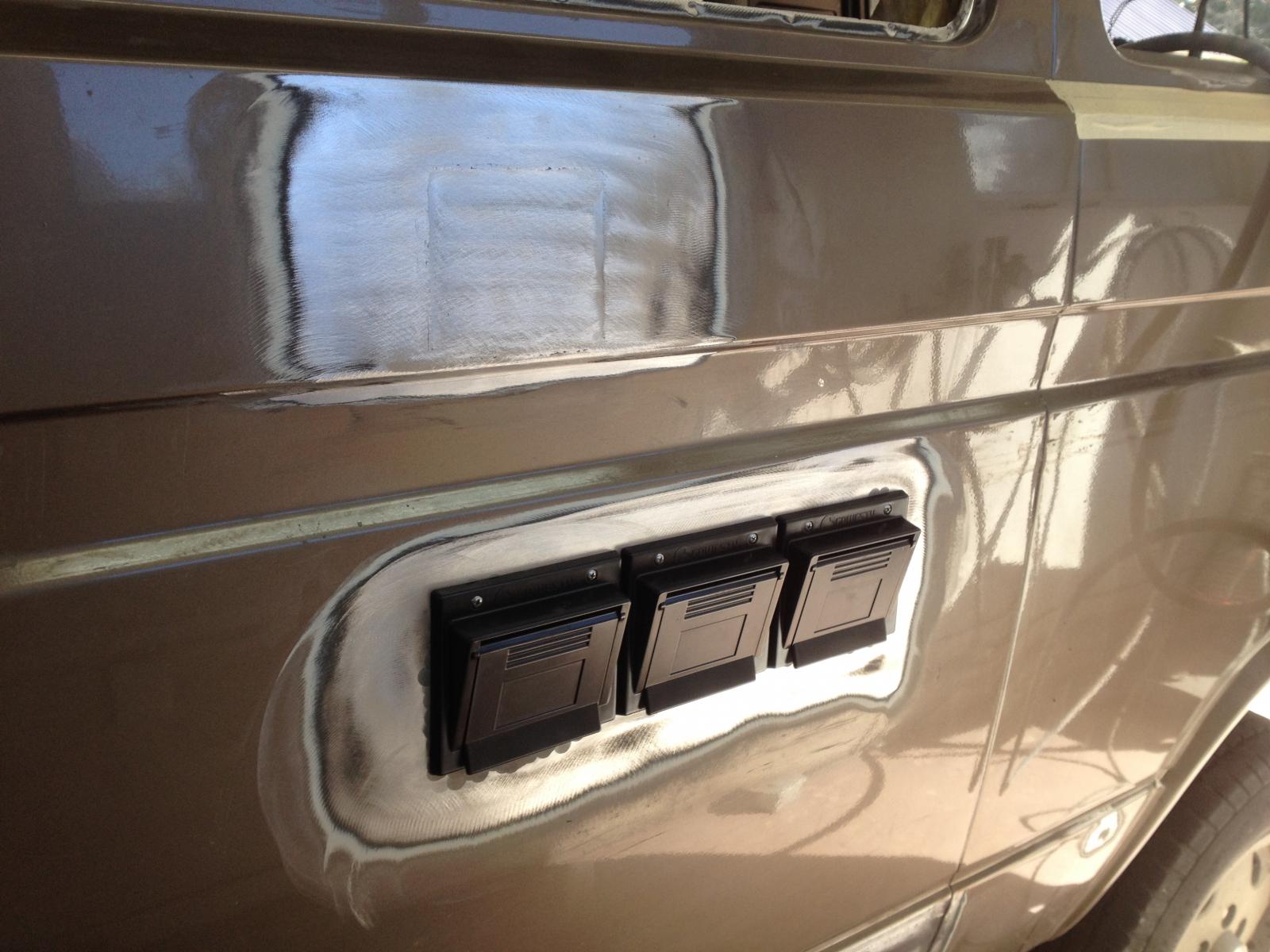

I got to work pulling the interior. Some camper panel rocker rust, the result of leaking hook-up boxes. But aside from that not much that I didn't already know about.

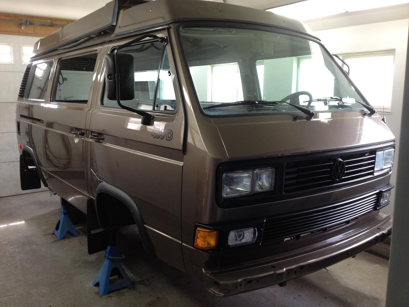

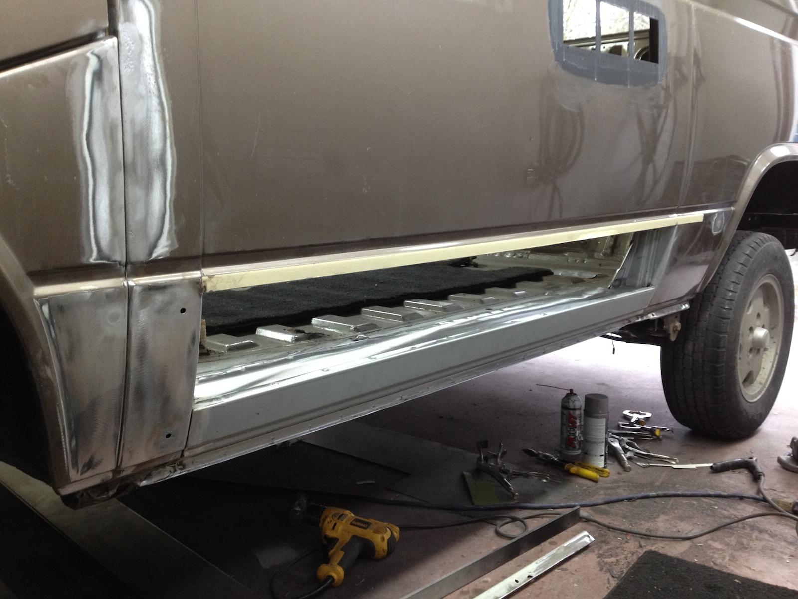

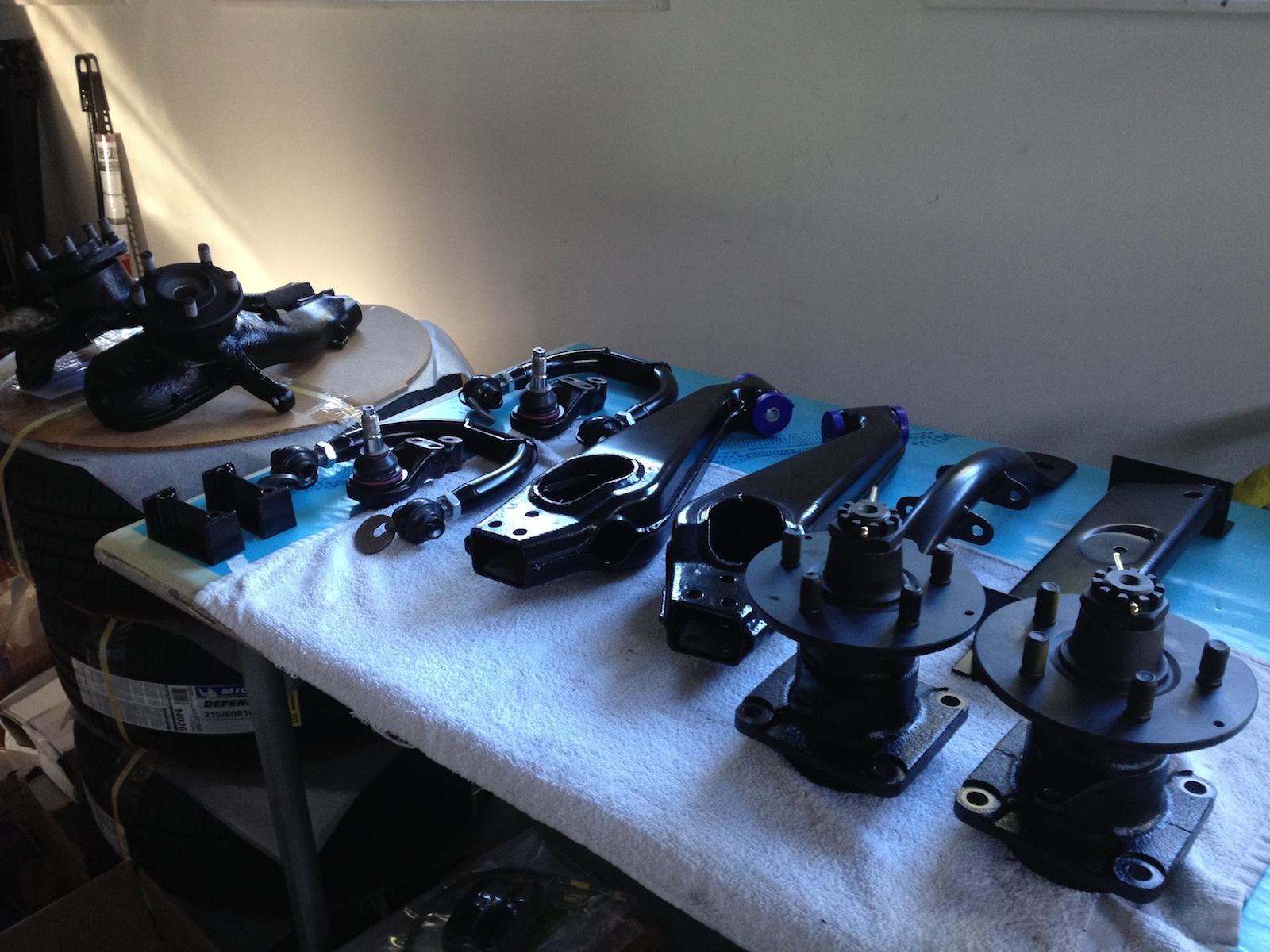

Having the van stripped down to a rolling shell I was ready to take it out to Barry for rust repair/paint, and also to have him do the brakes and suspension. I rented a U-Haul to trailer it out on the second weekend in January. It's about 1200 km through the Rockies, and was an adventure in itself. I did the trip in a day and a half with blizzards, avalanches, and freezing rain. Not fun but it ended well with the van in Barry's competent hands.

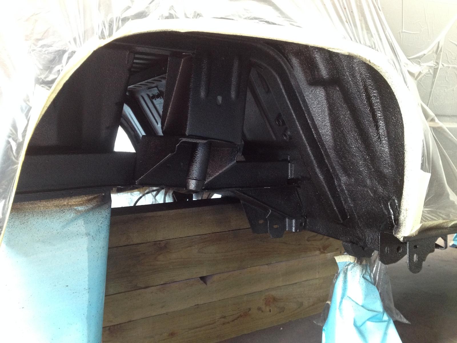

He kept me updated during the process with plenty of pics. Some of the rust repair.
I knew I wouldn't be re-installing the fridge so I had him weld that up.
Fixing the frame rail.
Painting. I stayed with the stock colour, bronze beige metallic (LH8U).
Undercarriage.
Suspension and brakes. All the parts were plated or powder coated. Heavy duty drums, the latest version of GoWesty big brakes. Burley upper control arms, Schwenk springs/OME shocks, with the rest of the parts stock.

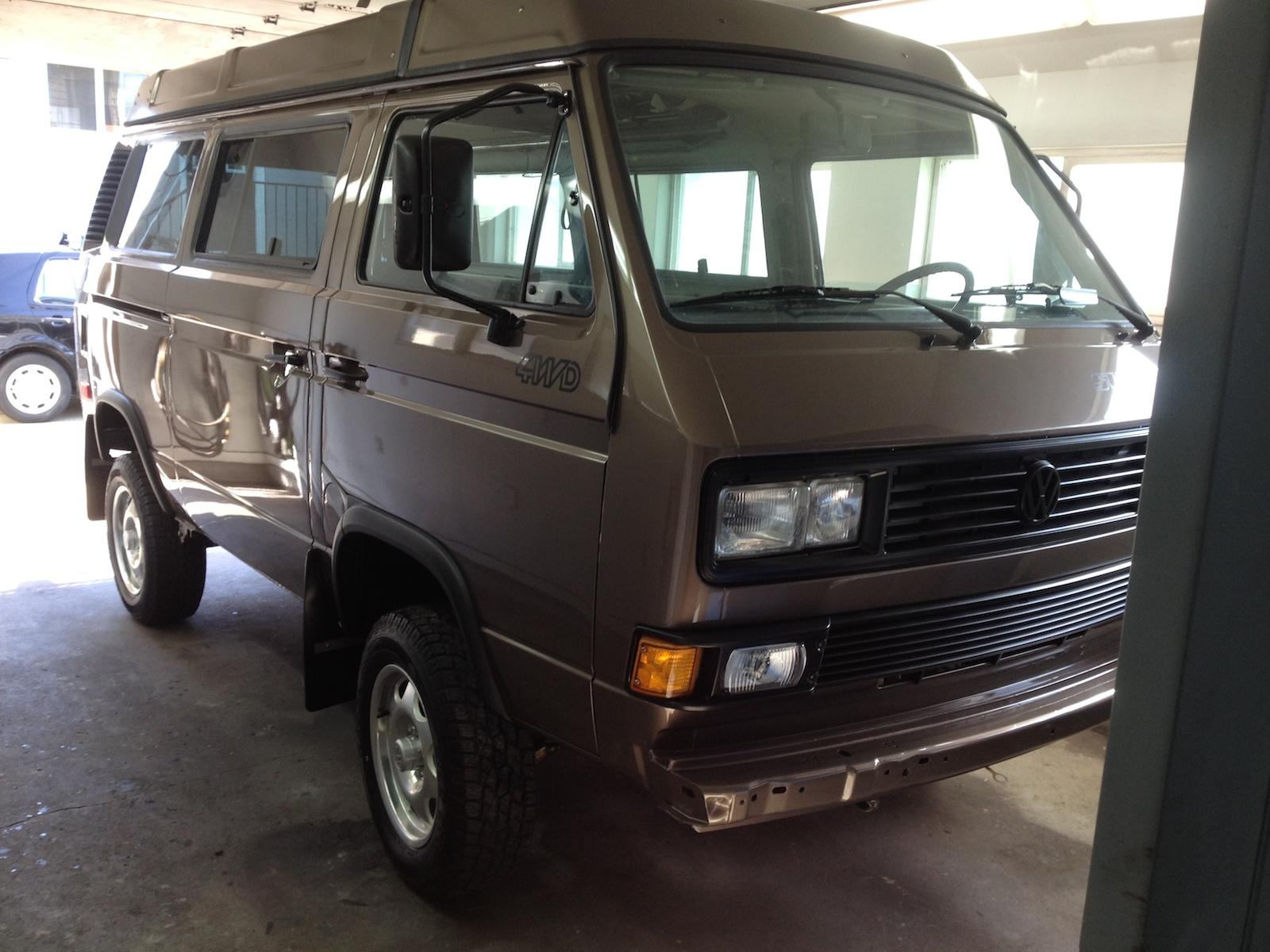

And back together as a rolling shell again, but a much nicer one!
At the end of May it was time for another trip to Vancouver to pick it up, this time with nicer weather and a much nicer van!
