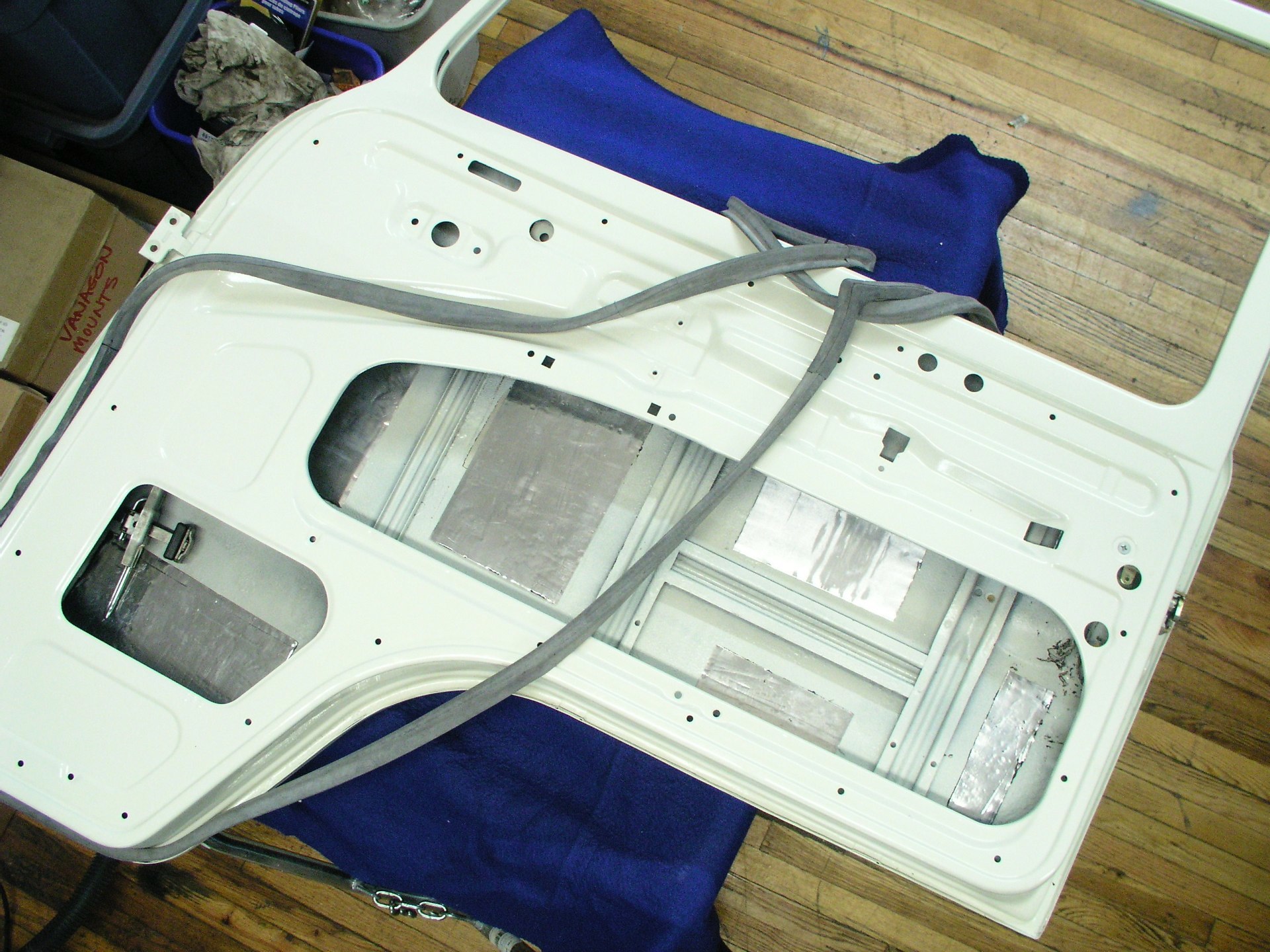

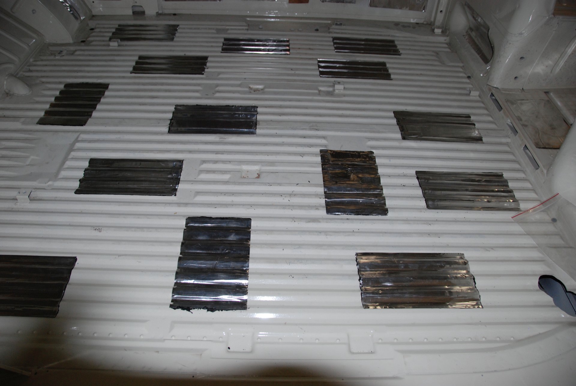

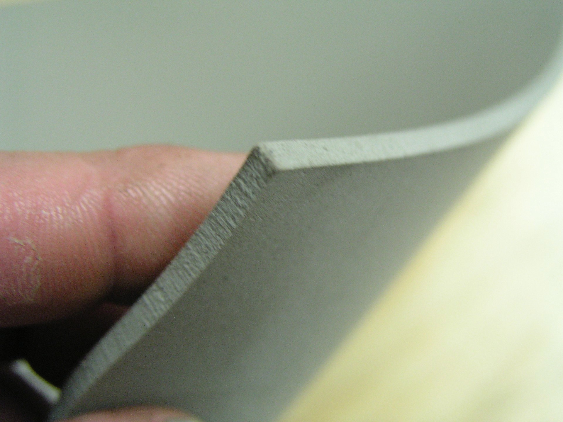

as i understand it, it's not necessary to cover so much surface area of the panels to be treated (as seen in photos above where the entire surfaces are covered).
on a bus we're working on we followed this method:
http://www.sounddeadenershowdown.com/
you're covering 25% of the panel with the mass loaded vinyl (it's the sticky foil-backed material) and the whole panel gets covered with the high density foam. there's a third step that you can do involving sealants but it's too invasive and non-reversible so we're skipping that part.

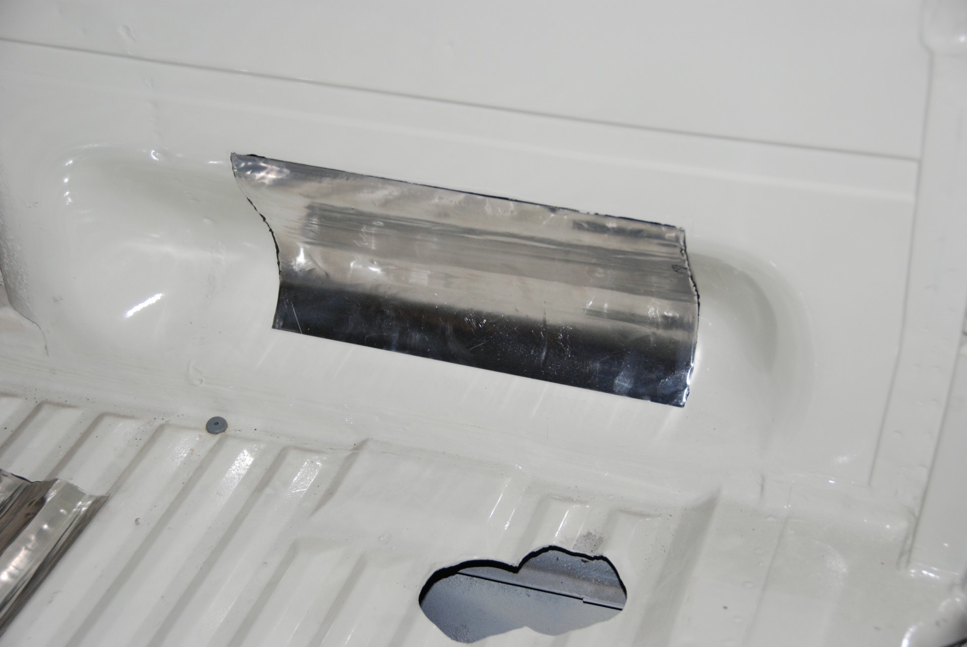

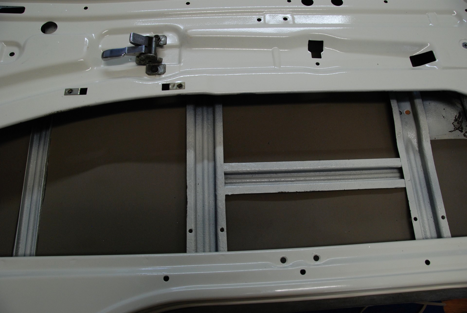

Scott...its very true that you don not need to cover every surface....if its sound you are deadening.
Sound is complex. Its reflected and transmitted. It can transmit through a panel and then bounce/reflect around. If the volume of the space its in is larger enough the sound can expand....usually dropping in amplitude (or technically increasing amplitude and dropping frequency) ...and get louder like a megaphone.
Inside of doors for example you may only need one large patch on the inside of the outer panel to absorb or arrest the sound as bounces/reflects back from the inside of the inner panel. Some small pieces mounted on the inside and on the end cap will act to arrest some of the many stray sound waves.
Breaking up large panels like the floor and ceiling in moderate sized patches of odd spacing can sometimes do as much as an entire sheet.
The only places I have heard from people who do a lot of this....that warrant full sheathing are trunk spaces ....for instance.....that are going to be housing a high energy sound source like a sub.
I think you misspoke.
The CLD Tile is what you use on 25% of the surface. That is what stops the panel resonance.
Then you cover everything with the Mass Loaded Vinyl to block further sound travel into the vehicle.
I did the inside of one door with some dynamat, cause I had the door opened up. I just used 2 square feet, and spread it out through the door. I was amazed at how much of a difference that made in the overall sound of the door when closing it.
