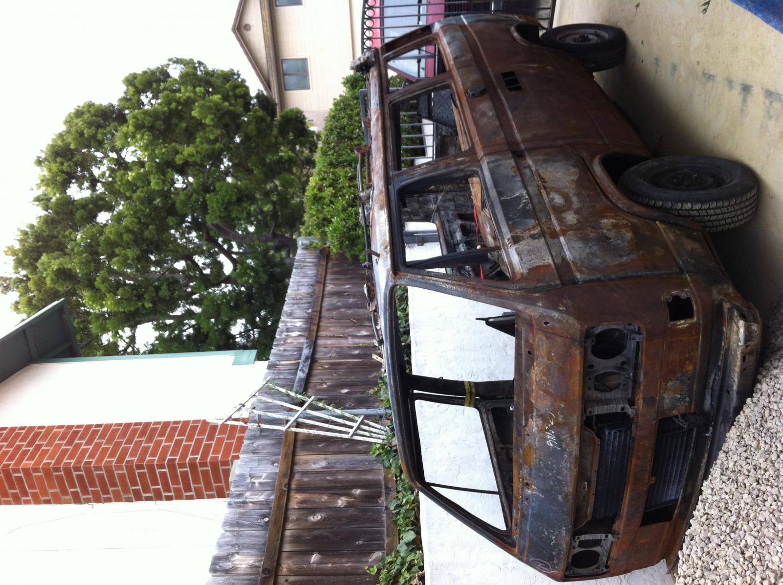

Well, after a little over two years of parts gathering and planning I’m finally starting my build thread. It all started with Syncro lust for driving deeper into Baja for surf trips. Then it became a fixation when I saw a burnt syncro for sale and thought, Hummm…. I could convert my 2wd. Yeah… you know you have problem when that becomes a plausible reality. Anyways, I bought it and it was the start of this chain reaction.
Here are my goals for the build.
1. Must travel in sand and messed up roads in come comfort. ( I’m not a rock crawler guy, more of a freeway and sand driver)
2. Good gas mileage. (This is a problem)
3. No rust because I don’t want to do this again.
4. Security because Mexico is well… Mexico
5. Modern comfort features.
6. Middle seat so my friends don’t feel like I put them in the back of the bus and ostracized them.
7. 5 or 6 speed transmission (No need for a Granny gear, so you know I’m going Suba-gears)
I had a choice to buy a SUV or build one, I choose to build one and this will be my daily driver. The money that would have gone to Toyota or Subaru is now going to a 27 year old van. What could go wrong?
You may want to consider a TDI. High 20's or low 30's are easily achievable.
If security is a concern then the pop top is out. A high top would serve much better in that regard.
You might consider one or two rear facing jump seats. I think they do a better job of maintaining a nice interior space than the middle bench.
A: Really want a TDI, but I am waiting to see what will be offered in the future before the dive train decision is made. Allot of exciting options are being developed at the moment by others.
A: Not really a high top guy, but I did think about it. It would be too hard to drive as a daily driver for my taste. Wish I had the room to stand up though, that would be nice.

Is this the Syncro you purchased???
If so, may the God's be easy upon your efforts!!
You are one optimistic dude!

PostPosted: Wed Dec 03, 2014 12:28 pm    Post subject: Reply with quote
that looks like mine after the fire…
http://www.expeditionportal.com/images/stories/articles/CP/SyncroFarewell/Burned1.jpg
my full story here in case you missed it...
http://expeditionportal.com/a-final-farewell-to-my-best-friend/
In my case even though it looks really bad, the fire went up and not down so everything under the Syncro was still intact. I was able to get all the front diff/axle/sub-frame, transmission, vacuum, etc and plan to reuse those.
Obviously the gas tank and filler were melted but I found those easily already.
I still need to find the front dash plate tough and some wiring.
I also dismantled a way-too-rusty-to-salvage Westy Syncro last year so I have now 2 kits to install…when I find the time and the right recipient.
