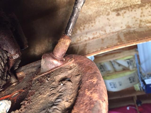

First post, so sorry if this topic has been covered, but I couldn't find info for busses. Anyway, trying to remove my backing plate on my 1966 bus. I can't figure out how the Hand brake cable disconnects from the backing plate. There is no bolt on the back side. Do I have to disconnect from the hand brake itself?
Thanks,
Toby

pull spring away from backing plate.
remove U shaped clip
then cable should pull through backing plate.
don't lose U shaped clip.

So I started pulling on the u-shaped clip and noticed it cracked a little bit. I wasn't pulling on the spring at the time. Just worried that when I pull the spring, then the clip, that it might break or not be able to go back on. Do you have any advice on what to do if the clip does break?

So I followed Clara's advice, but the cable would not come out of the backing plate. I was able to pull on the backing enough to get it around the spindle. Hopefully I didn't ruin the adjustment on the hand brake. Confused Fortunately I was able to preserve the metal clip on the cable. But I bought a pack of horseshoe clips just in case.
Question Any other ideas on getting the cable through the backing plate?

I was replacing mine so I cut the cable and drove the casing out with a large punch.
Maybe try penetrating oil and a small punch to drive it out. Carfull not to hit the cable though. Unhooking the cable at the front will allow you to get the spring out of the way.

The end of the cable is metal and that slips into the hole on the backing plate. They often get rusty and are hard to pull out with out some persuasion like a tap on a drift from the inside to push it out or at least loosen it. Heat or a good spray penetrate like kroil is another option.
The whole works including the spring on the cable will come out.

it's also a lot easier to work with if the backing plate is still bolted to the reduction box.
