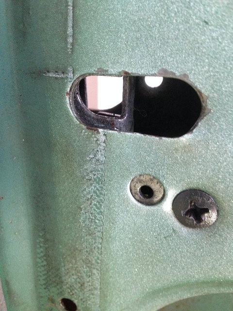

Hello All!
I just got my first bus this past weekend and have been cleaning it out. However, I am
to get the drivers side door open. I removed the outer lock, and have attempted to lift and pull when using the inner door handle and still will not budge. It appears that it is stuck on the lock somehow. The bus in mention is a 1965 standard. I have read and searched and have soaked it with pb blaster religiously and nothing. Any help is greatly appreciated please! I have includes pictures below for reference. Thanks!

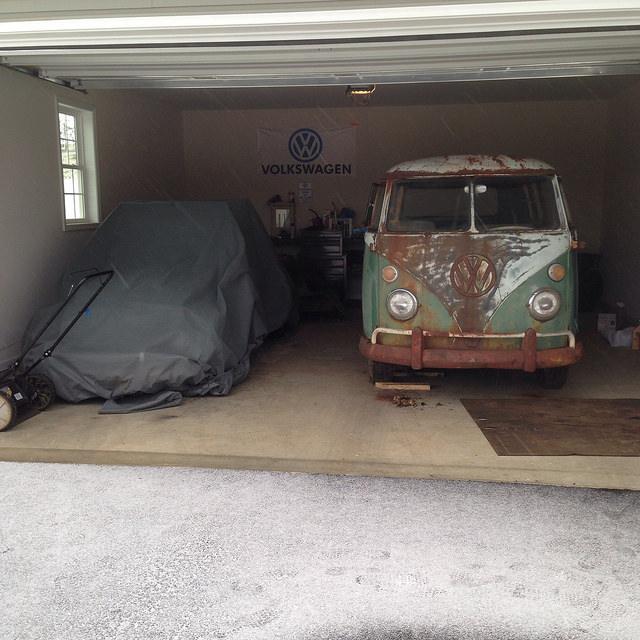

You can't just say you got a new bus & tease us by showing only half of one door and some key hole shots.
Don't be shy...Let's see some more! We like full body shots & don't mind a little undercarriage with some rear end Very Happy
Sorry! HaHa. I was just trying to get this figured out first as it's frustrating me...I plan to do a restoration thread in the future as well. Here is a couple of shots...
cru62
Joined: December 31, 2002
Posts: 4121
Location: Margaritaville.....24/7
cru62 is offline
PostPosted: Mon Jan 26, 2015 5:15 pm    Post subject: Re: Front Door Frozen/ Will not Budge- New Member Reply with quote
65Bugsmasher wrote:
See that square piece in the middle of the pic? Find a way to push it in and then pull it out (Darn you, Evan, see what you started!) a bunch of times while lubricating the assembly liberally. You may have to wait a while, but keep working it until it comes loose. That is the part that the door handle contacts.

Pull the inner door handle up and toward the back of the bus to unlock.
Looks like you may have a broken lock mechanism inside the door. In your photo, the large flat paddle gets pushed in by the outside door handle when your door is unlocked. On the left, you should have two smaller paddles with a gap in the middle. Looks like your top one is missing, up unlocks, down locks. Missing the upper would prevent the key outside from unlocking. If the inside door handle wont unlock the door, try pushing the lower left paddle up.
Mechanism photo from the classifieds.
Which lower left paddle are you referring to? Also, the inside door handle only moves the metal piece slightly, almost none at all. If this were to not work, how would I ultimately get the door open?

The actual piece on the handle mechanism which pushes on that spot is just pot metal and very prone to breakage if forced. I have had more than one crumble in my hand, usually when removing them to get the lock cylinder out. No one repros them that I know of.

65Bugsmasher wrote:

65Bugsmasher wrote:
Does this look to be good? When pushing on it manually, the mechanism releases.
First, clean all that crap out! Dip it in degreaser, brush it, rinse it out. That way you'll be able to "see" all its parts more clearly. Make sure all tabs and springs are there. If it all works properly (opens, closes, locks), grease it all up and reinstall it. Worn out and/or missing tabs/springs may require replacement of the whole thing. Good luck! Cool

65Bugsmasher wrote:
Hello All!
Can you push the tab in shown in the first pic above? If it does not push in the door is locked. I think it may be locked.
Unlock it by pulling the inner handle counterclockwise, which should pull the piece under the tab down. That is probably confusing.
Then check if you can push the tab in.
With the tab PUSHED IN, get in the bus and kick hard with the heel of your foot at the door RIGHT AT THE MECHANISM.
Don't kick it by the inner handle, unless you want to dent the door. Sad
This technique requires a helped with trust.

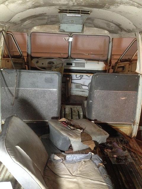

Thanks for all the help with the door situation everyone! As promised, this will now be turned into my build/ restoration process thread. I almost have the whole bus gutted so far and continue to find terrible surprises from mice and critters. Pics below.
Passenger side of bus:
Nice surprise I mentioned:
Walkthrough shot
Does anyone have any idea how to get off those interior Seat Cards off the back of the walk-through seats in the pic above? I got the ash tray and the grab handle off, but cant figure this out.Mad Tried to search and nada...

They are riveted in, drill out the rivets.
Thanks! I am assuming that WW or someone sells the replacement rivets when the time comes?
