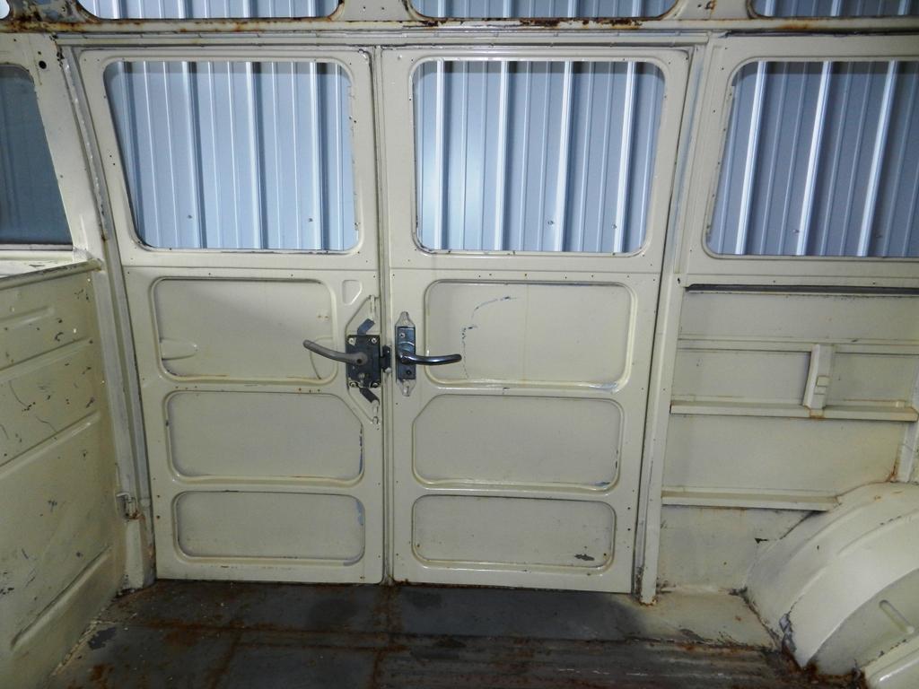

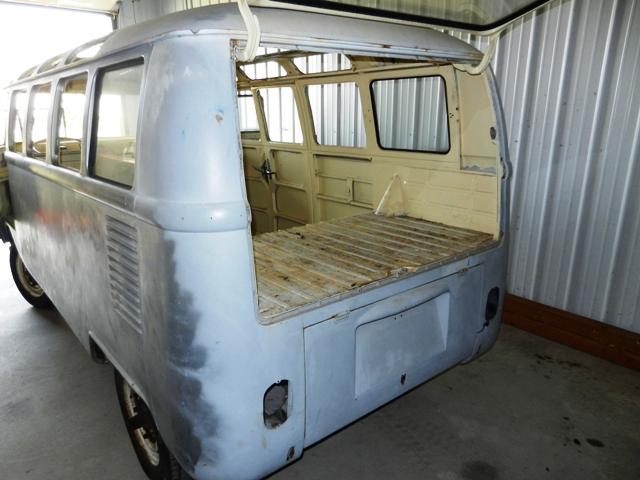

An interior view from the rear.

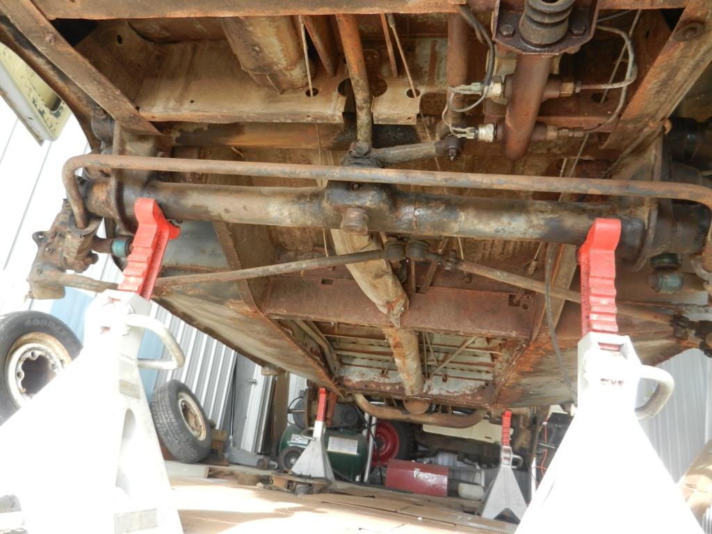

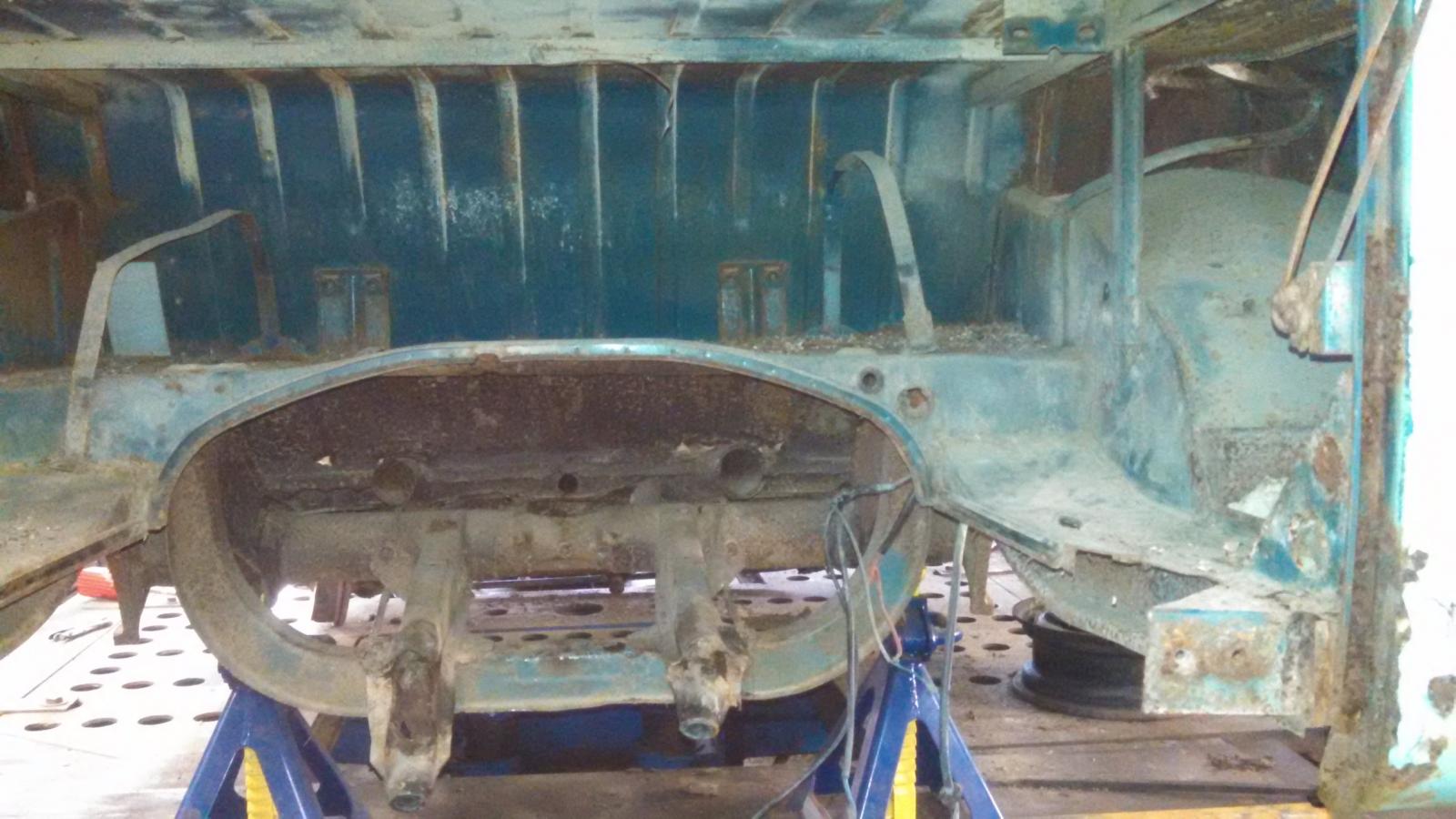

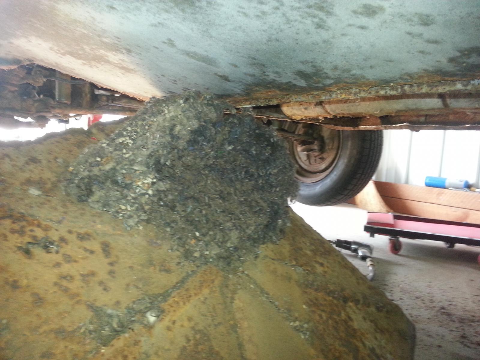

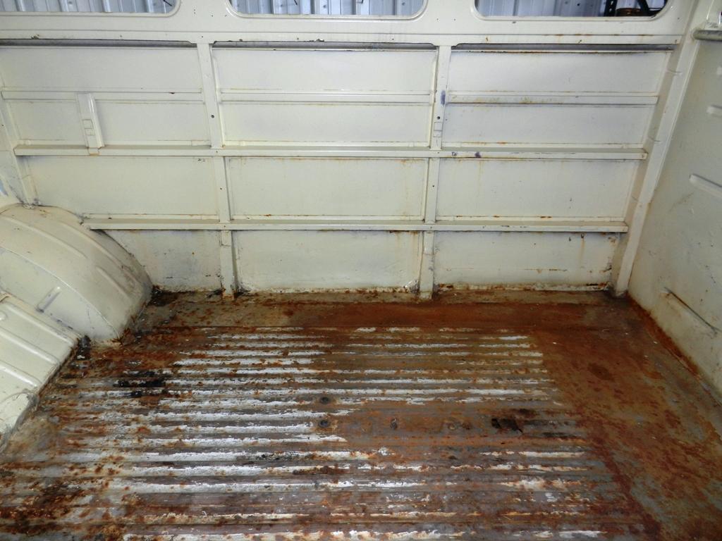

A general state of the underbody, I cut out the center belly pan, it was missing the front pan, it is on my list.

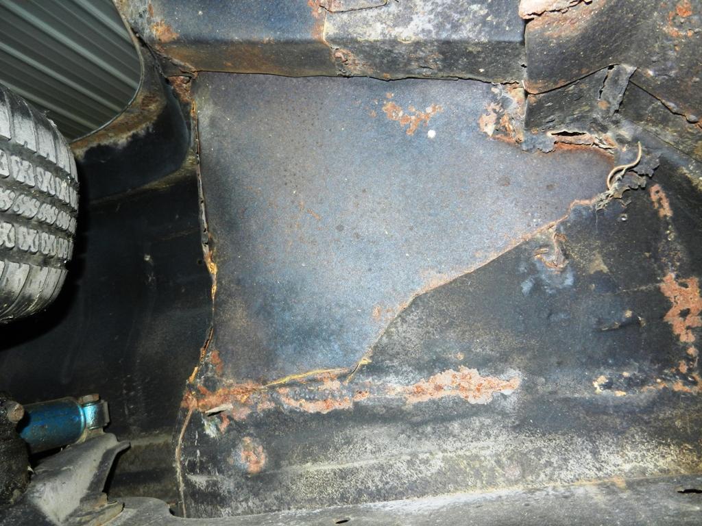

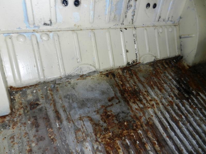

The pre-Gerson era patchwork floor work from previous owner, ironically, only the patches are rusty underneath.
Previous owner must not have planned on a heater tube. Areas where center seat are supposed to clamp in appear spotty with rust.
Center belly pan rather rusty and here is the mouse apartment complex found when cutting it away.

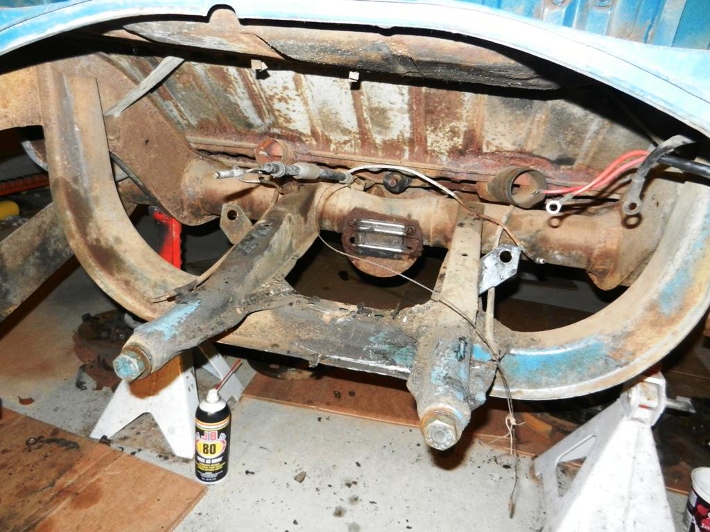

Front and rear cross members are worse for wear. I plan on having them replaced along with the jack points.

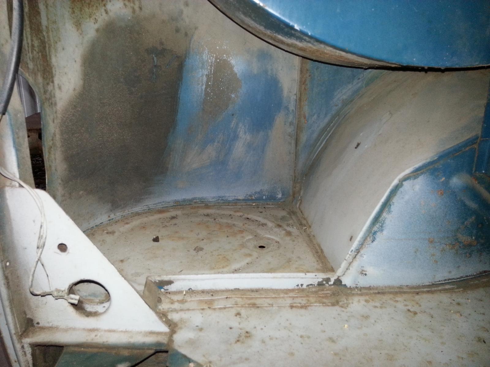

Driver's side engine compartment
Passenger's side engine compartment
Drivers side panel
I pulled the transaxle yesterday. The nosecone and a number on the unit indicate it is a beetle unit. The homemade front trans mount was a clue, it looks strong:
It is a beetle unit I am guessing based on the nosecone numbers and the number above the right axle. I have a line on a 65 transaxle and I need a nose cone.

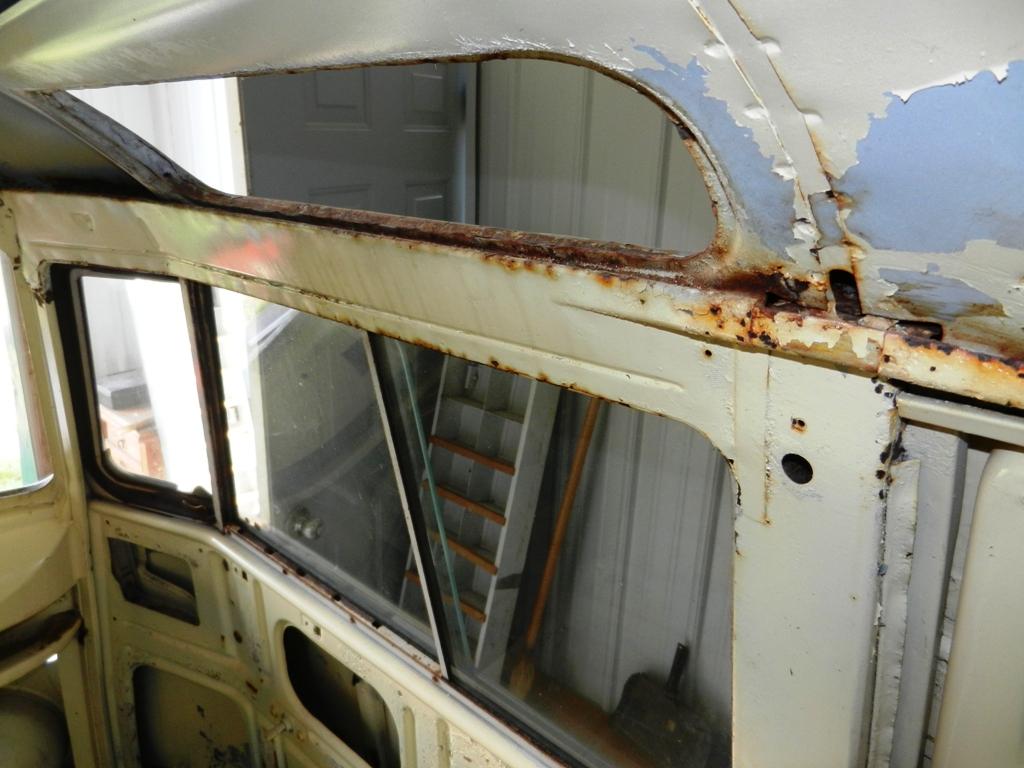

Some more photos uploaded recently
This is the previous patchwork under the front passenger seat. Repair appears sturdy, won't affect the view in the interior and may be suitable for the next owner to deal with.

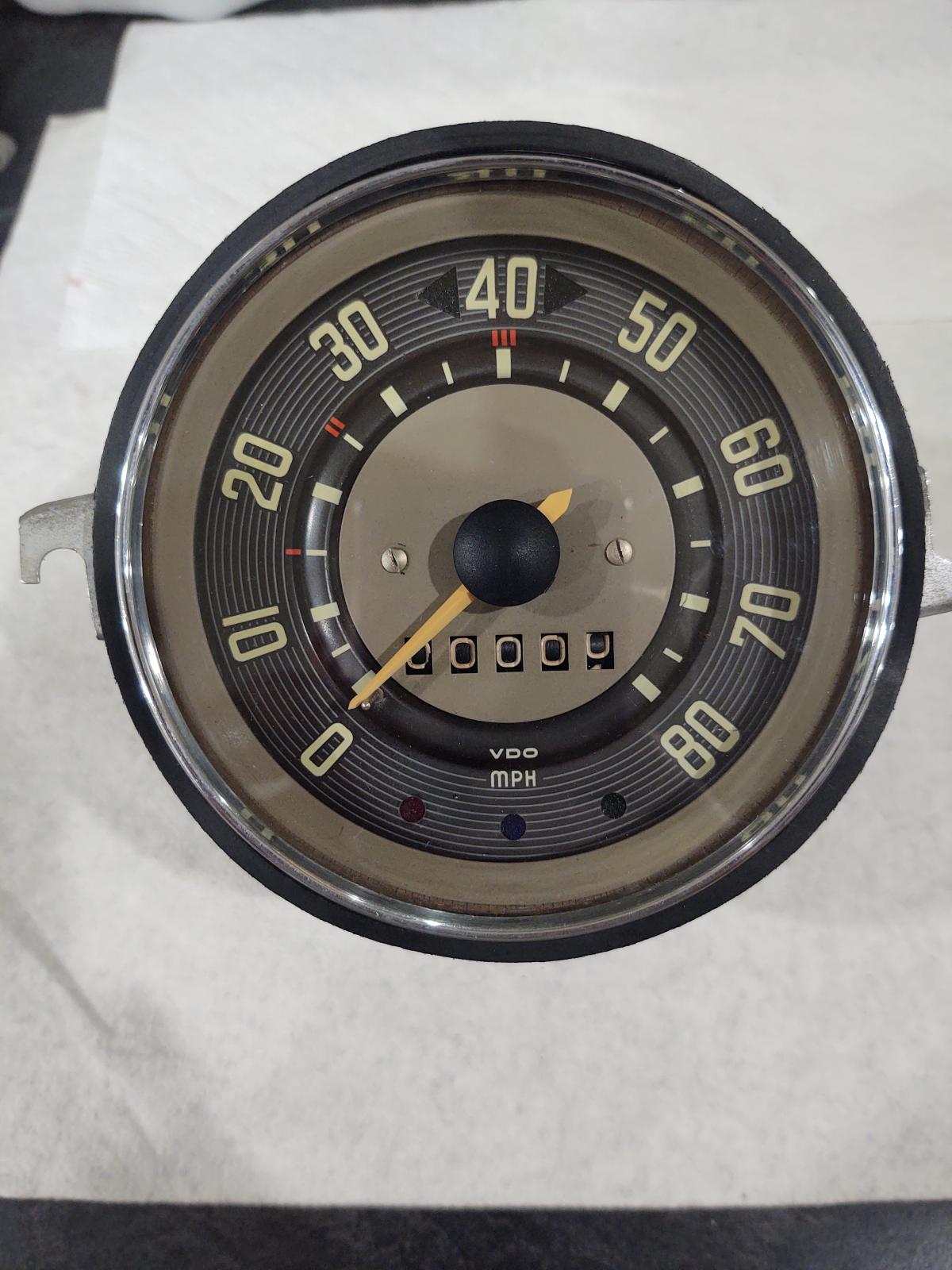

This bus is finally coming together! Eskimotom has been extremely patient with this long term restoration of "Patches" the bus. Thankfully it has survived a couple of moves, a trip to Virginia and back for painting, and now, over the winter I'm reassembling it and restoring parts as I go.

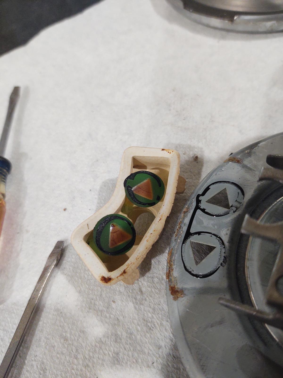

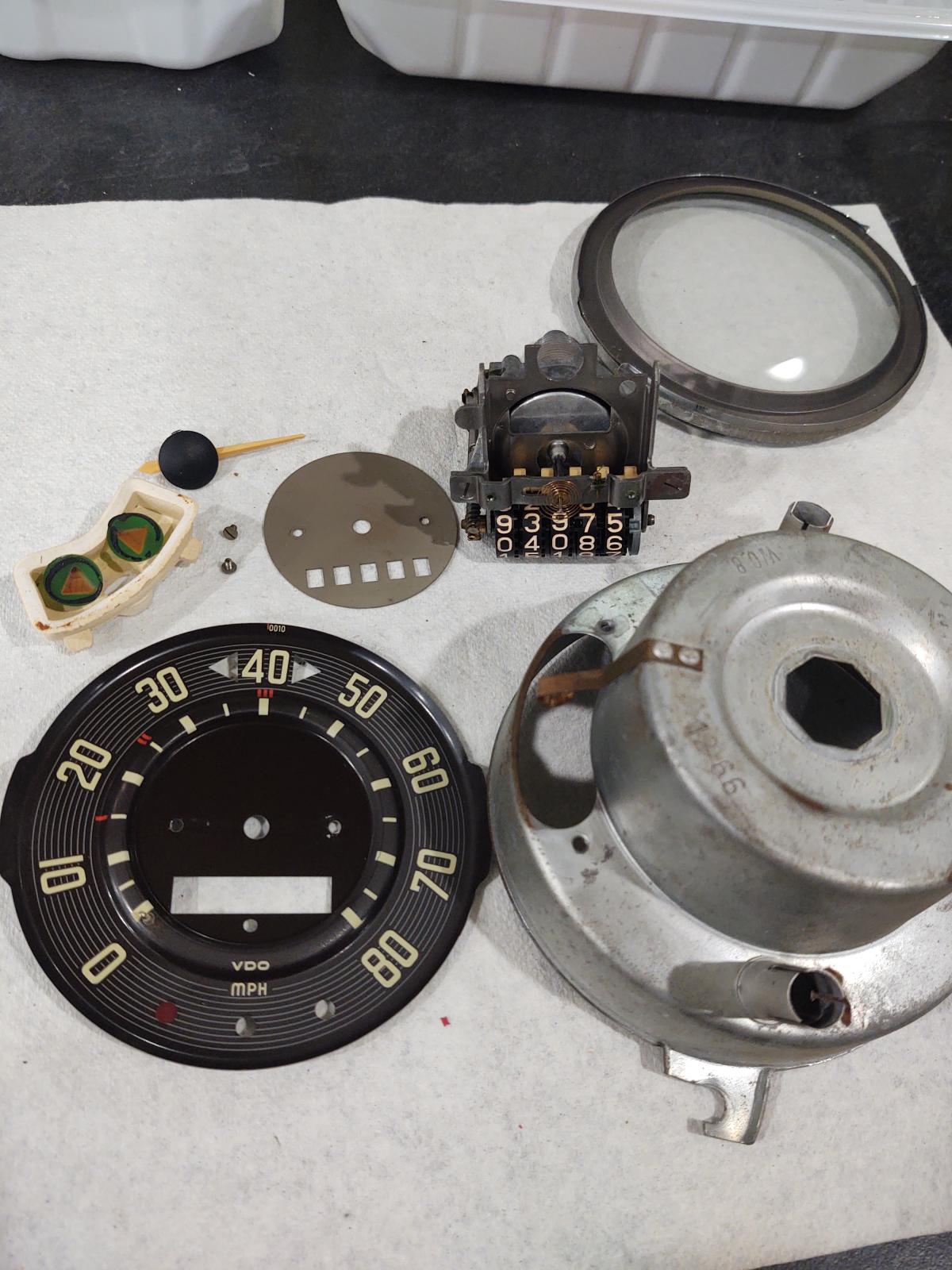

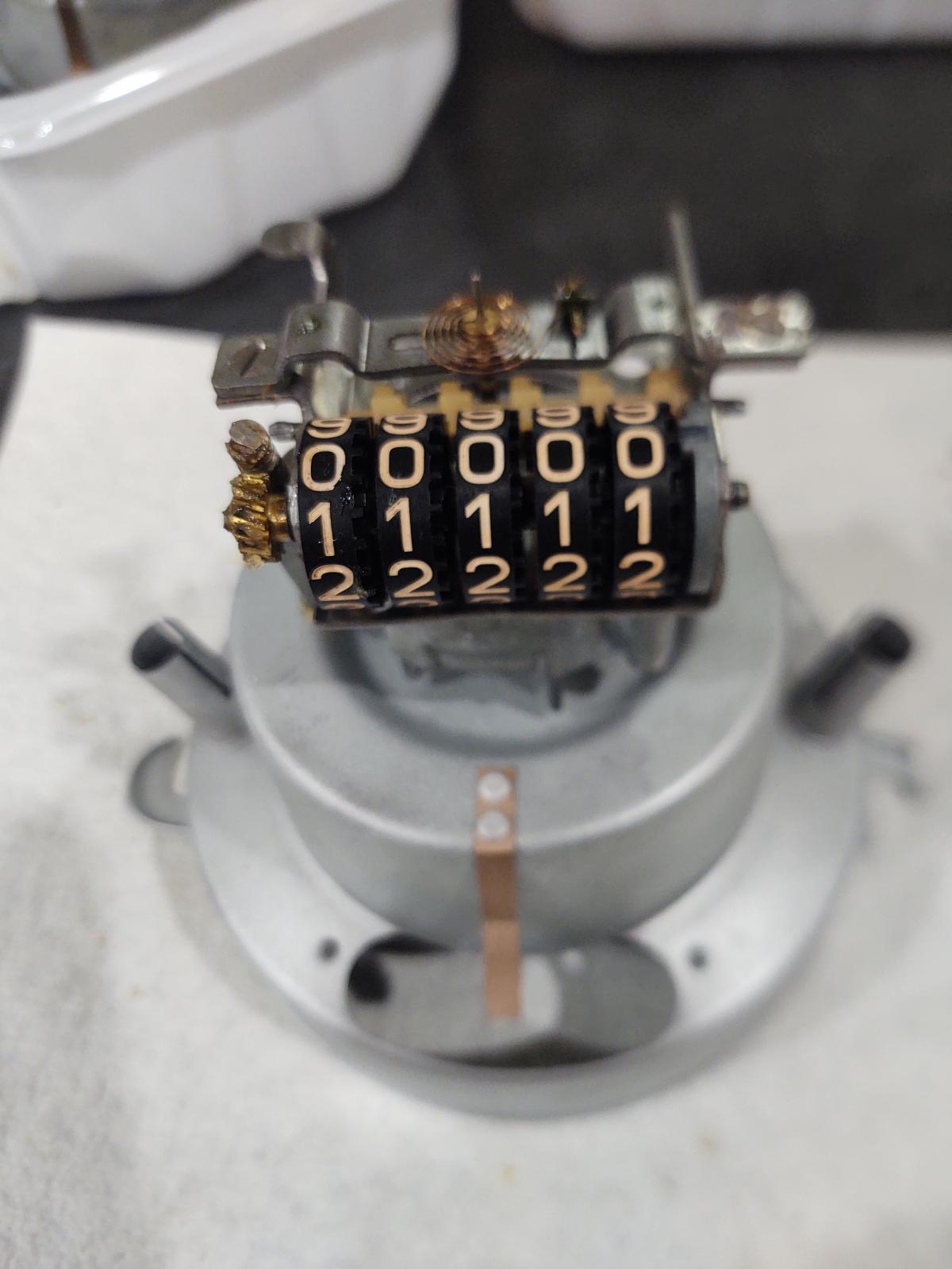

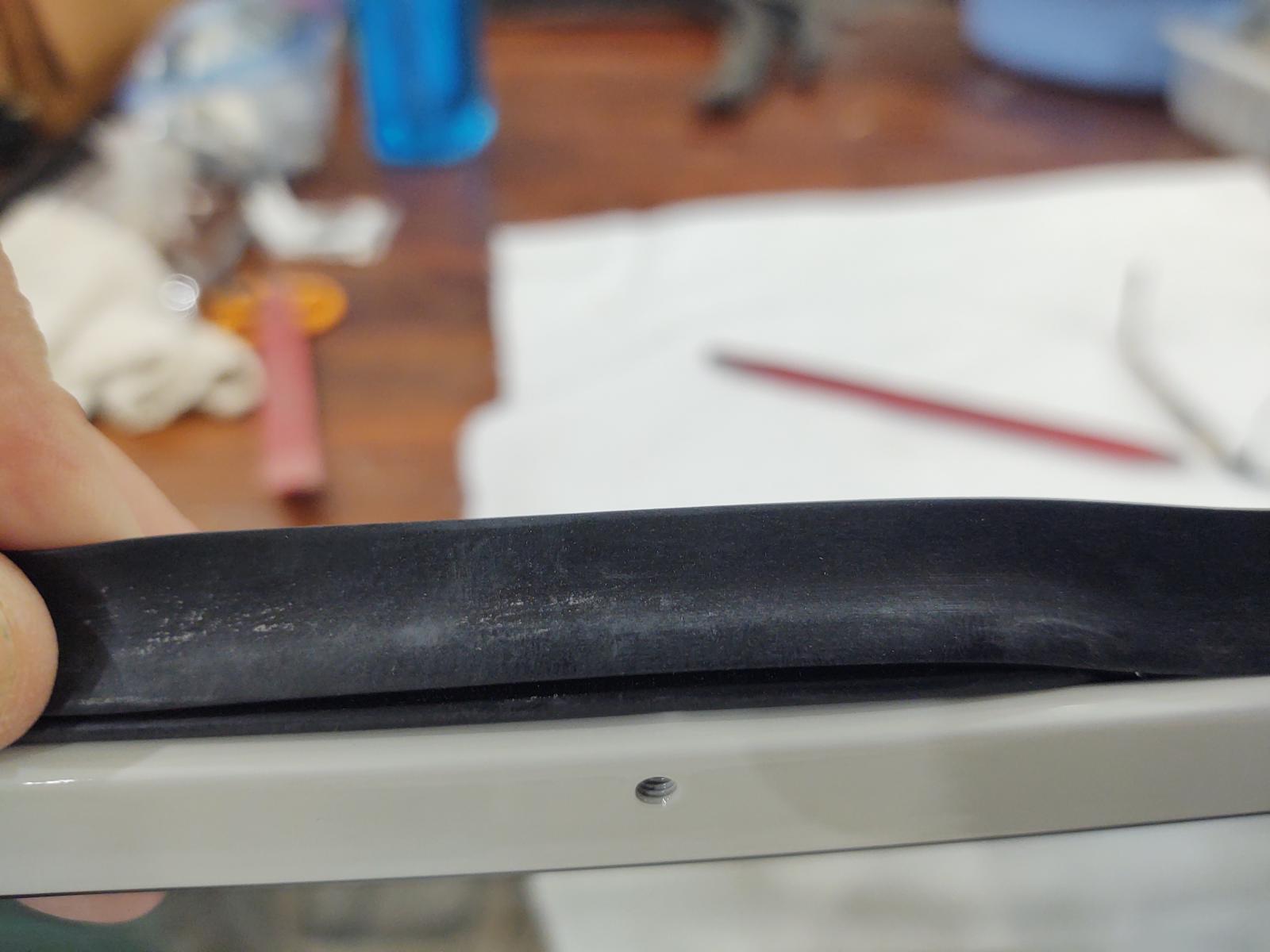

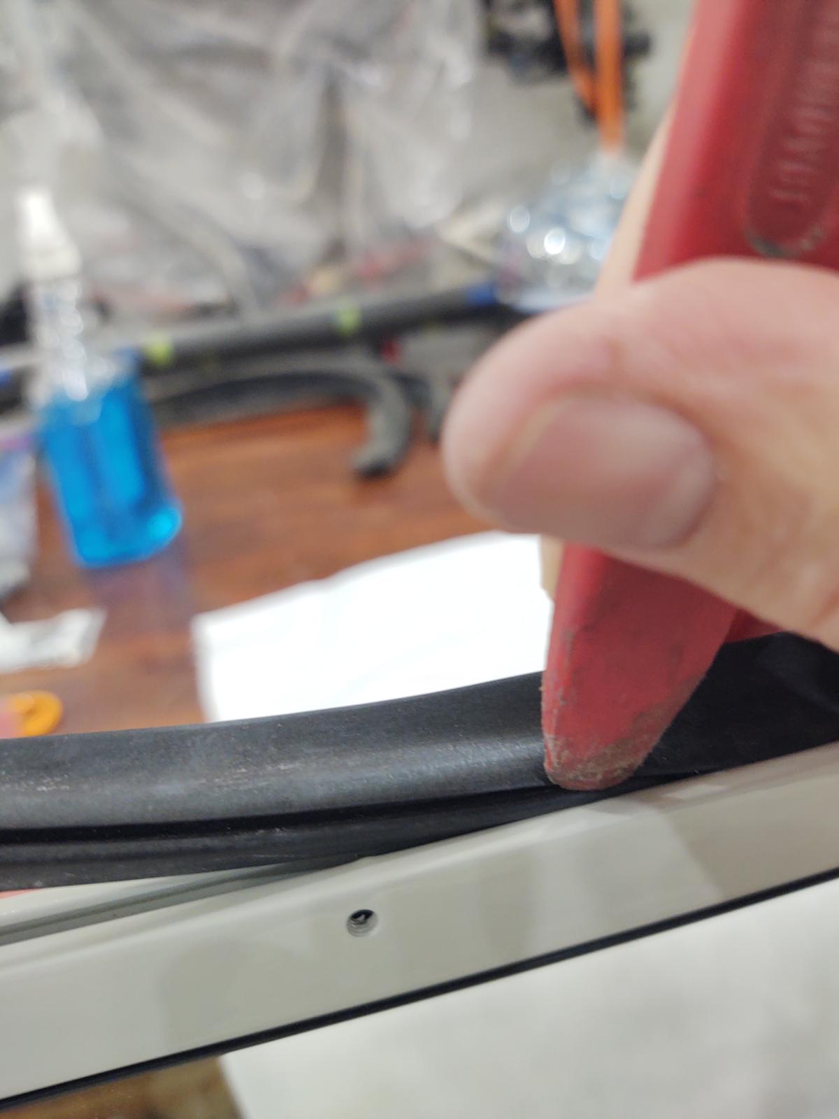

This first post is the restoration of the speedometer. It's a minor portion of the whole job, but it's something to me that needs to look and function as it left the factory, so a full disassembly and cleaning was needed.
Heres some before pictures:
Some during pictures:
And the finished product all reassembled, gels replaced, painted and polished, odometer set back to 0 and ready for many more miles.
There'll be more to come as I take time to write things up.

I'm just curious - why reset the odometer? It seems most people do this; when my rebuilder asked, I said no, as I wanted the bus to wear it's miles proudly. Even a full resto, most people aren't gonna look at the speedo and think '29 original miles!!"
Which is not to say it's a bad thing, and everyone makes choices with their car. Just curious.
Beautiful .
What part is painted and how did you do it?
What part is polished and how did you do it?
Center and outer rings are bead blasted and painted.
Chrome housing ring was cleaned and polished with 000 steel wool
I agree with your decision. In this case if you read Toms post above where he recounts the history of this bus you'll see that the bus was fairly disassembled and in horrible condition when he got it. It hasn't been on the road for decades and I'm not sure this was it's actual speedometer (it is a December speedo and a January bus so likely it is correct)
This bus is really being built back from a shell, literally getting a second life. As such I felt it justified to set the clock to zero.

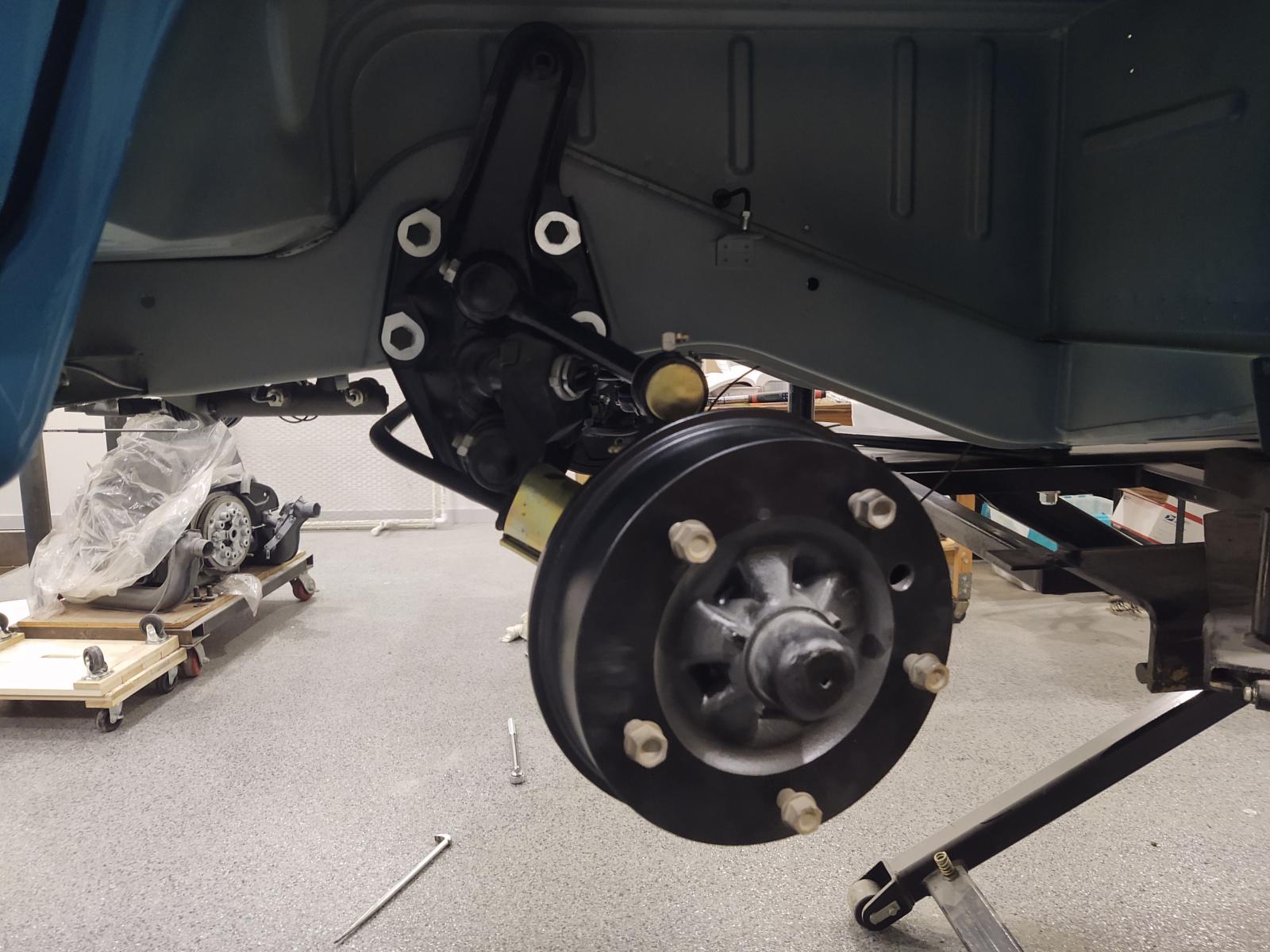

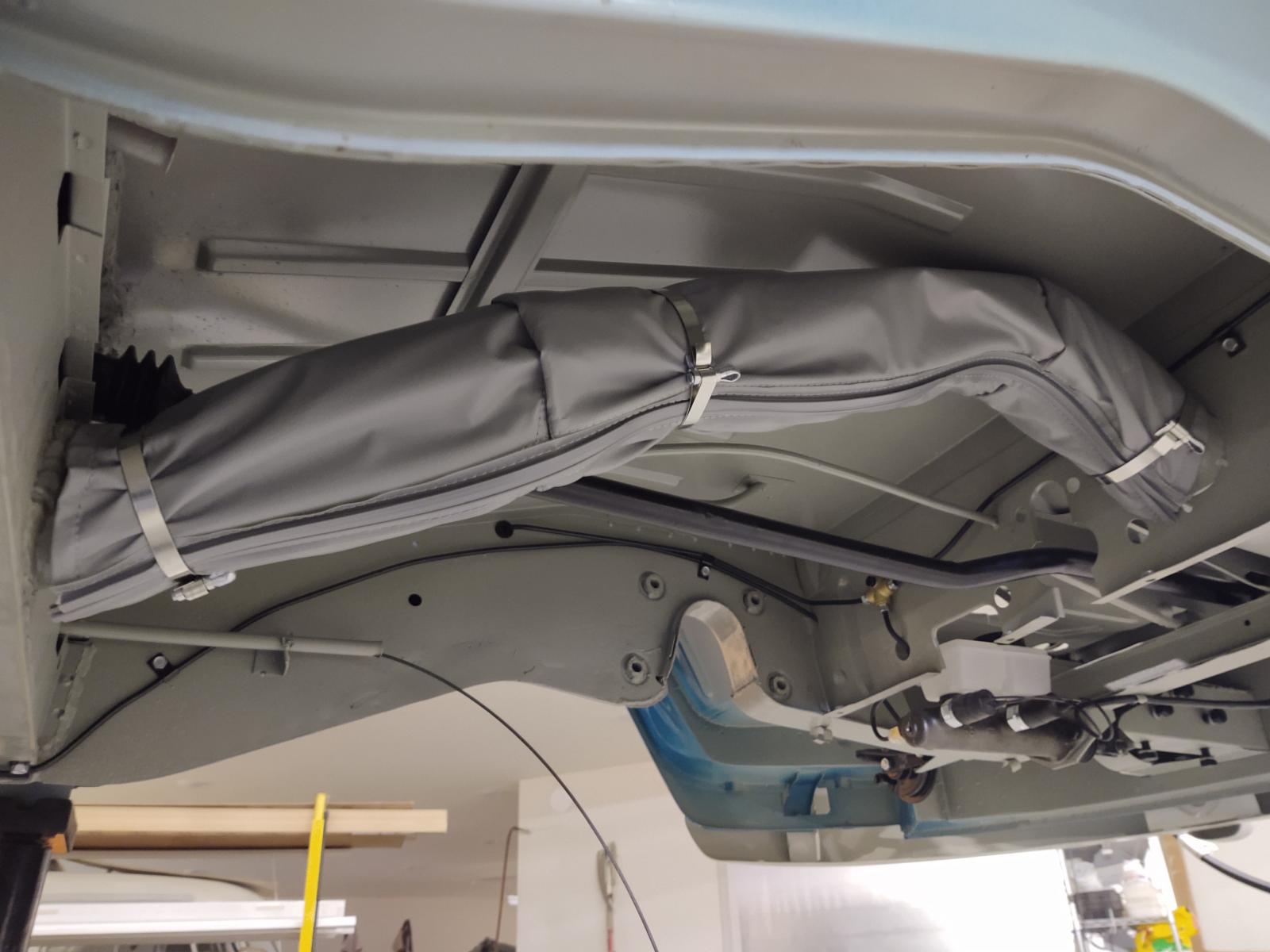

OK, more work on the reassembly
I had a few more items to complete which were easier with the front axle missing such as the wrap for the heater pipe.
Then it was time to install the restored front beam. Of course the shift rod needed to be pushed back as it runs between the axle tubes, but I find it it was useful to mock up or fit stuff when I can to be sure all is well before the final install gets really difficult.
And I'll toss in some random photos of the bottom of this buses front end.
Still a few items to finish up under there but I'm waiting for a couple of small parts.

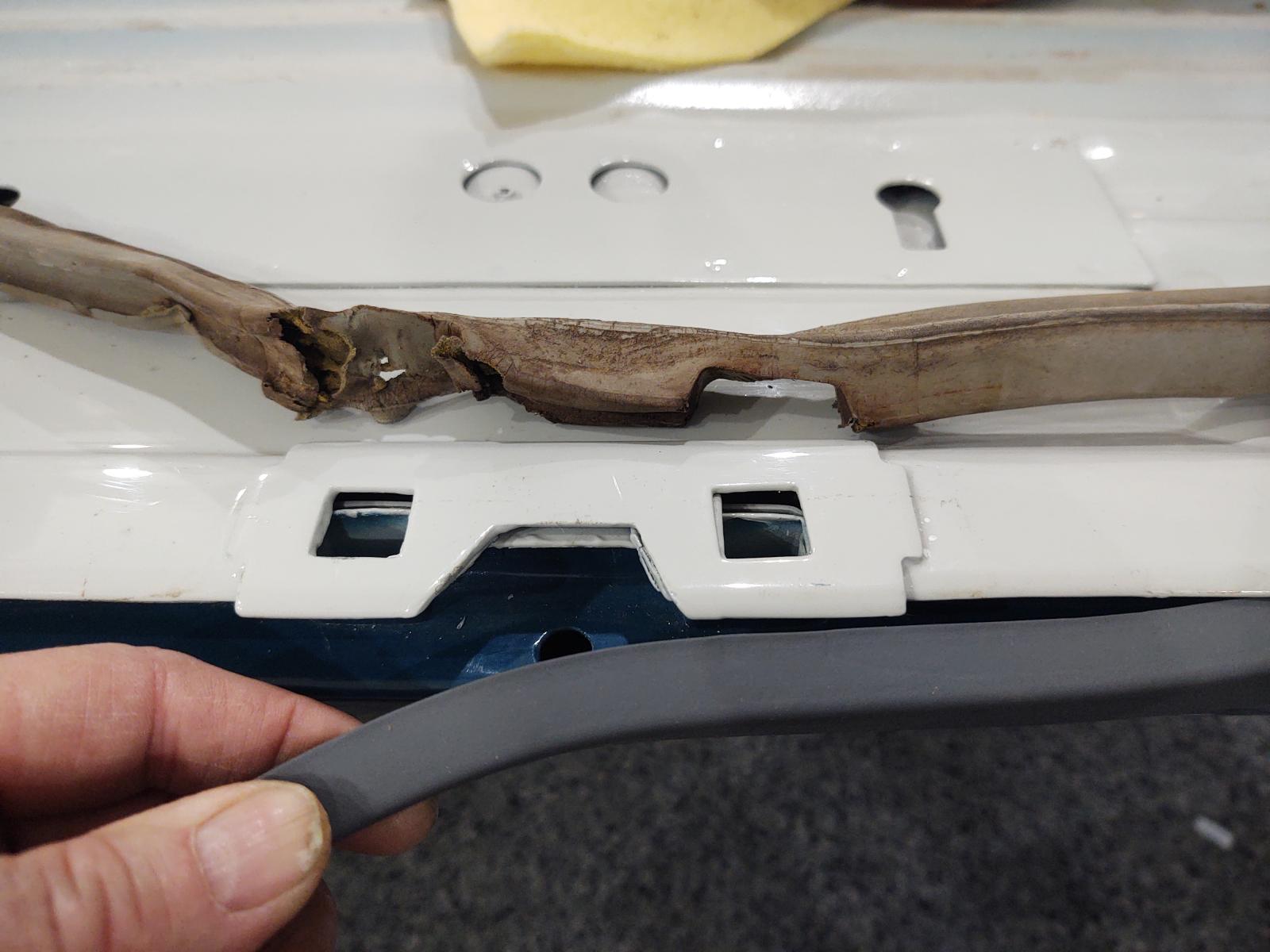

Then I though I'd tackle the seat stand mats and some of the cargo door weather stripping. It seems that so many of the rubber parts and seals you get these days require modification. Oh well onwards!

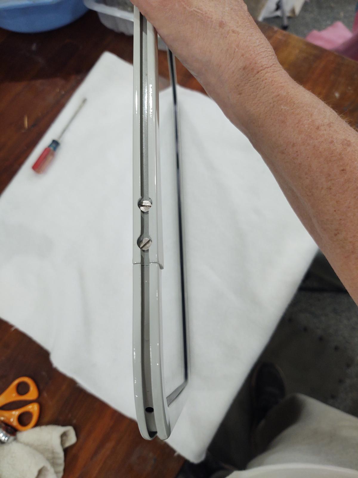

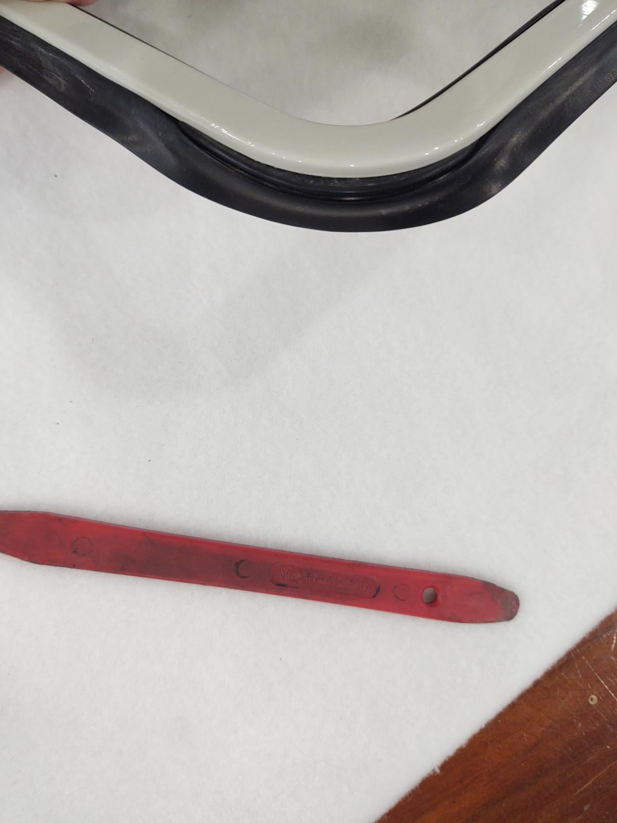

Popout windows are another job to tackle while waiting on parts. I've found these plastic tools to be invaluable while working on installing seals into slots. NEVER use a metal device if you're working around painted surfaces. You will chip or scratch the paint.
With these popout outer seals once you get the orientation correct, get the flat sides tucked in first and then do the corners.
This was one of the reproduction frames we had to use. The flaring out at the joining ends is something we noticed on both frames we used. You need to correct before paint. We apparently missed this one Sad so now we'll fix it after the fact.
It's always helpful to chase/tap the hinge holes (3.5mm) in the frames before you attempt to mount the windows. Those tiny hinge screws are hard enough to hold, position, and get started without fighting the paint in the threads.
Here's the proper orientation of the seal. Top painted is facing outside
