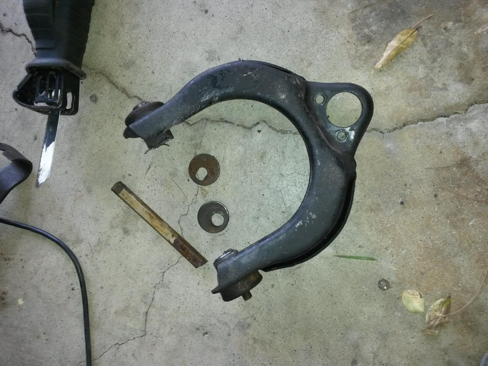

Well I got it out! Turns out the bolt was not bent but the bolt (head side) was rusted to the inner bushing sleeve. I sawzalled the bolt in 2 places; removed the Upper Control Arm & the rest came out easily. Below are a few photos of what's left. In the 2nd photo you can still see the bolt head which is permanently seized to the bushing!
Now I am curious if the van will ride any better (& quieter) on all new bushings, ball joints, tie rod ends, shocks & struts? Time will tell!

Nope. What rusts together is the bolt to the uca bushing. You can cut out the bolt & bushing & get it out without damaging the upper control arm. I did. went through a few Sawzall blades. Once out a new set of bushings goes in pretty easily. If you do end up damaging the upper control arm I have a spare I could ship you for about $35 shipped.
The tie rod ends wear & develop play. They are pretty inexpensive to replace & are a safety item. These should get done when you do your front end or sooner.
Here is a new tie rod end vs. old
New Upper Control Arm Bushing (there are 4 total; 2 per side)
Here is my upper control arm just after I cut it out (cut through the bolt & bushing on both sides. Note, the bushing protrudes on both sides so it can be cut out without damaging the arm.
Side View of the bushing slightly cut with part of the bolt still rusted to the inside of the bushing. The bushings have metal sleeves on the inside which is why the bolt rusts to the bushing.
