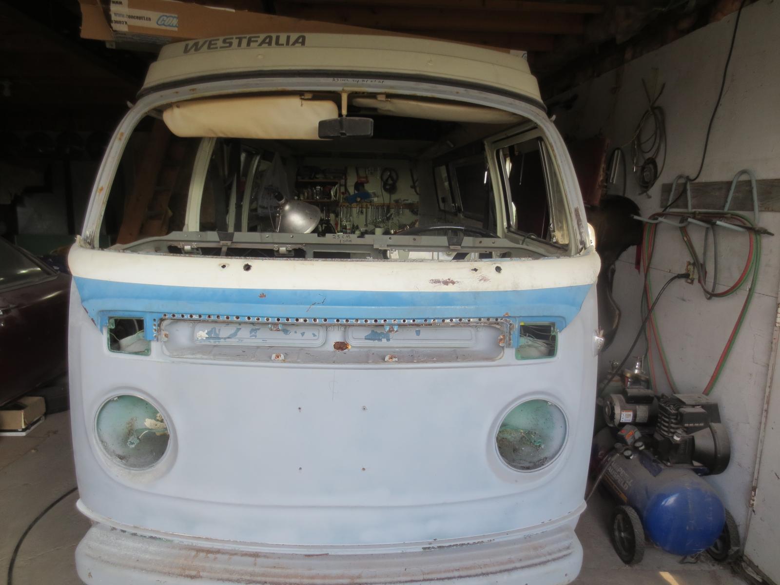

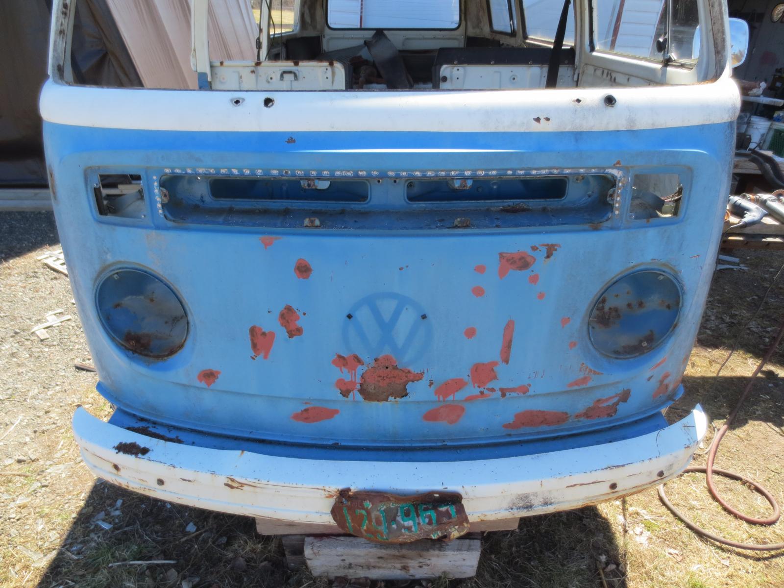

PostPosted: Thu Apr 21, 2016 4:25 pm    Post subject: Re: 74 bay window campmobile rocker rust,corner rust Reply with quote
I got the dog leg installed,now i'm onto the nose under the windshield.the blue bus is my donor,the white one[Ethel] is rusted all across the bottom,I will weld in the new piece from the donor,which is in good condition I have removed the plug welds from the air vent and will replace down to that point.at the sides I may cut from the signal light openings up on an angle to the windshield opening.I am also replacing the inner box section with the outter section.

PostPosted: Wed Apr 27, 2016 7:22 am    Post subject: Re: 74 bay window campmobile rocker rust,corner rust Reply with quote
Cutting and fitting panels,I removed the panel from the blue bus and cut away the center section of Ethel, now trying to make it all fit together, had thought to cut straight up from the light holes and do the ends separate
,but that would leave a lot of room to mess it all up, so I think I will cut from the top of the lights to the windshield frame at the a-pillar on an angle, that will leave me with just 2 welds showing, that a should be able to hide with the grinned and a little filler.

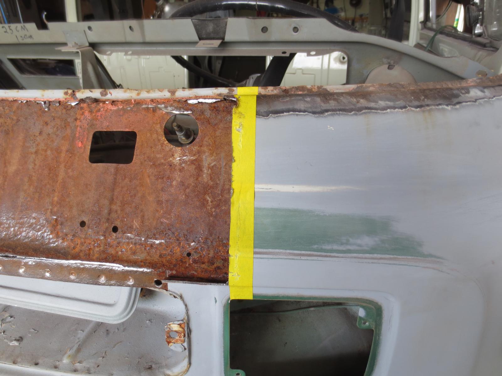

PostPosted: Fri Sep 09, 2016 8:02 am    Post subject: Re: 74 bay window campmobile rocker rust,corner rust Reply with quote
Did a little more welding and cleaned some of the filler from the front,under the blue paint there is a rubberize coating that can't be sanded off,so scraping and cleaning with acetone is what I have been doing,also welded up the holes from the tire mount and the emblem

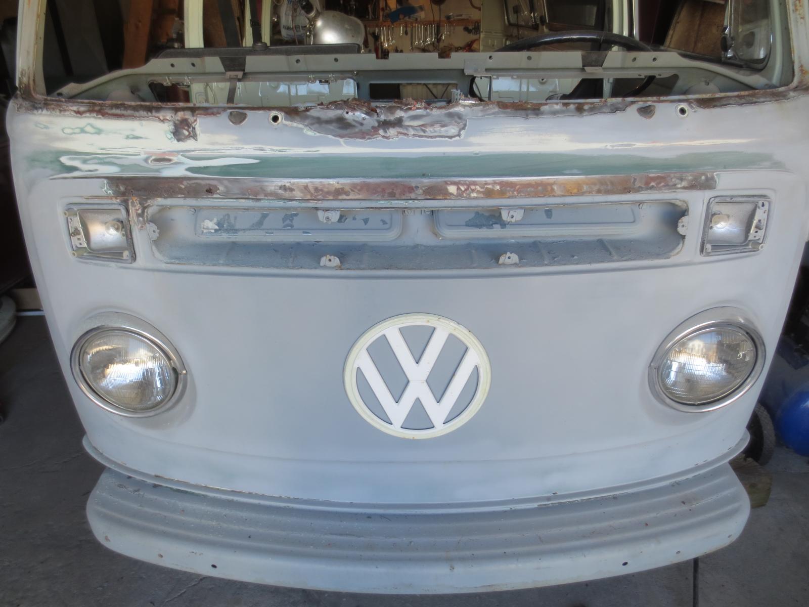

lil-jinx is offline
PostPosted: Fri Oct 07, 2016 12:54 pm    Post subject: Re: 74 bay window campmobile rocker rust,corner rust Reply with quote
Got the nose cleaned up,applied 2 coats of rust mort using a scouring pad,get another coat tonight then washed,cleaned and a coat of epoxy primer.Then to work my way back along the right side finishing to primer,then "maybe"get the engine squared away for install,and "Maybe get it driving for next summer,and work away at the left side,I have the sheet metal for the left side.then "MAYBE" get a coat of paint on it.
That's a lot of maybe's but it's all for fun,I have never sat in a running bus.so maybe someday I will.

PostPosted: Fri Oct 07, 2016 1:13 pm    Post subject: Re: 74 bay window campmobile rocker rust,corner rust Reply with quote
Looks like it is coming along well. Good job.

PostPosted: Thu Oct 13, 2016 7:07 am    Post subject: Re: 74 bay window campmobile rocker rust,corner rust Reply with quote
Sprayed front with proform epoxy primer,used a small k3 spray gun,not much bigger then a air brush,but it did the trick,seemed to work well for small areas,pattern about the same as a rattle can.looks much the same as it did before i touched it,but now i know what it is and it's rust and filler free.
I cleaned it with dawn then rubbed it down with rust mort several times with a 3-m red pad ,then 2 days later washed it down with dawn again and another pad then sprayed and wiped it with acetone,then epoxy primer,hope that works to keep the rust away.I used a heat gun to dry it after each dawn wash to help with the flash rust.
