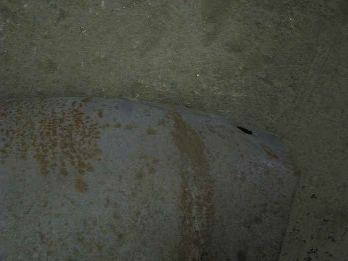

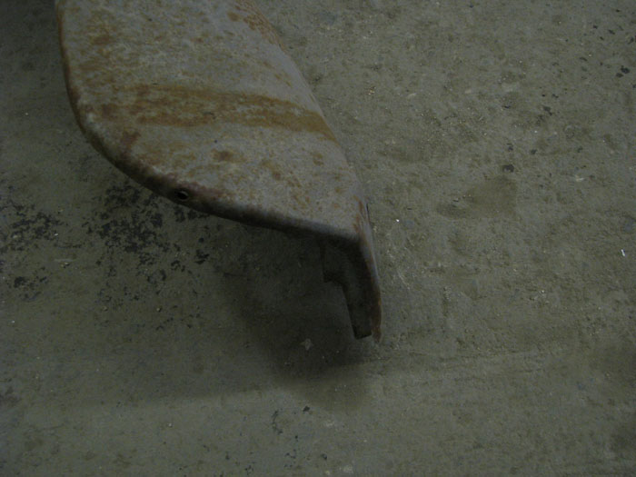

The following is an attempt at creating a comprehensive guide to fender changes year by year for Beetles from '58-'67.
Contributions are requested and encouraged. The only requirement is that the fenders pictured must be KNOWN ORIGINALS to a car with a known production date (month year is probably fine). Fenders didn't necessarily change with the model year, so I'll try to keep a tab of when the actual changes occurred by month.
There are a few angles and a measurement that seem to pretty much cover the differences between the fenders, and they'll be pretty obvious below. The measurement of interest is across the width of the fender. In order to keep things on the same page, measure from the top-most bolt hole 90 degrees across the top of the fender along the curve to the bottom of the curve at the outside of the of the fender. Not where the metal ends, the bottom of where the metal is curved over at the outside of the fender.
As people post photos, I'll put them up here in the first post in chronological order.
'58-'59 (same)
300mm
July '58

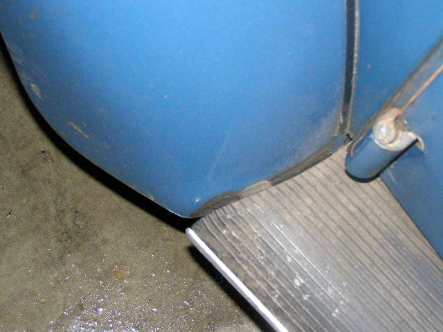

These photos show the flare where the fender meets the running board (far more pronounced than later years).
July '58
July '58
July '58
This photo is also of interest as it shows the wire tube special to '58-'59 fenders.
June '59
June '59
The fender flare is gone by this point.
June '59
June '59
Other '58-'59 photos just in case some of the above left any questions:

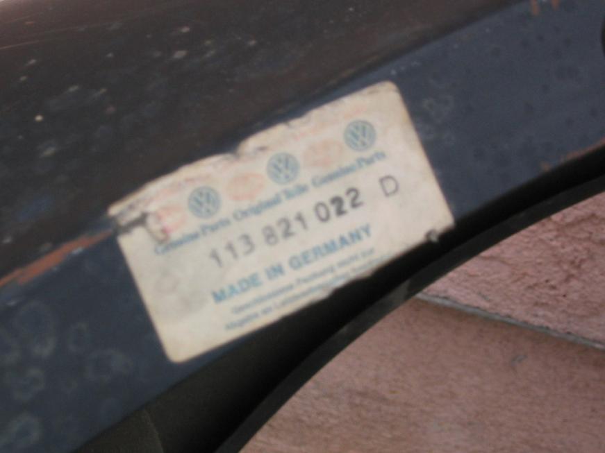

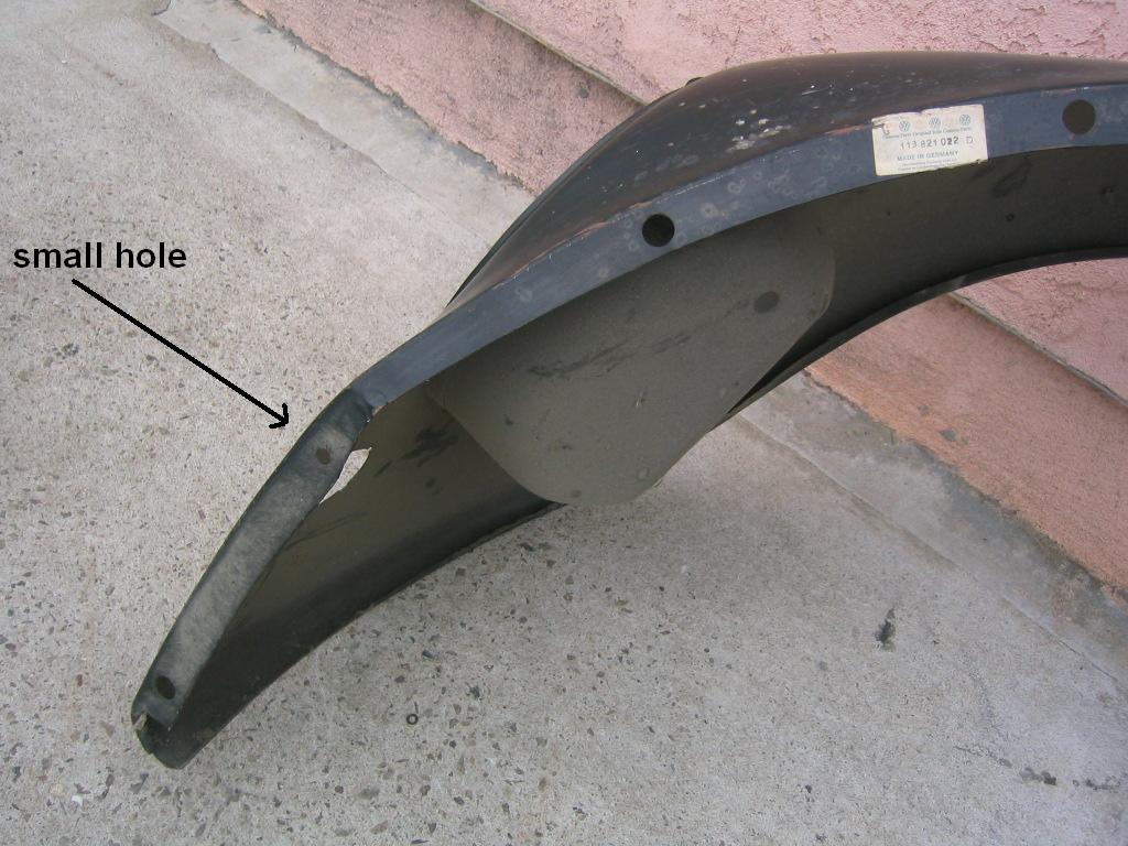

I've got a set (2 fronts, 2 rears) of NOS German VW fenders. Here's a few details to identify them.
Fronts:
Rears:

Trying to resurrect this thread. I need a replacement fender for my '61. I thought I had one in my garage, but come to find out, the turn signal holes are placed way too far back from the front edge of the headlight bucket, so it doesn't match the original still on the car. It seems from what I've learned so far, that this dimension may have changed in the '63-'65 timeframe? '62?? Anyone have any ideas on this? I'm thinking mine from '61 is pretty close to a '59 or '60.
zerotofifty
Joined: December 27, 2003
Posts: 3755
zerotofifty is offline
PostPosted: Mon Jan 20, 2025 9:56 pm    Post subject: Re: Comprehensive Fender Guide Reply with quote
The fenders with the " made in germany " decal are from post germany east west unification. prior to that time the decal should indicate made in west germany. circa 1990 on up
