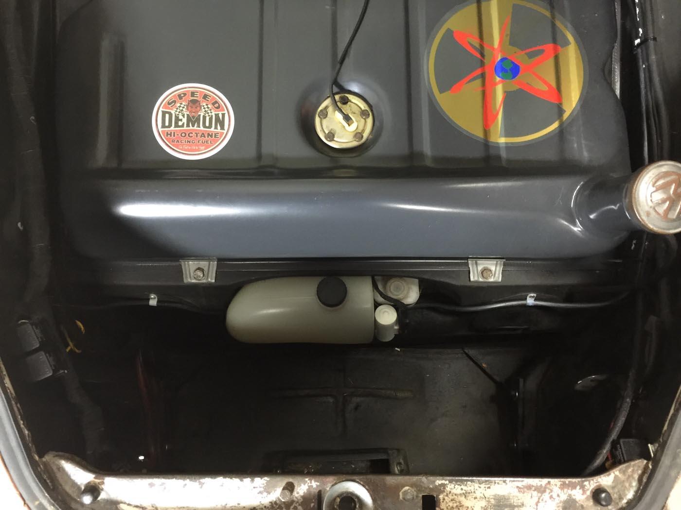

It's a wrap!
Received the repro washer tank and pump, and got it installed. It works great! It's really wonderful to have washers as I live in Oregon.
The casting was rough on the inside under the cap, so I bore it out with files so I could get a funnel for filling easily in the opening. The hose they provided with the kit was clear fish tank kinda tubing, collapsed and bent forever. Came with a switch that kinda looked stock, with a black knob - but a separate momentary switch for the washer? No thank you. No leaks - and it mounted up easily in the stock soft mounts.
I purchased windshield washer hose from Mid America Motor Works - and dammit if they didn't send (3) 1 meter pieces when I thought I would receive (1) 9' piece. <sigh> Luckily I had a tube splice in my box of doodads.

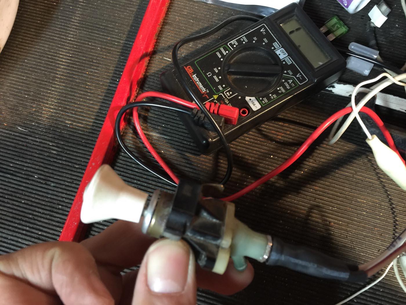

The big part was the wiper wash switch conversion to electric. Doris did a really amazing job, and I copied her ideas, except with the older ghia switch.
http://www.thesamba.com/vw/forum/viewtopic.php?t=484192
Here's some pics:
The original switch:
The revised switch with the electric momentary switch installed.
Here's a continuity test. I wired it with the ground.
