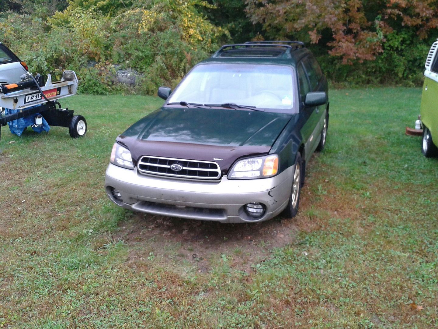

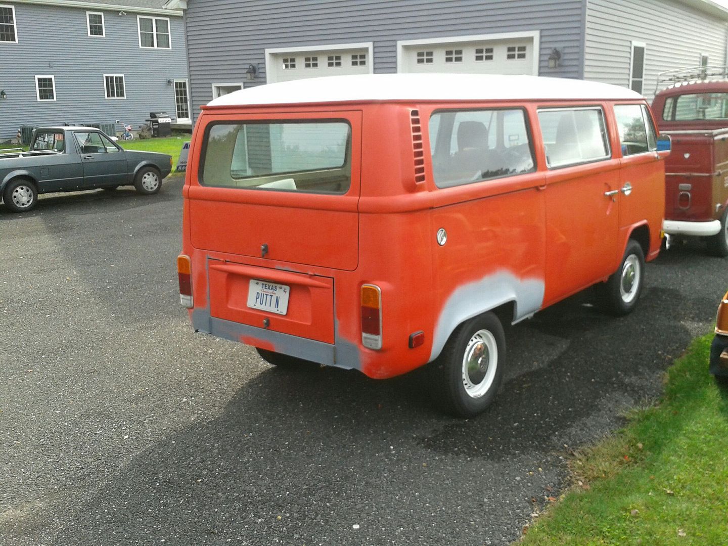

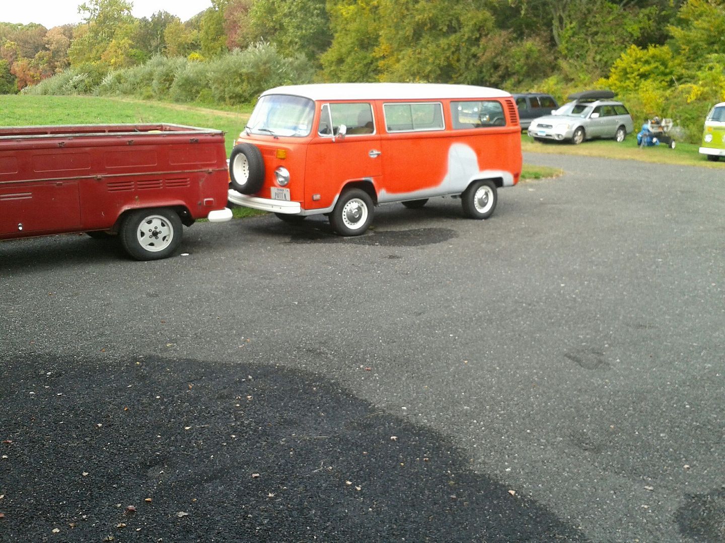

so in an effort to convert every late model shitbox T4 into Subaru power, I had a guy contact me from Texas to do a conversion for him Shocked
I thought he was kidding, till this amazing CE turned up here. I just can't believe how stupid clean this bus is....you southern folks have it made
he was even nice enough to bring me a clean slate!
meet the donor:
she is a bit worn out
so, we are doing soup to nuts new engine etc etc and she should be even more epic than my deluxe!

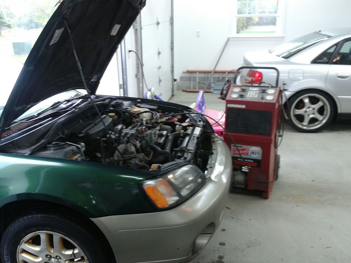

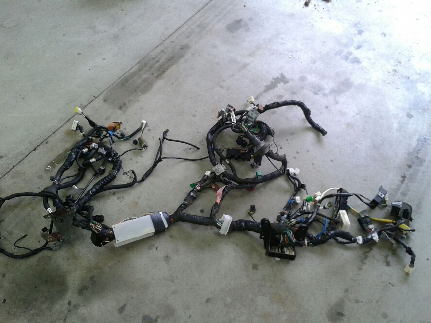

todays mission was to harvest the harness. first step is to recover the refrigerant from the a/c system

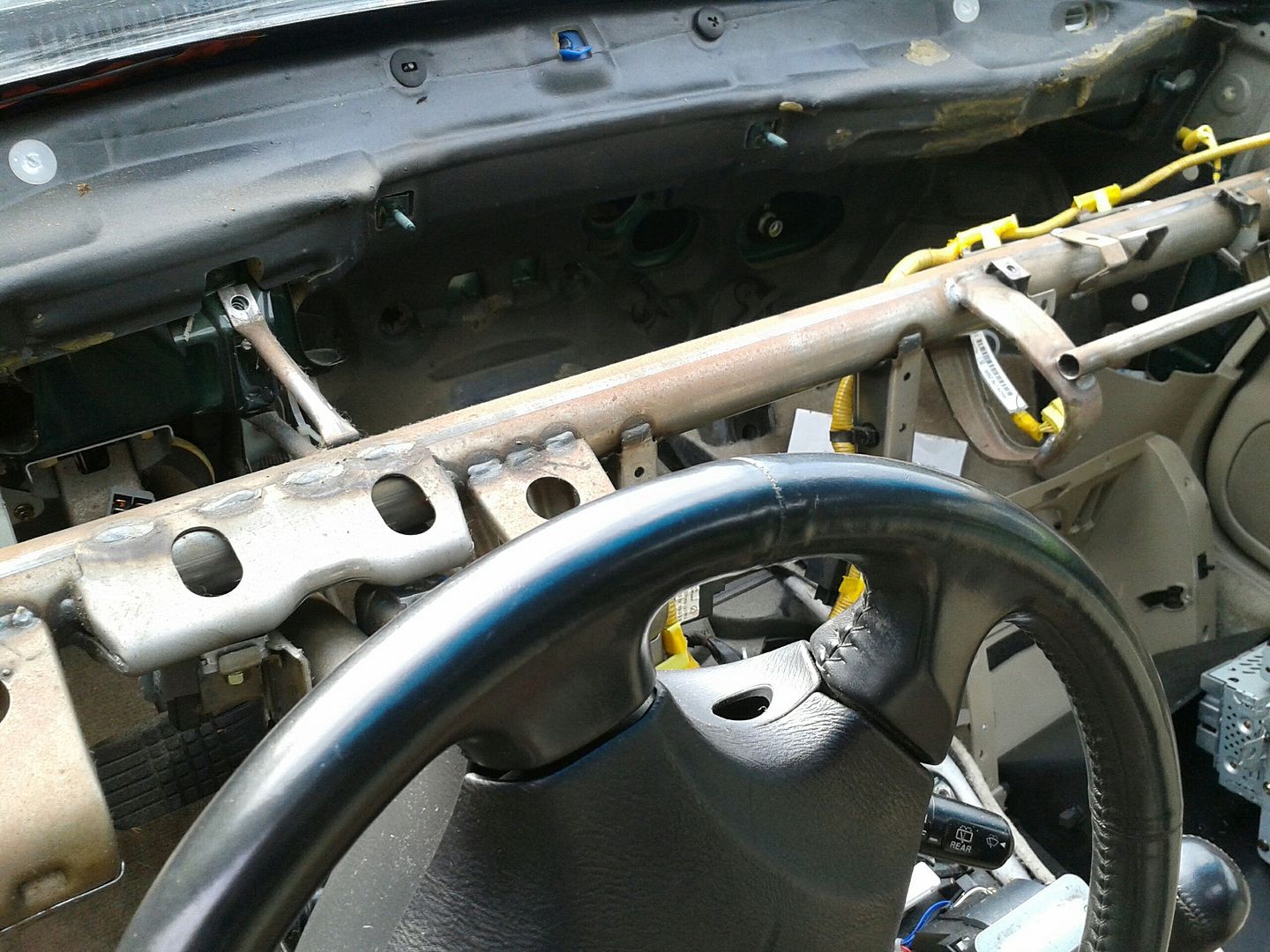

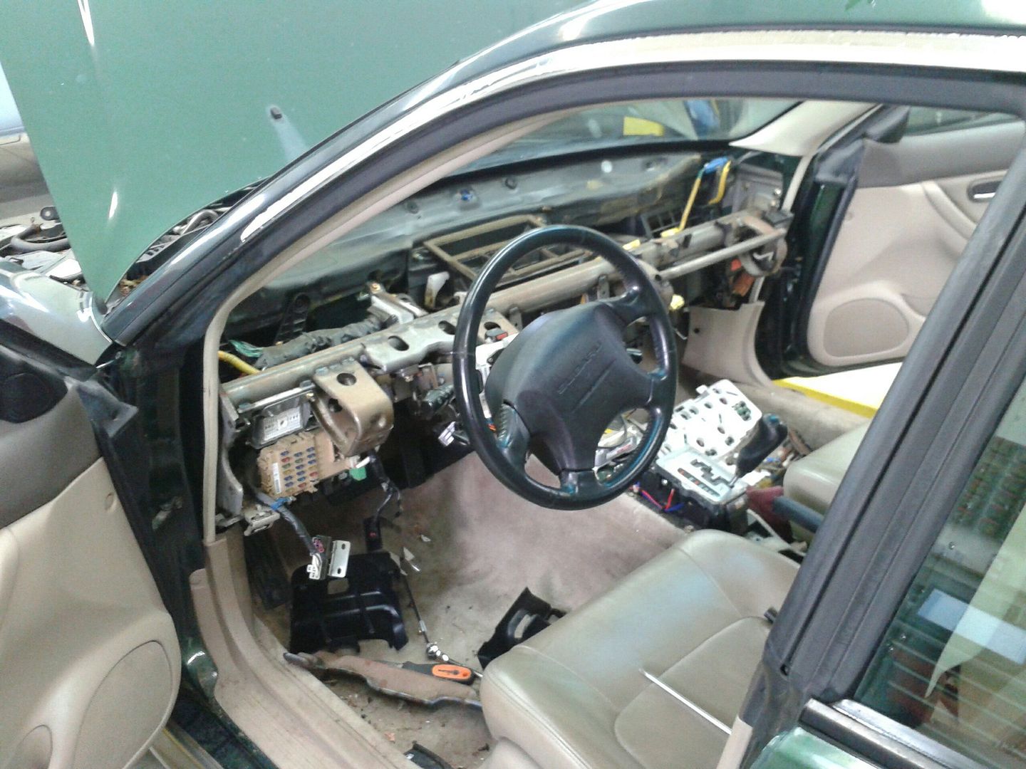

then, off to the races...pull the dash. uggg...it just takes forever and I'm fat and stupid. for a fat stupid guy I can fold up like a jack knife. (that video later)
after a while, you have this
after a while longer, you have this
and after a whole lot longer, you pull the python out
then, you beat the thing into submission and cram it into a box
and ship that box off to this guy
http://www.thesamba.com/vw/classifieds/detail.php?id=1388977
jeff has done a few harnesses for me. worth EVERY penny. his work is 100% top notch

PostPosted: Tue Oct 13, 2015 5:28 pm    Post subject: Reply with quote
Tcash wrote:
So does Jeff reprogram the ecu?
Tcash
no. he just cuts down the harness and tricks the ECU into thinking components are there with the stimulator.
you will get "nuisance" codes so if you want to keep the CEL off it will take a load of extra work. for example, my blue bus has codes for catalyst efficiency below threshold and NPS out of range. neither are an issue with drivability or economy
I could fart around with a NPS and add a catalytic converter but not worth it imho. the thing runs 200x cleaner than it would have in 1970 anyway
