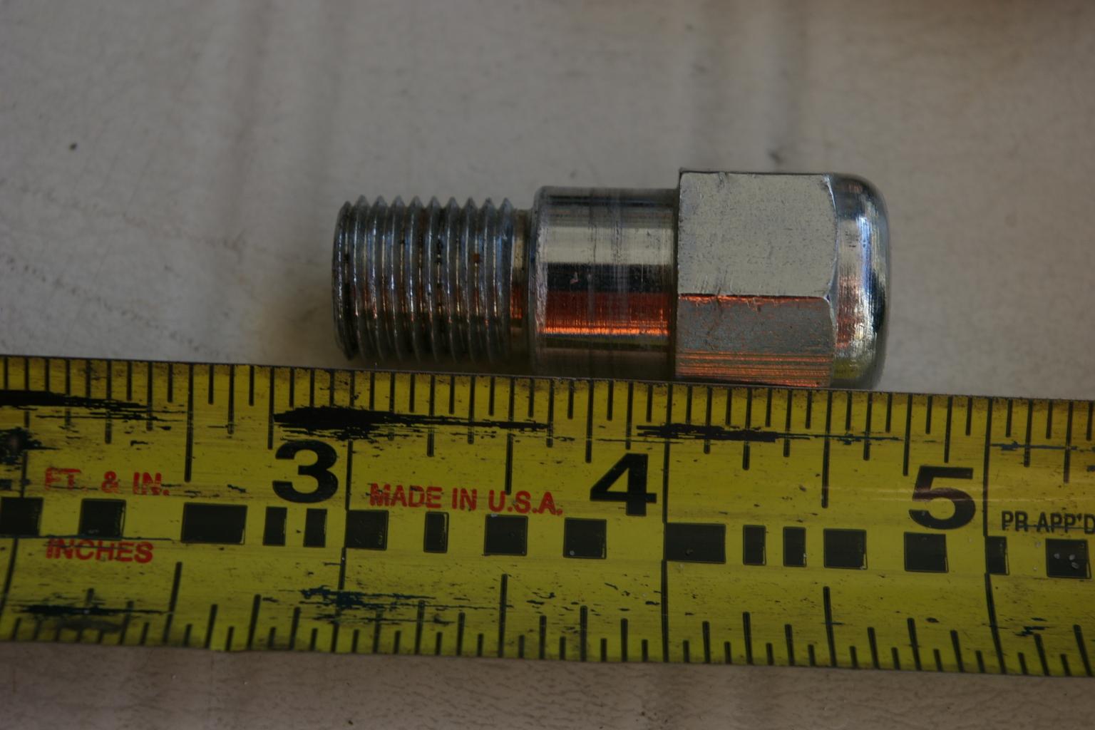

Finding the Originals is Unobtainable, very "Hard to Find" ...
This is what I used as an option for mounting FV Superior VolksMag Wheels : aka Turtlebacks.
*NOTE : Shoulder of Mag Lugs MUST be snug fit to holes, if NOT, Centering of Wheels to Rotors & Drums may not be achieved, they Will be off center.
Mag Wheel Lug Holes may need to be drilled for this application.
Stud Kit, Mag Wheel Lug Nuts, Mag Flat Washers.
Loctite (Heavy Grade, Red) Stud into Mag Lug Nut (Let set-up overnight) install Washer, Mount Wheel, Tighten.
This is what I used for the Volksmag Wheels application.

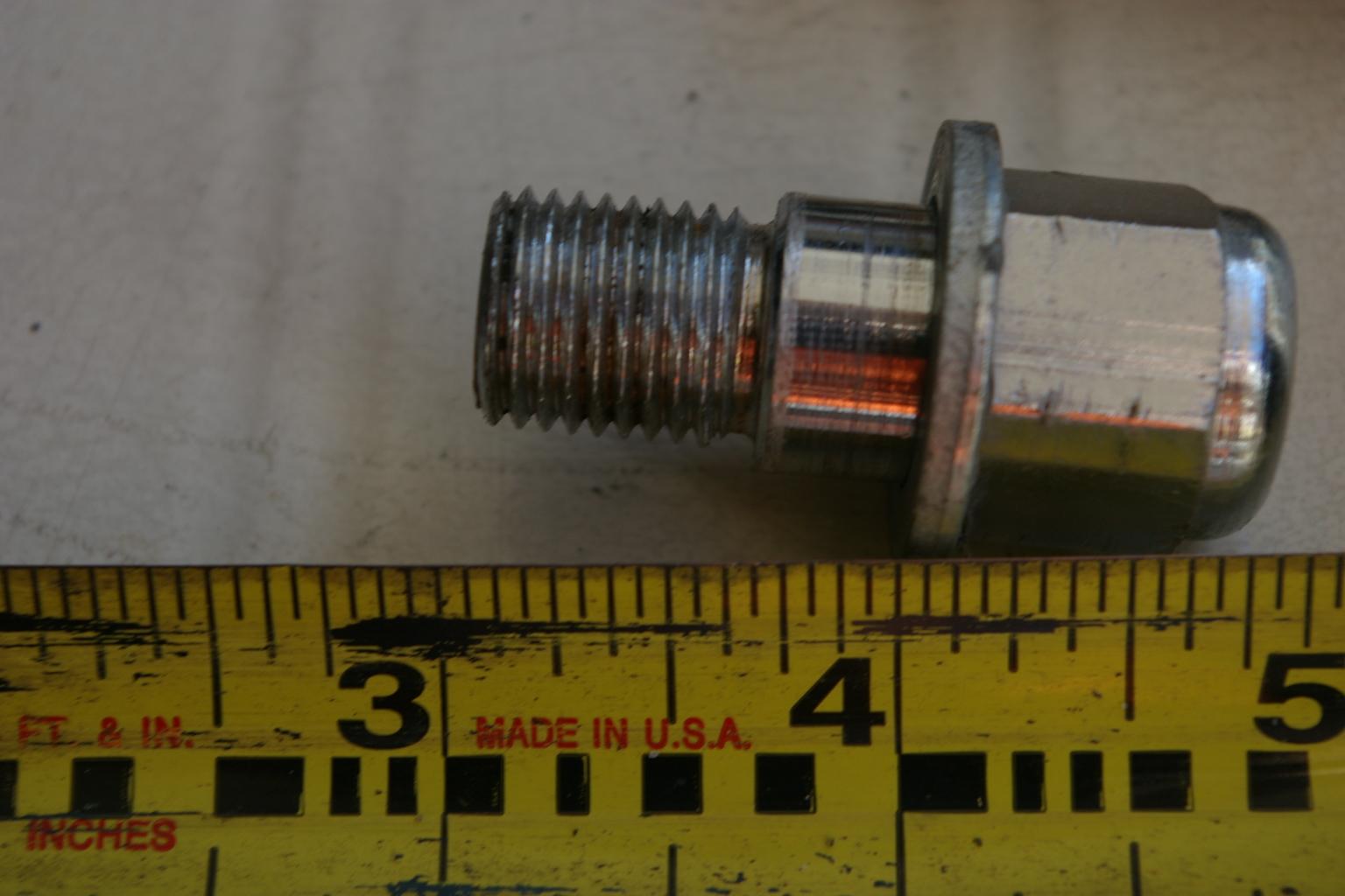

This is what the Original Lugs look like.

i have a set of original lugs and 4 locking...pm...if i can help

PostPosted: Thu Jan 14, 2016 11:43 am    Post subject: Re: Superior turtleback lugs Reply with quote
original Superior Turtleback lugs and locking lugs
