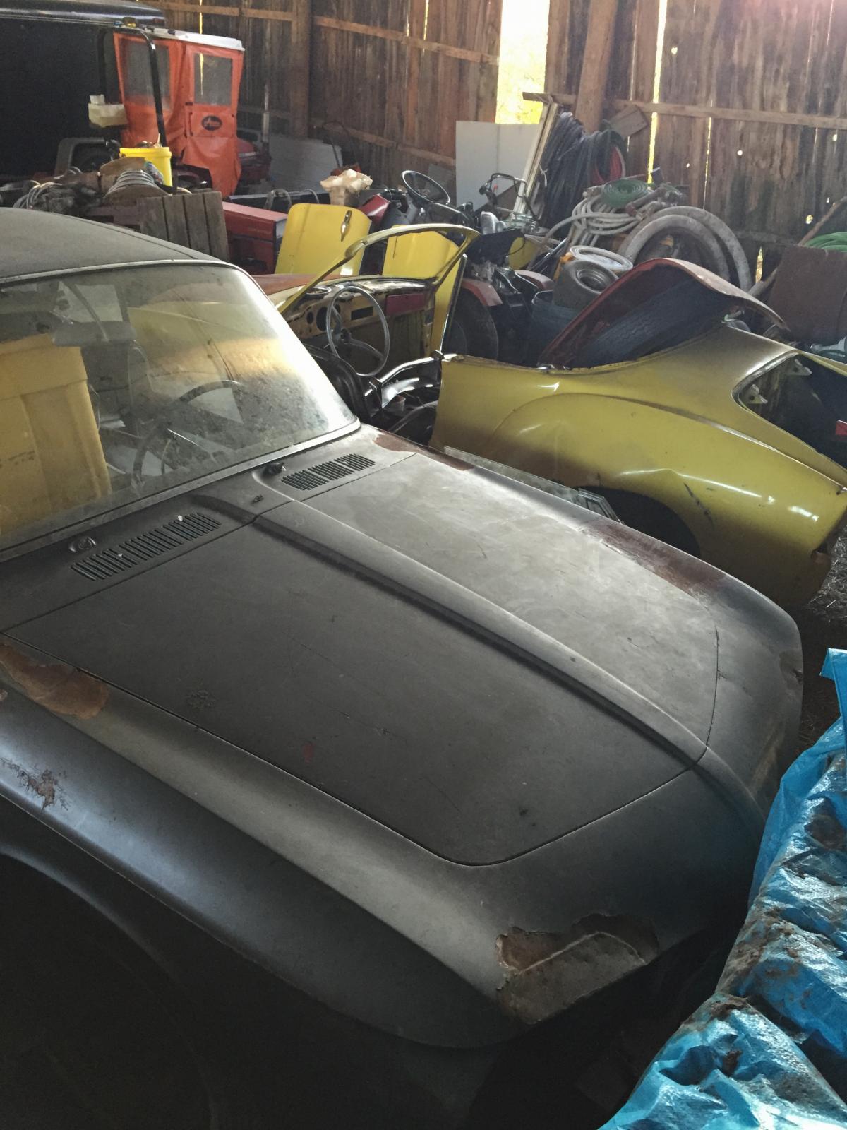

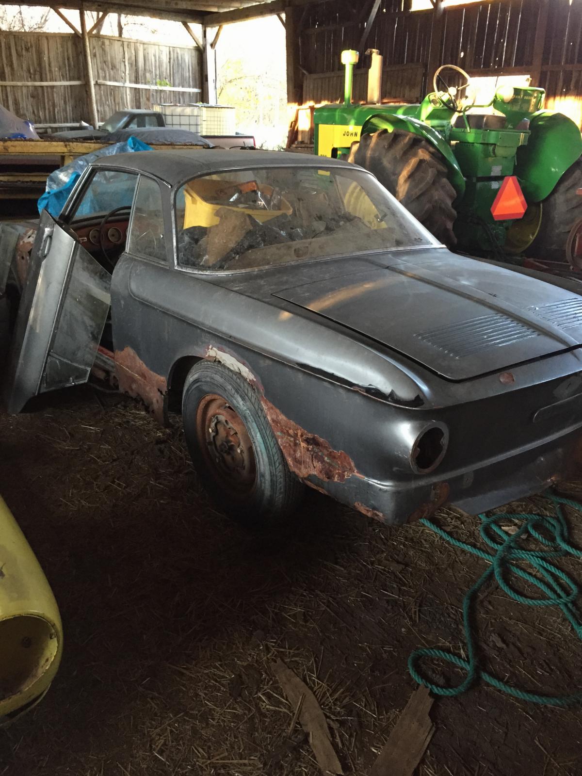

Greeting.
I recently came across a Type 34. It was advertised as a '65 but it is not. At least the body is not. Perhaps the chassis is.
I have located the serial on the chassis, at the rear part of the tunnel; however, I cannot find the body plate. I think it has been removed at some point. The only number I can find in that area is a "3179" near where the plate used to be.
I have not confirmed the engine serial as I have not had time.
This car needs serious work. I have even hesitated whether to chop it up and part it out (normally anathema to me!) or fix it. I want to fix it.
I am not afraid to spend money on it. I think in 10 or twenty years, these cars will find fetch high prices.
That said, the body is rough. I purchased the car from a wonderful guy who loves his VWs. He is currently working on restoring a Thing.
Here a few pics for the curious. I know I can quadruple my investment just parting it out.... or swallow about $15,000 by rebuilding it; yet the latter still appeals to me tremendously.
Any thoughts would be greatly appreciated.

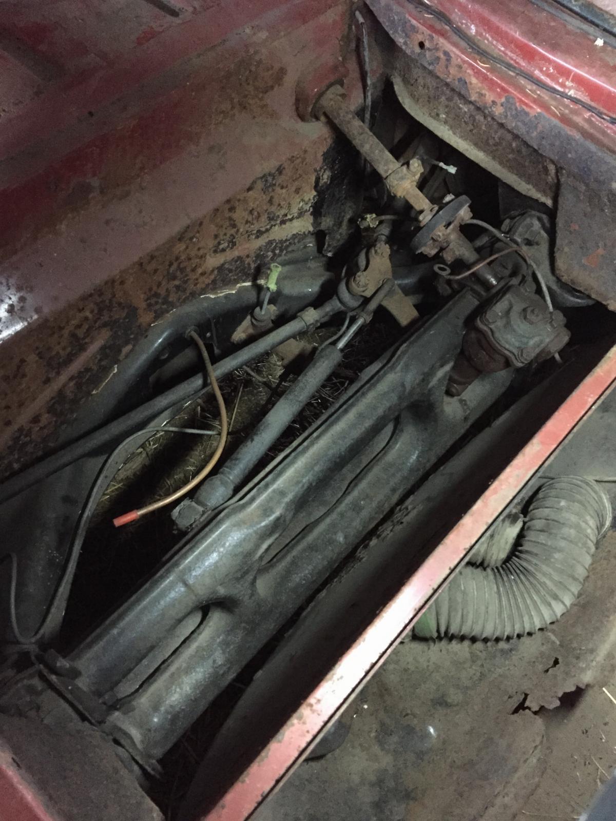

The latter picture above is about where the original vin plate used to be (in the front quite hear the fuel filler tube.
A few more pictures.

The PO had the body off. New pan definitely as well as new or reconditioned beam from what I can see. There are lots of newish parts (lots of black paint or POR-15) in the rear area too.
I think he got the pan/chassis in good shape and then put the body on and sort lost the enthusiasm. PO told me had it for about ten years, and stored for almost all of that.

I think what I am after is some feedback on whether to ditch this project of get on with it.
The good thing is that both lids are very solid and rust free. The doors are also rust free.
All the glass is there and seems in good shape. Even the chrome around the windows is all there and relatively good shape.
The dash is all there and seems to function.
Engine/tranny are there. I have to check numbers to see if engine matches the chassis.
The guy provided me with 3 bumpers. Two for Type 34 and one for Type 14 (I think).
The bad....
The body from about 6 up from the pan.

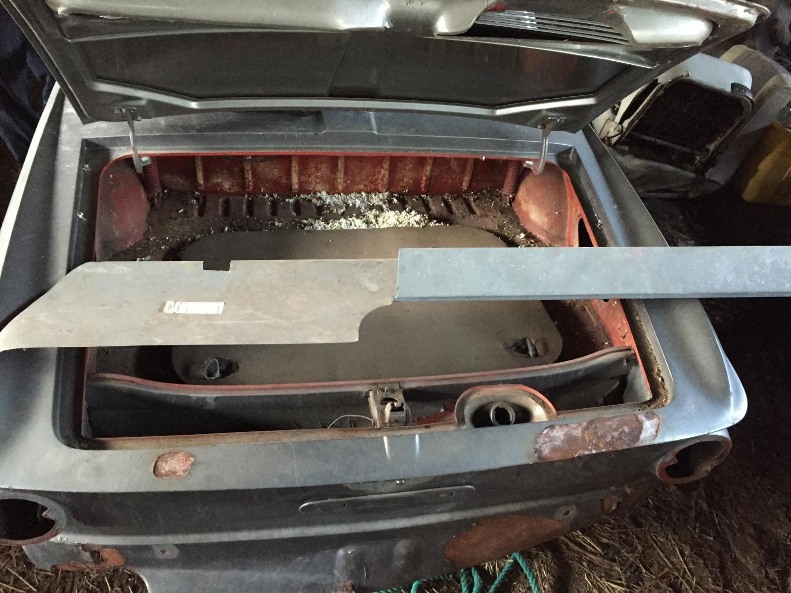

The car did come with some newish rocker panels but I am not sure they are meant for this car or a Type 14 Ghia.... any one id the parts for me? (see pic)

I have seen people start with a lot less and worse.
Does it have a vinyl top? I haven't seen that before on a Type 34. Interesting look.

From the part sticker on the rocker panels, I would say they are Type 14 since the Type 34s were only made from 62-69.

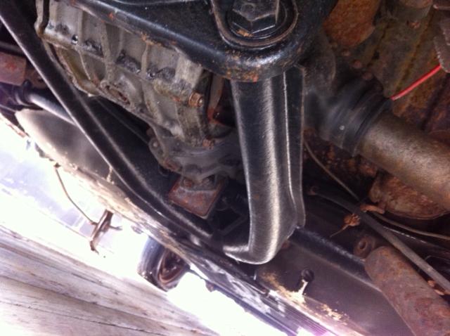

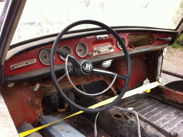

Some pics of the dash.... and one shot of the bottom of the car.

Replacement rocker panels- http://www.thesamba.com/vw/classifieds/detail.php?id=1721001.

Dual horns were before 1965. Pushbutton windshield washer is early too.

That's an early car for sure as the fresh air slides on the dash are a key indicater. Rust is less of an issue than missing parts and accident damage. Most of the body parts you need are available and the rest can be found or fabbed. Whatever you do, do not throw anything away! I say go for it as your assessment of value is correct. 15k into an early car to bring it back to great condition is still a winning proposition. Check under the rear seat to find the vin # on the pan

It does appear to be a '62 from several telltale details -- the fresh air levers on the dash as Jack mentioned, two-piece window trim on the windshield and rear window, the inner sheet metal around the rear decklid, etc. The seats appear to be '63 or later though -- that might be an issue because '62s had unique seat tracks. The vinyl roof is not original.
It's rough for sure but nothing's impossible, especially if you have fabrication and welding skills. That said, if in the end you do end up parting it let me know. I also have a '62 and there are a few things i could use.

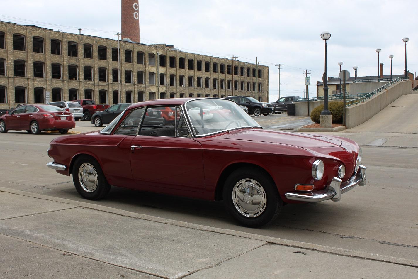

After a couple years (or more depending on time and luck) you can go from this
to this
