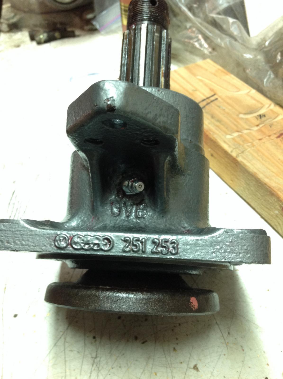

I added grease fittings to my rear hubs,
With the hub off and clamped in a vise, I slip in an Impact socket to fill the axle shaft cavity and pump the unit full of grease. It oozes through the bearings chasing out the old grease.
Or just use the axle itself.
Honestly? It's a horrid mess but the end result is fully lubed bearings.

Terry Kay
Banned
Joined: June 22, 2003
Posts: 13331
Terry Kay is offline
PostPosted: Fri Nov 06, 2015 8:30 am    Post subject: Reply with quote
Maybe, Maybe not with a grease gun & a needle.
But I do know that this zerk most certainly will get grease to both bearings pretty easy.
T.K.
Sodo
Joined: July 06, 2007
Posts: 10789
Location: Western WA
Sodo is offline
PostPosted: Fri Nov 06, 2015 12:15 pm    Post subject: Reply with quote
I like that method. A guy could grease that every 100,000 and you'dbe golden. Greasing the bearings every 30 or 50 or even 100 without disassembly is very interesting though.
