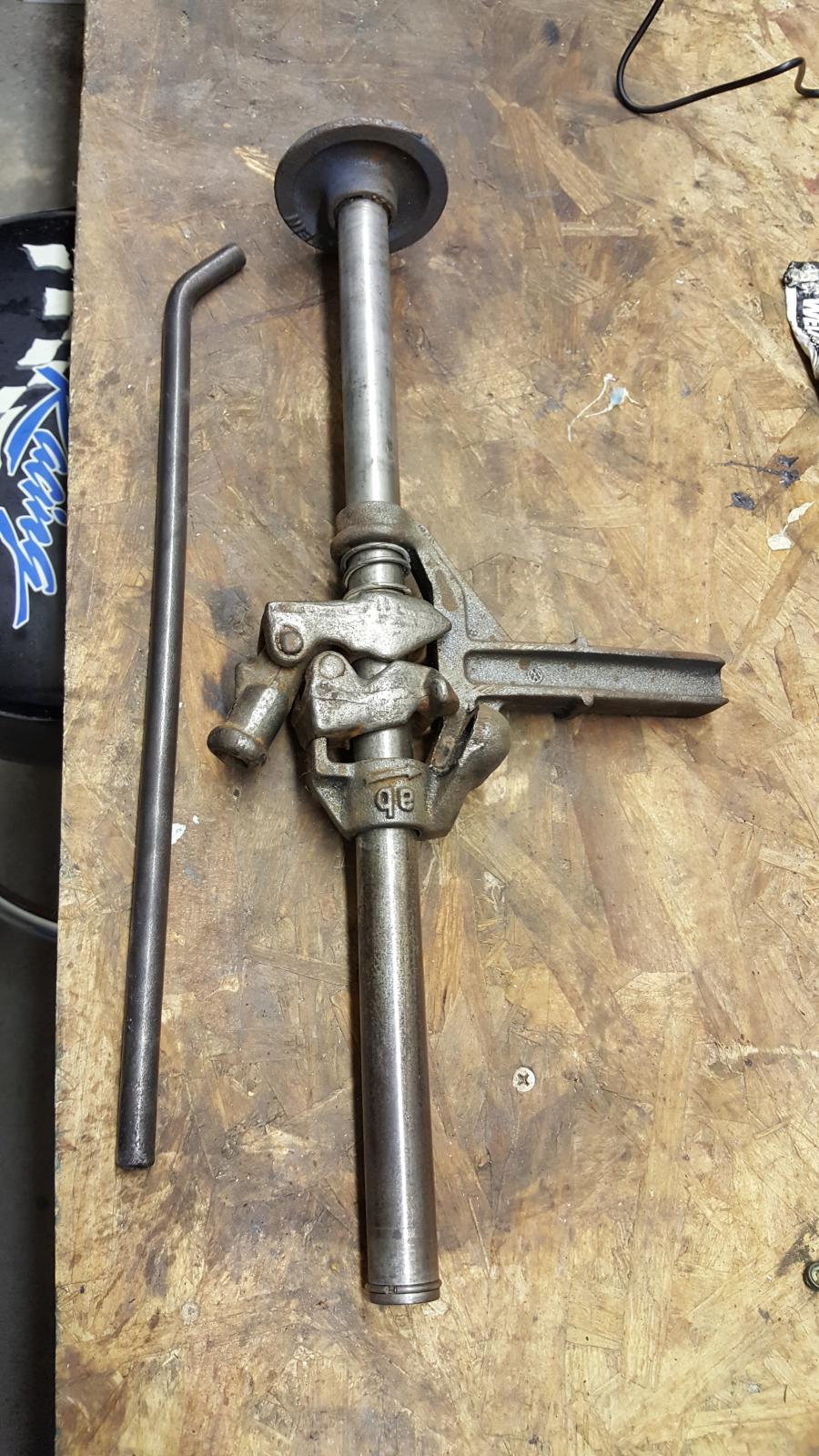

Thanks Roach, this is all good info I'll need when I'm ready. Besides some spot filling and sanding, haven't done too much. Cleaned up the jack and painted.

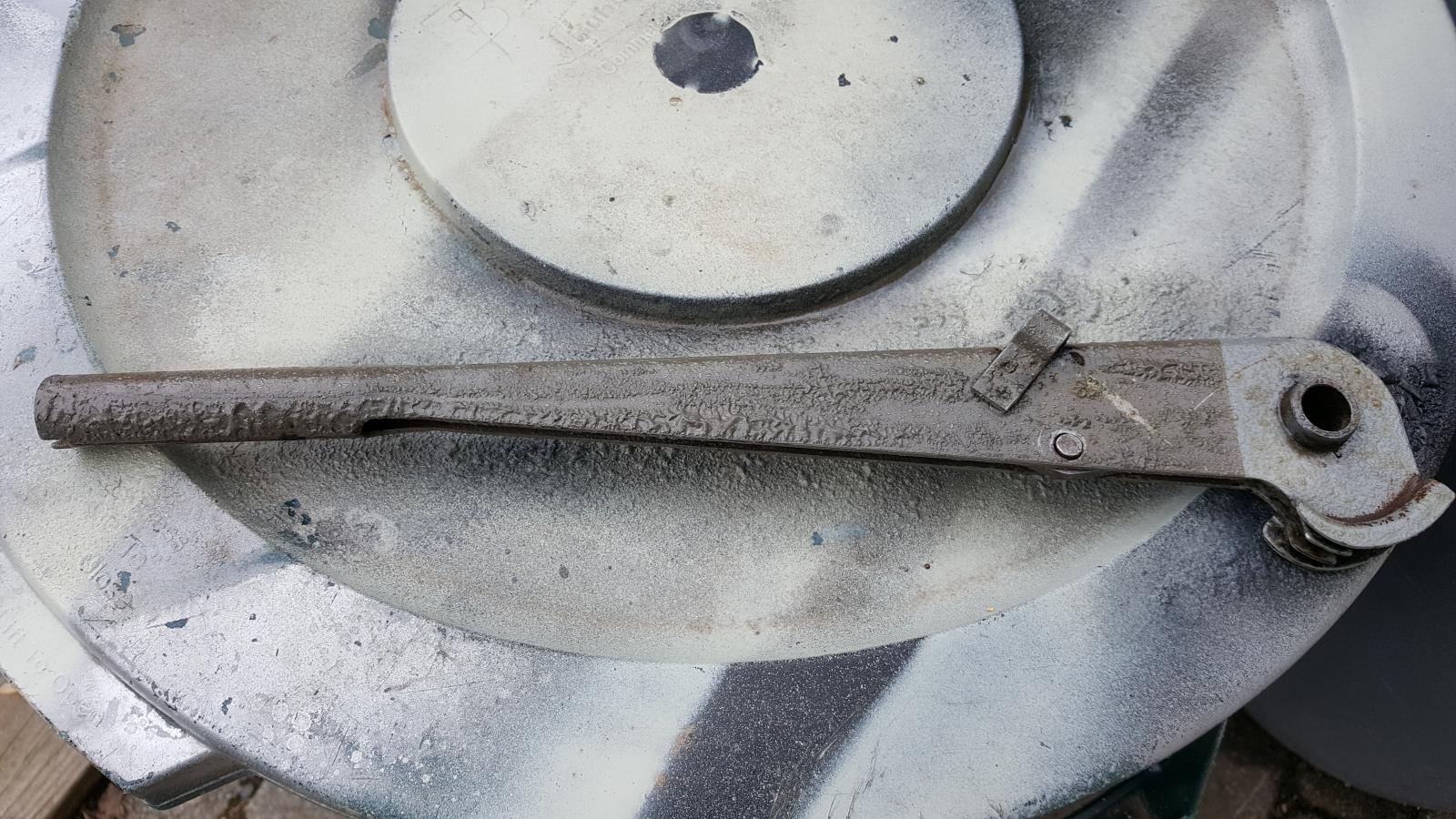

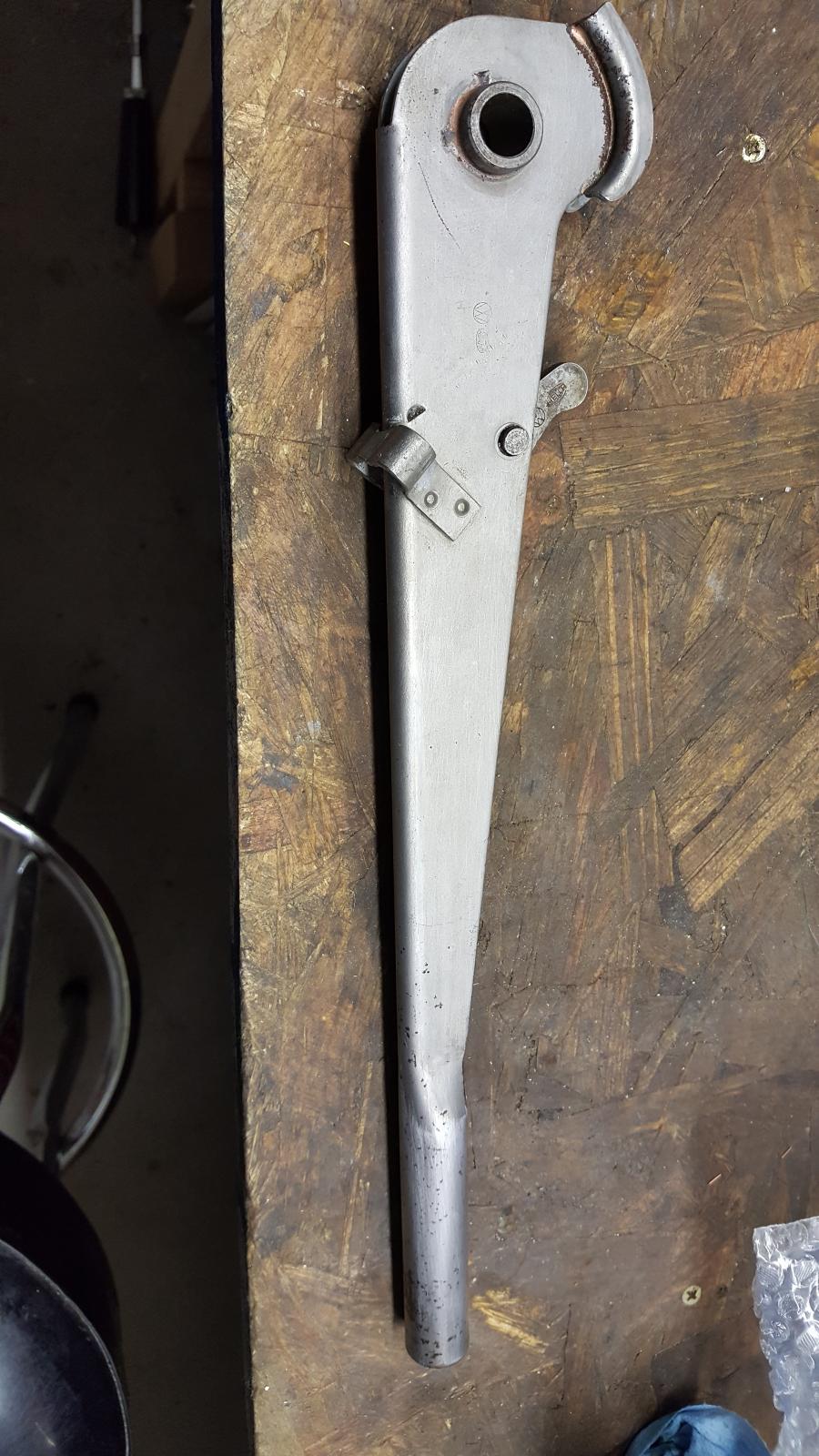

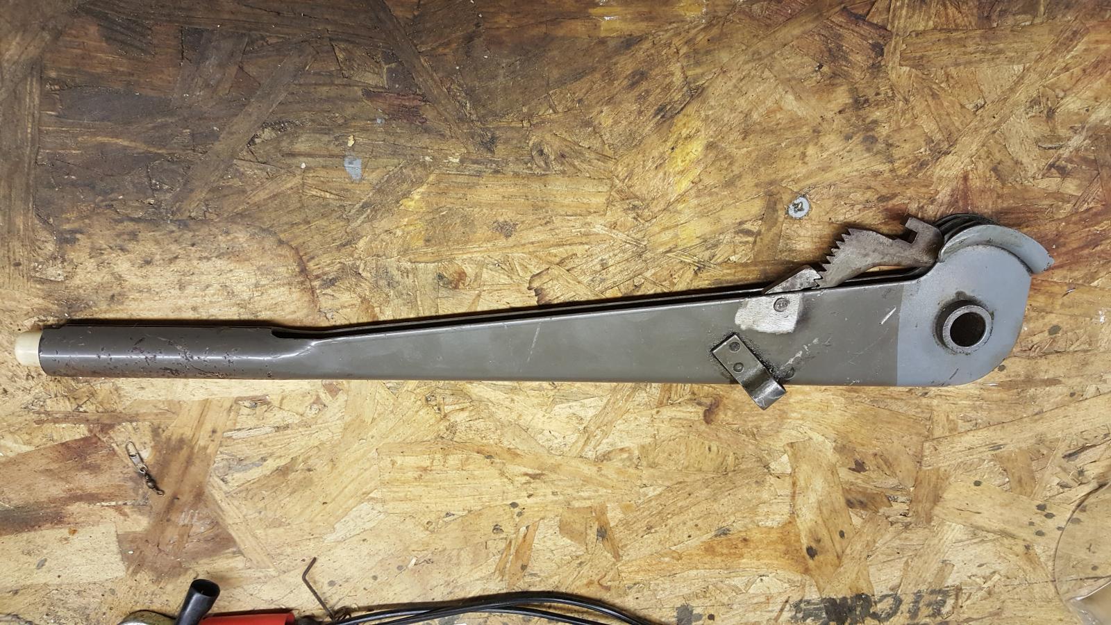

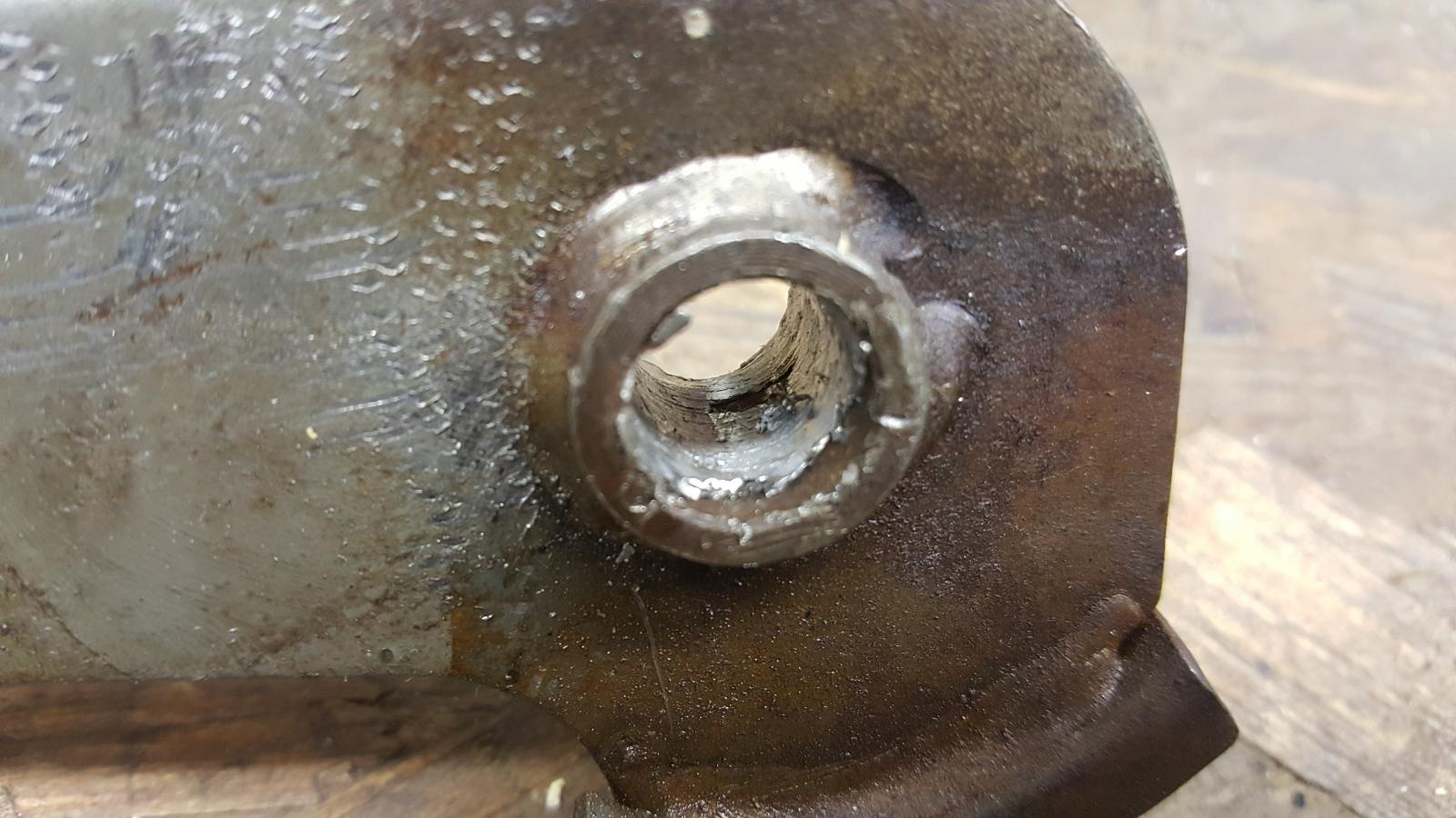

Also tried getting the E-brake out to paint it, even after soaking a few times, pin was frozen in. Had to drill it out, pita.
Had a better E-brake to use. Had to swap the teeth piece from the og one b/c these were worn out.
Started to strip the paint

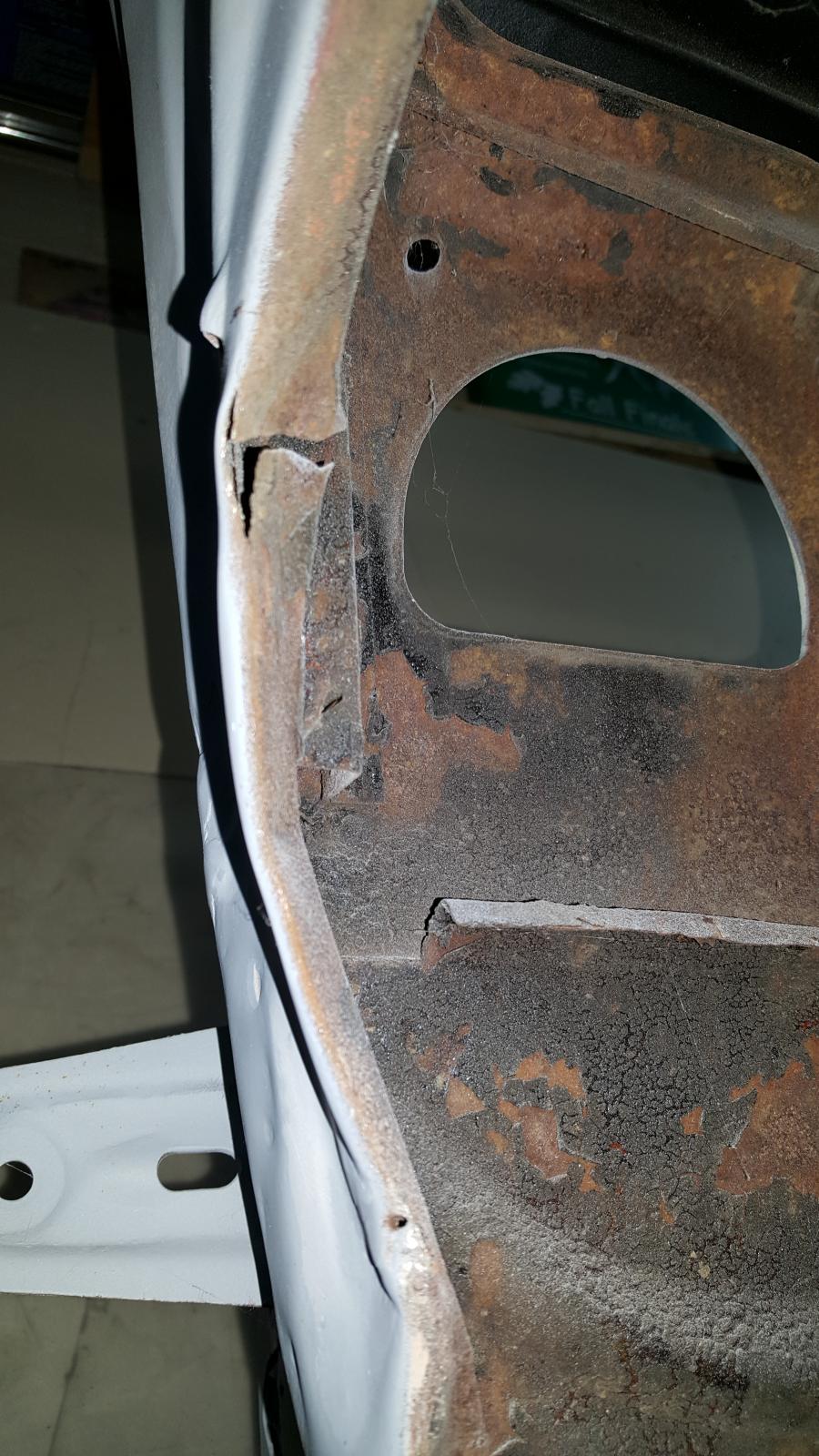

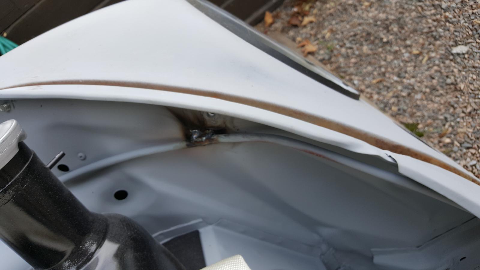

Also had to fill a rust hole under the hood cowl.

PostPosted: Tue Jul 25, 2017 7:00 am    Post subject: Re: Rob's '63 Rag thread Reply with quote

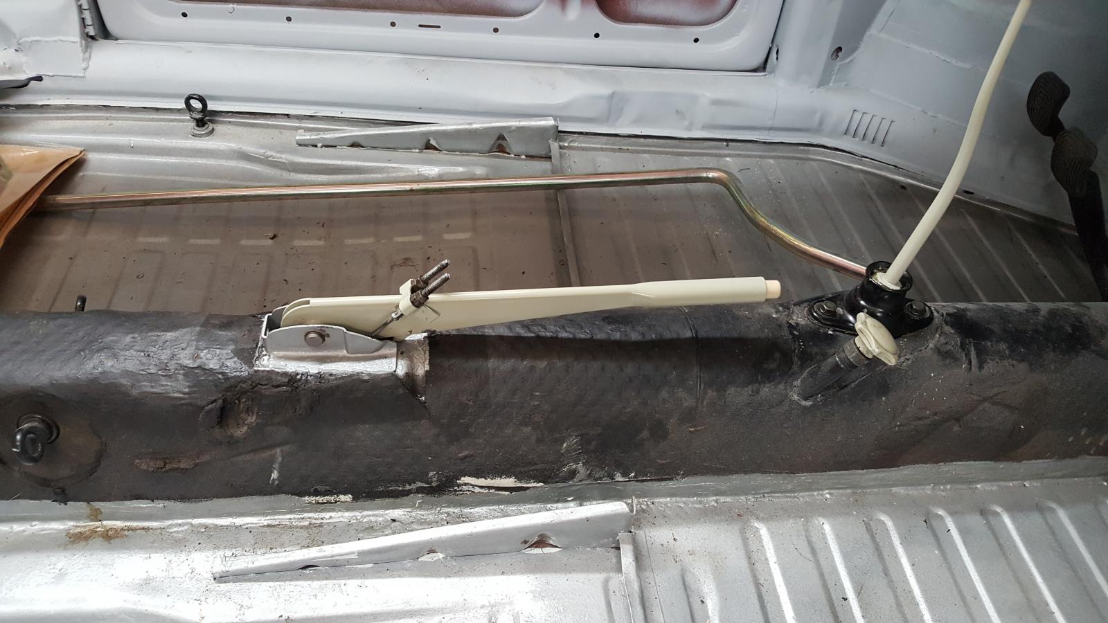

Painted the shifter again, this time silver beige.
E-brake fully stripped, primed and painted

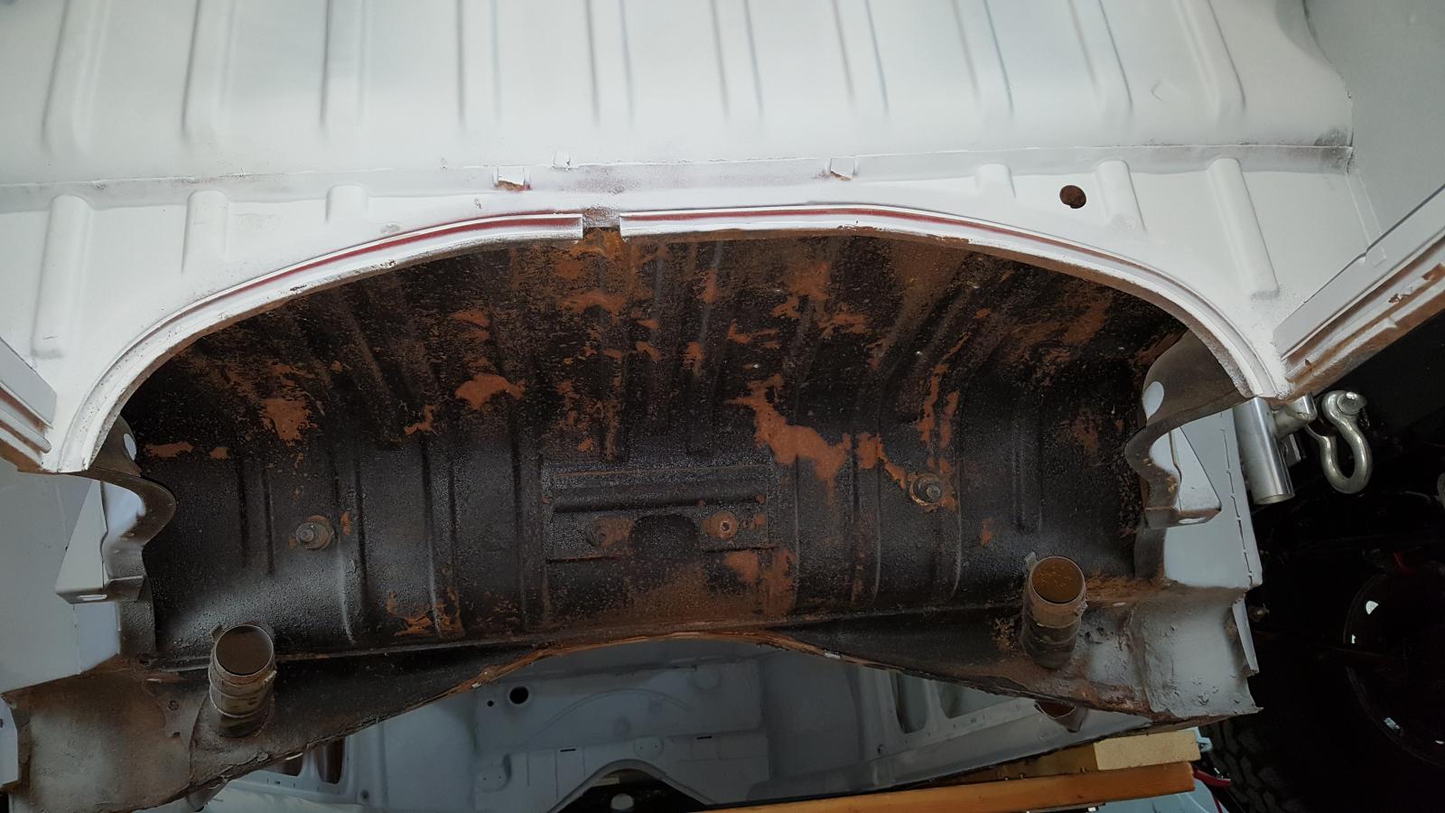

Getting back at it again. Pulled the body off again, made new dolly.
Going to de-scale the bottom sides of the bug, fix a crack in the front and hit it with undercoat.

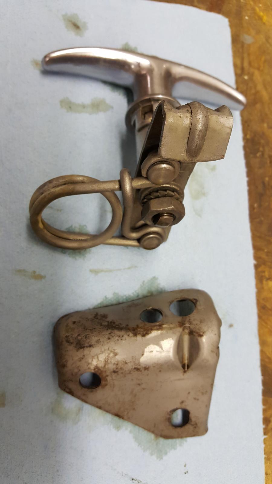

Let the T handle and horn bracket soak for a couple months, came out clean.

The T handle did you soak it in the Zep cleaner?
Yea I use the Zep Industrial Purple straight, stuff is pretty strong.

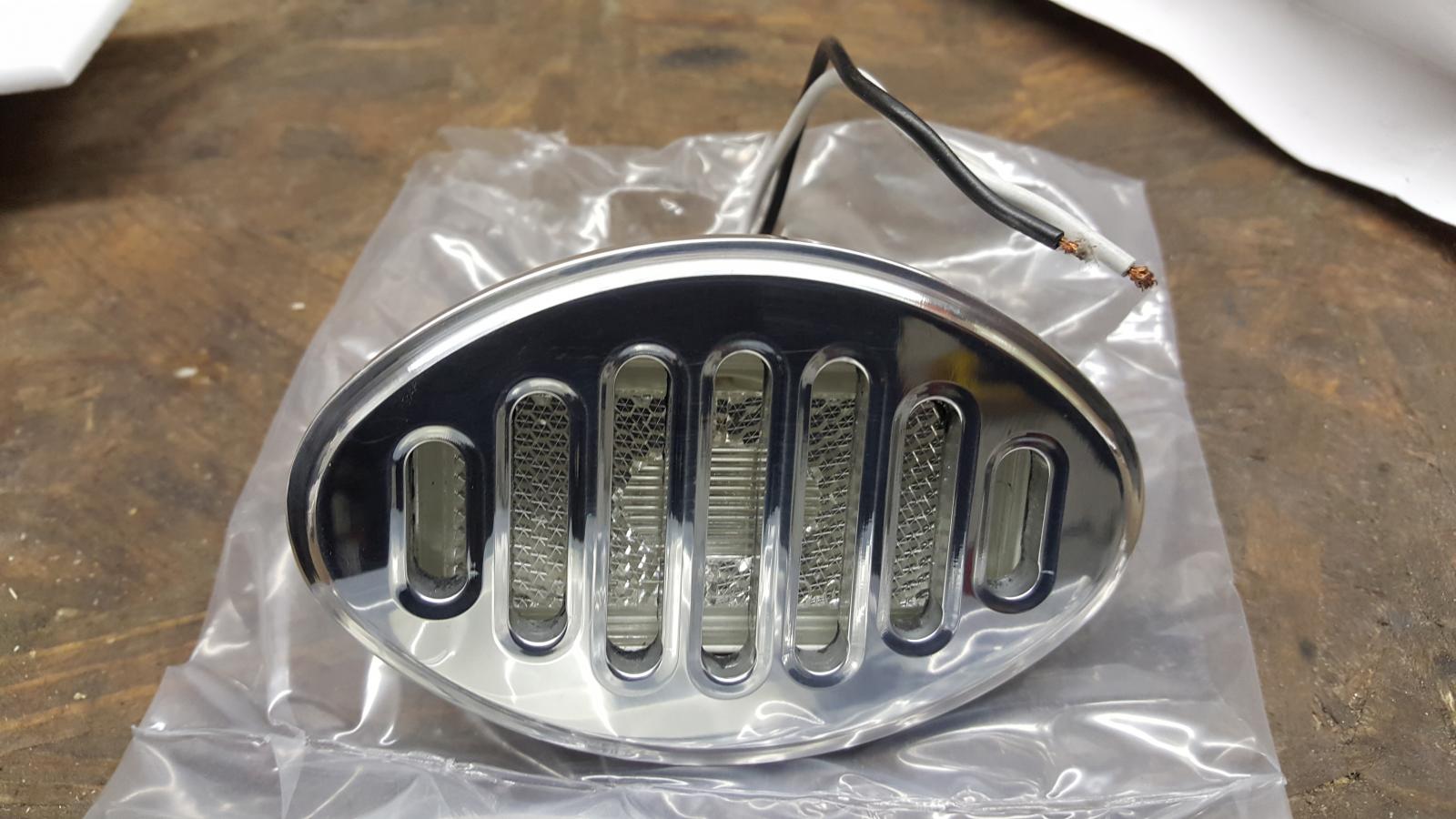

I got these billet horn grill lights. Going to try to make them dual filament with a different plug and 7443 bulbs.

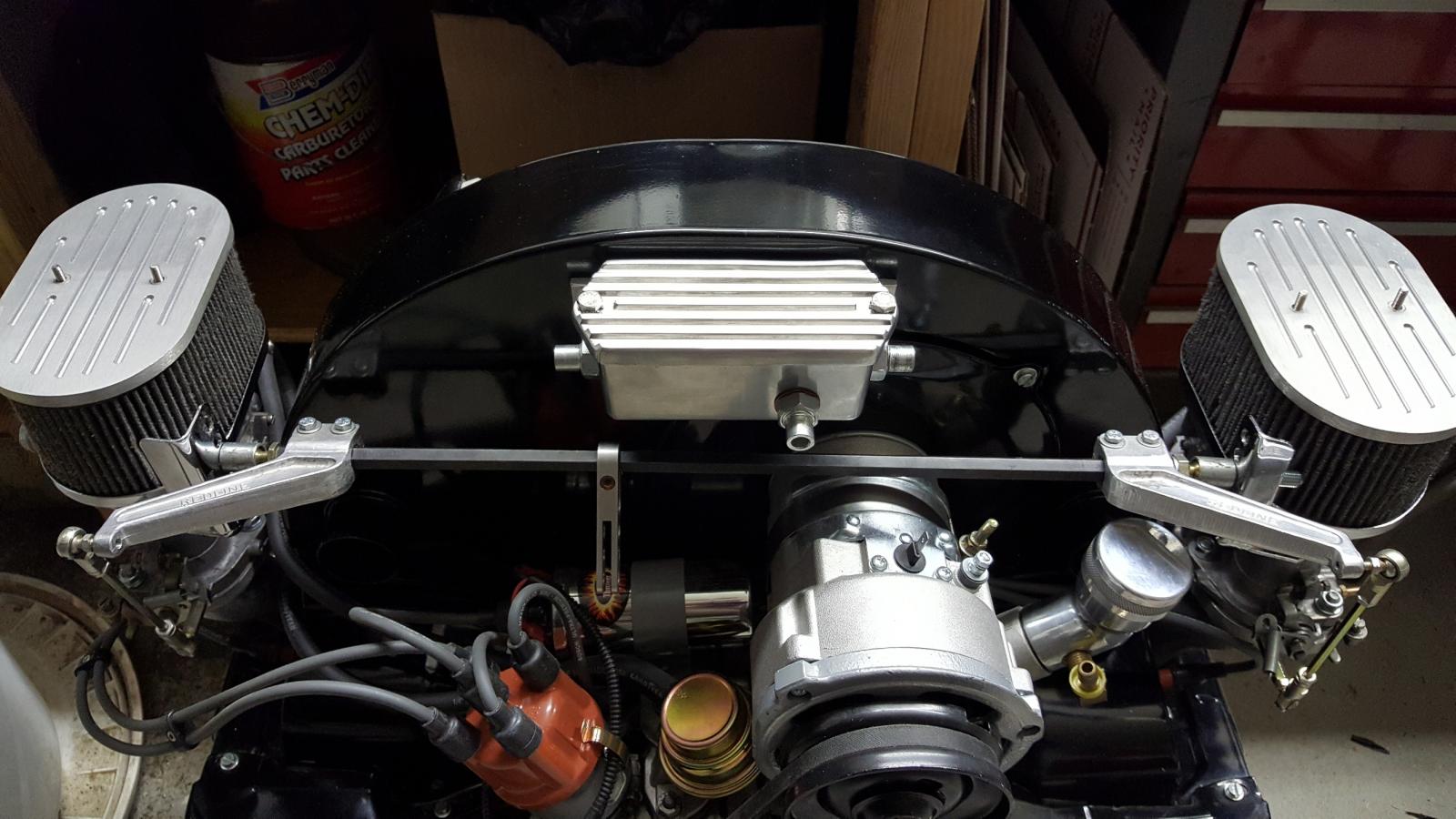

PostPosted: Wed Jan 31, 2018 6:46 pm    Post subject: Re: Rob's '63 Rag thread Reply with quote
Cleaned up the hood release cable, had brown overspray all over it. Goof off stuff works pretty good.
Also switched up the hex bar linkage to Redline one b/c it fit the carb bases better so they are no longer bent towards the aircleaners.

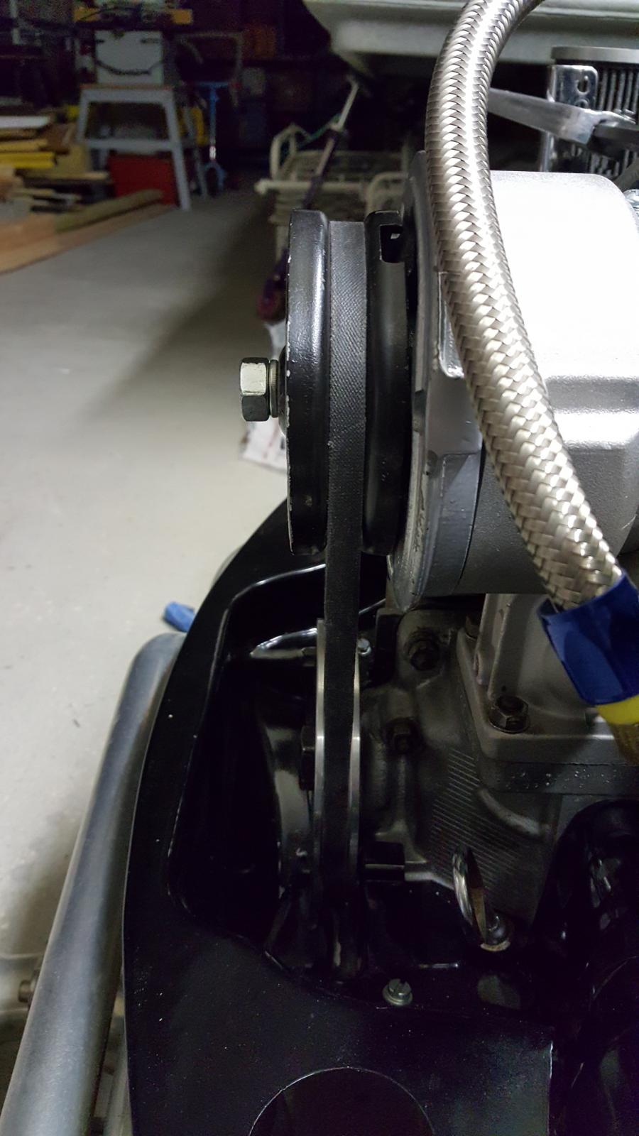

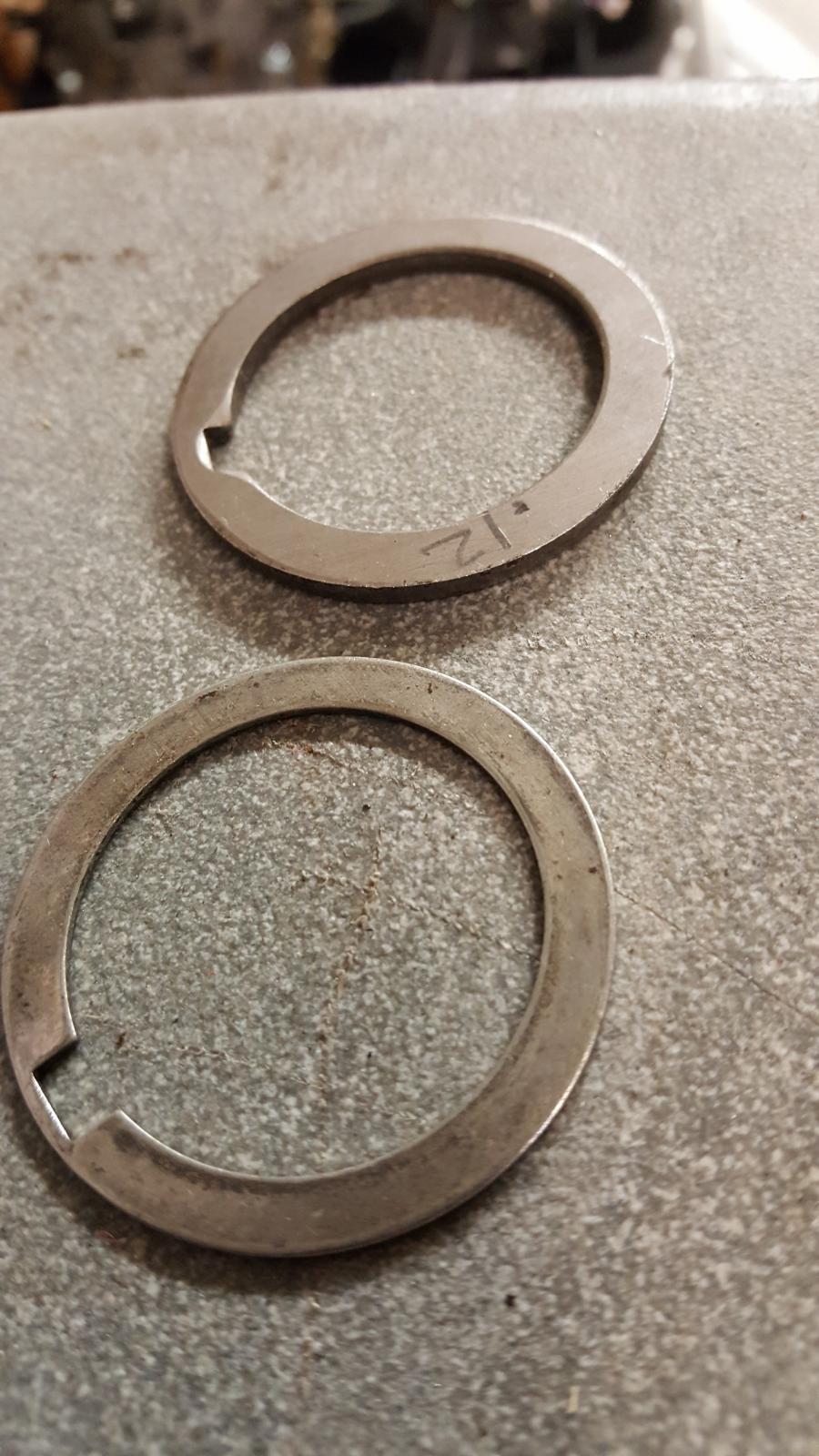

I had this issue of the alt pulley mis-aligned with the crank pulley which I read is common.
So I used these shims for the crank pulley to bring it out to match up with the alt pulley
Better now:
Also got around to putting the throttle tube wheel in:

63Ragtop NZ
Joined: December 04, 2007
Posts: 895
Location: West Auckland
63Ragtop NZ is offline
PostPosted: Wed Jan 31, 2018 7:34 pm    Post subject: Re: Rob's '63 Rag thread Reply with quote
Yep, had the same problem with the pulley, did you make the shims?
looking good!

Thanks man, I'm trying to get mine like yours and driving it already.. but I'm a long ways away Embarassed No I got the shims off another member on here but I think CB makes them. They make a longer crank bolt too to accomodate for the space you are moving the pulley out, but Idk if I really need it since I was able to tighten the stock one down pretty good.
