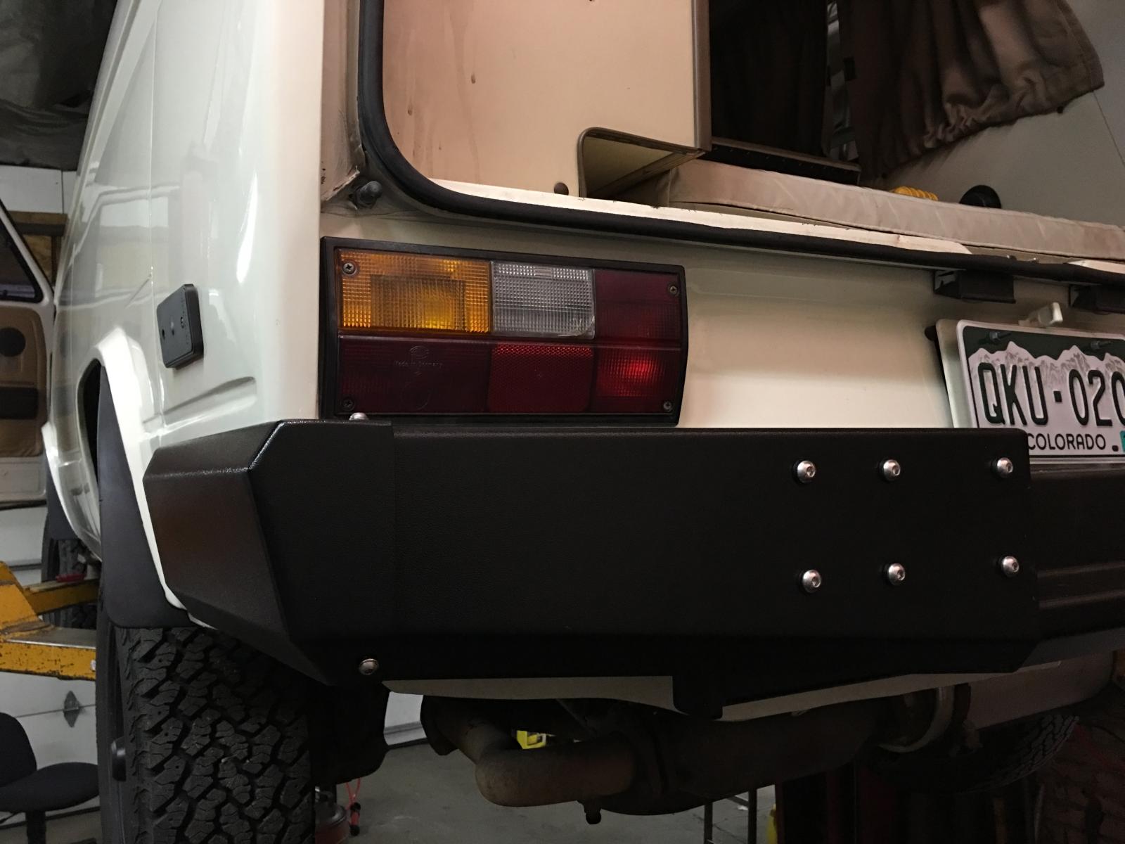

On my never ending list of things to do is build a rear bumper in a style that suits me. I'm not building a bumper any time soon. I ended up with a Rocky Mountain Westy rear bumper, great folks. It came beautifully packaged. It is a tank. You can mount it, then hang bikes off the back in a half hour. I grow fonder of it every day. My original reluctance was it's overall size. I'm over it. They do a great job. Twin Peaks Bumper. I give it a vote. It is a smart design that packages well for shipping purposes and future partial replacement should it get hit hard enough to hurt it. The quality of the build really exceeded my expectations.

PostPosted: Tue Jan 12, 2016 10:06 am    Post subject: Re: Diesel Vanagon Trailer hitch help. Reply with quote
Yep, I love mine too.
