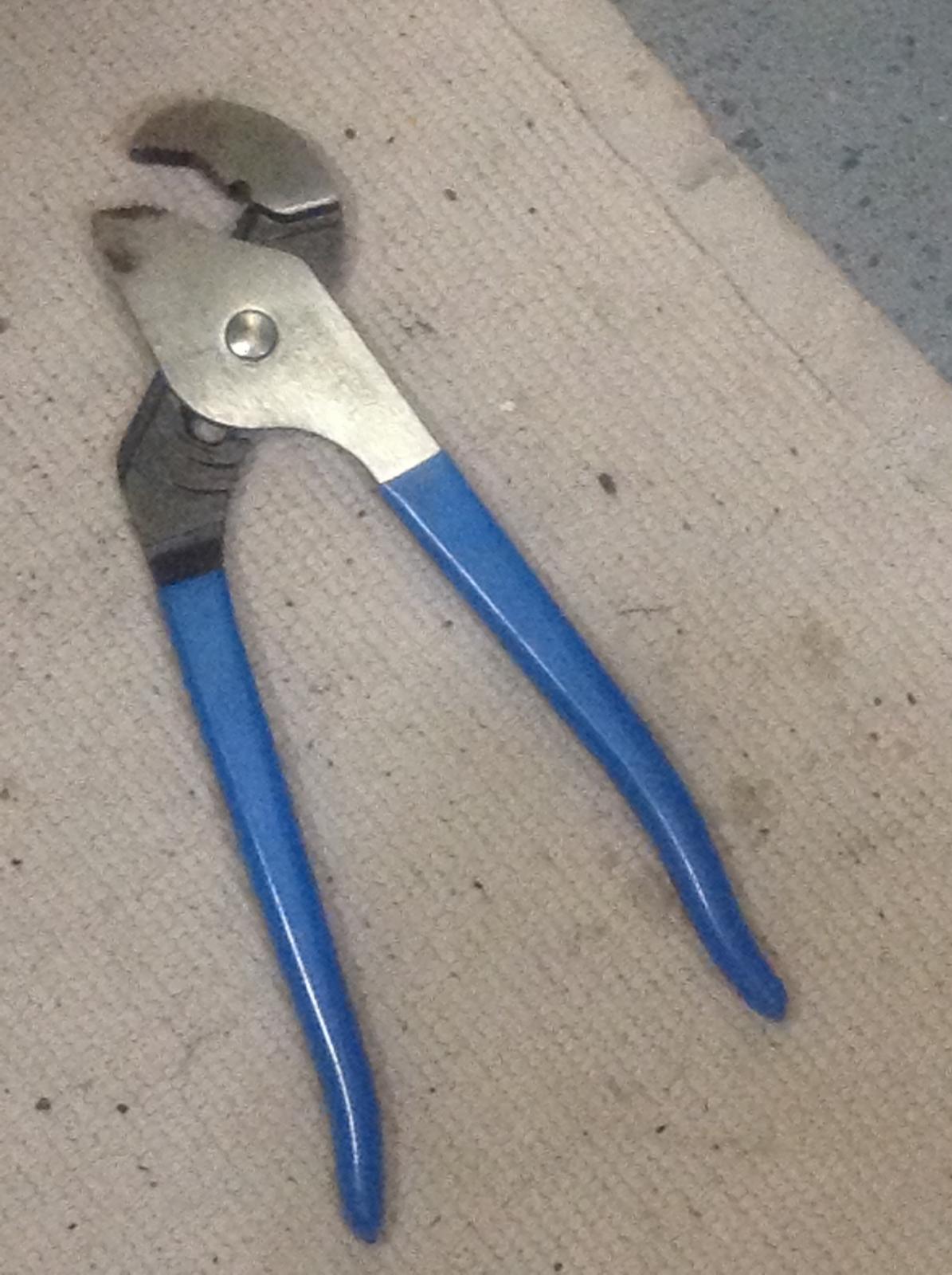

Take a look at your triple square tool, they wear with use and eventually get to the point they will not work even with a socket that is in perfect condition.
410 Channellocks do a good job of breaking uncooperating bolts lose.
Greatest tool for getting off stubborn bolts...

410 Channellocks or big ass Square Jaw vise grips. I keep a pair of these vise grips in my toolbox just for cv bolts. The round jaw ones usually just slip around the outside of the head, but the square ones dig in on it. Theyโ€™ve never failed me on cv bolts yet.

KentPS wrote:
A Nut Buster! That's a great tool!
