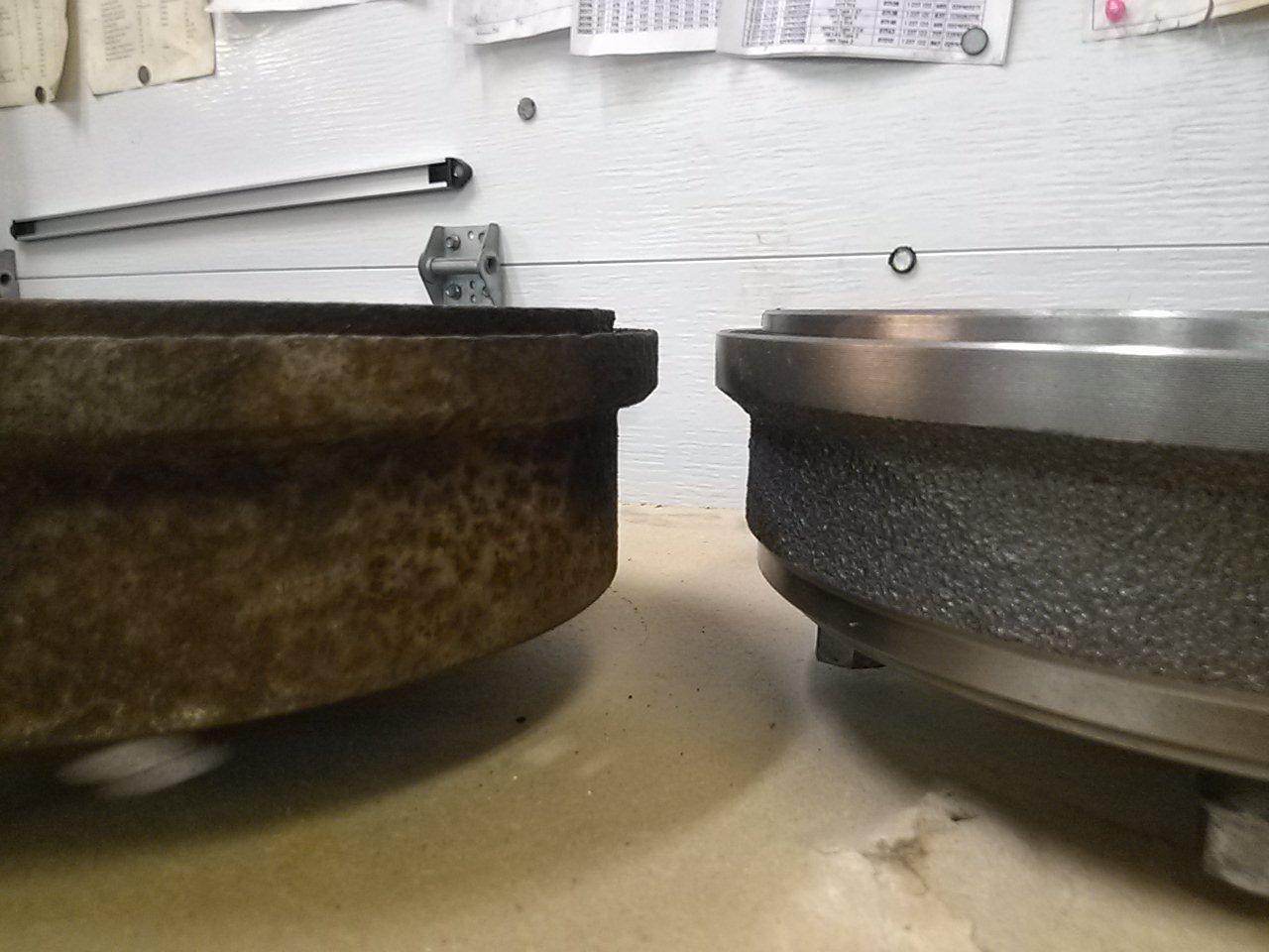

PostPosted: Wed Mar 23, 2016 7:53 am    Post subject: Re: Early T-3 transmission in a T-1 – Advantages/Disadvantages? Reply with quote
Well I bought the drums, and saw what happened: The backing plates slipped right inside them. So, in case anyone has the same question. The plates up to end July '63 are a smaller diameter than August 1 '63 and up, and correspondingly the (pinwheel) drums for the 1963 model year (to July 31st '63), are the same diameter as the Type 1 drums, but are much deeper (45mm).
I'm sure most of you already know all this stuff, but for those who don't, I thought I'd include my findings here...maybe save someone some unnecessary purchases and/or parts clean up.
So, doing some rough measurements, and looking at information in the parts book, this is what I’ve learned:
The drums from start to mid-August 1962 (61-62 model year) have an inside diameter of 232mm, and accommodate 40mm wide shoes.
The drums from mid-August 1962 – July 31 1963 (1963 model year) have an inside diameter of 232mm, and accommodate 45mm wide shoes.
The drums from August 1 63-July 31 65 (64 & 65 model year) have an inside diameter of 248mm, and accommodate 45mm wide shoes.
Here’s my old 63 and new 64-65 drums side by side. Same width, different diameter.
The backing plates for 1963 model year (mid-Aug 1962 to July 31, 1963) have an outside diameter of 248mm.
The backing plates for 1964 model year (shown as Aug 1, 1963 - July 31, 1964) have an outside diameter of 265mm. A different plate is indicated for 1965 up, not sure why as the drums are the same so I would assume the plates would be as well.
I can't speak to the pre-63 stuff, but there is a different plate listed for 61-62 model year -from start of production to mid-Aug 1962.
The diameter of the wheel cylinder hole in both the 1963 plates and the later (64-up) plates is 28mm, indicating that early and late wheel cylinders would fit in either.
Rear Squareback wheel cylinders from Aug 1, 1963 to July 31, 1965 (64-65 model years) are listed as all being 23.8 mm cylinders, however there are two different part numbers for model year 64 and model year 65, so not sure what the difference was there, but the front Super Beetle cylinder (23.8 ) is listed as fitting for both. The early Square cylinders (1961 and 1962) are bigger – 25.4mm, again with a different part number for each year.
The rest of the Type Three cars used only 22.2 mm rear cylinders from the beginning of production at least through to August 1969 (publication date of parts book).
