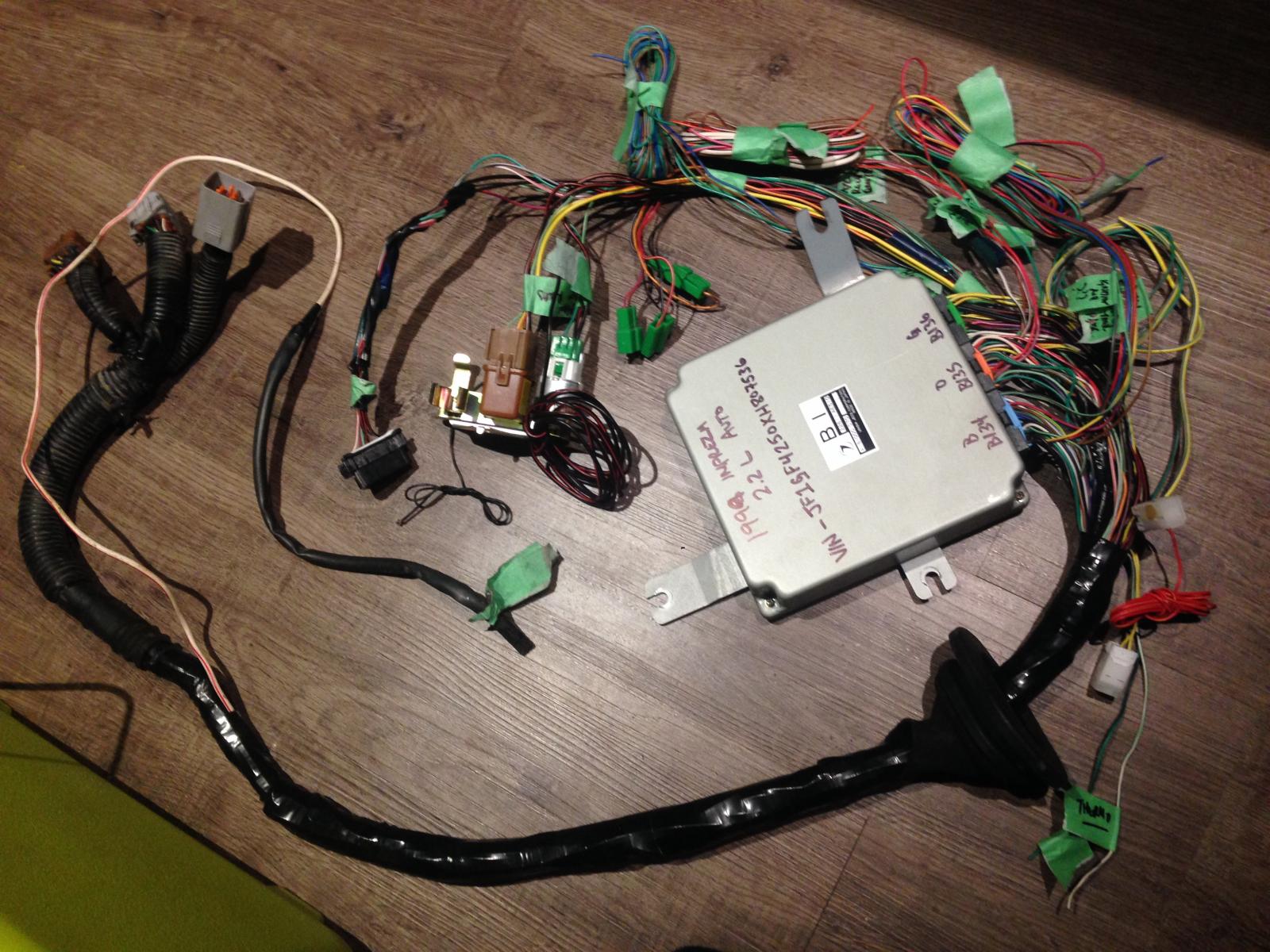

Wire harness out....
Weeding through the mess....
Once again, not a terrible job. Took about 3 hrs to get all the useless stuff out.
I decided to be extra thorough and label all the left over stuff coming out of the ECU. I'll be getting the Smallcar ECU interface board to deal with the trouble codes, some of those will get used then. This is what I ended up with...

Great start Steve, and nice looking harness.

I'm making some progress... It took a few days for the timing belt and rollers to arrive but I finally have all that on and buttoned up. Glad I changed the works....one of the rollers was actually near seized and the belt was cracking. I think this engine was nearing a big uh-oh.... Compression is good and the head gaskets seem ok. I did the water pump and cam/crank seals while I was at it...
So I have the phase II EJ22, with the IAC built into the throttle body, and I have the reverser from Busaru. He recommends modding the port on the TB to get around the 'blockage' but there was room on the TBR to do this...
This lets me keep the subi porting
In the pic it's just tack welded for placement. I've since JB welded it to seal it up
