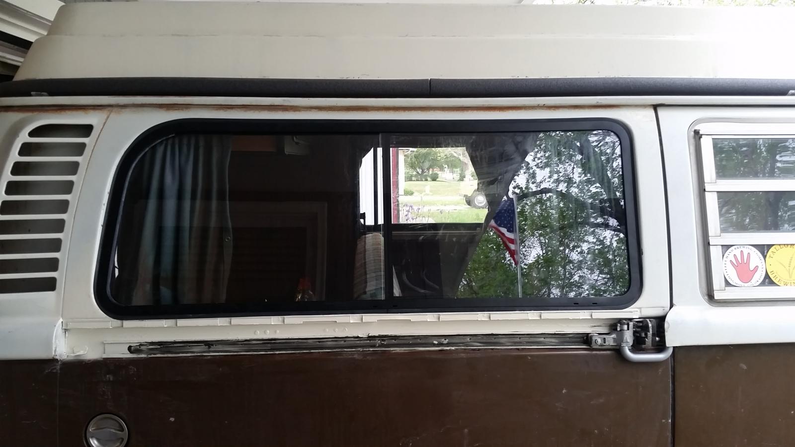

I "fixed" my leak with a set of Just Kampers rear slider windows.
There is a lot more air flow through the bus with those than there ever was with the little, leaky vent window.

[quote="vwwestyman"]I "fixed" my leak with a set of Just Kampers rear slider windows.
Now those are pretty slick. I've seen slider windows that replace the middle side windows, or jalousies before, but not the back side windows. Have you had them in for awhile? And they don't leak?
Thank you.
I installed them late spring this year. I haven't noticed any leaks with them at all. I can tell you for sure that if there is any kind of leak, it is very, very significantly less than the old window. And the air flow on a hot day is very nice indeed. Rear passengers certainly appreciate them!

PostPosted: Fri Sep 09, 2016 8:01 pm    Post subject: Re: drain hose in my 78 Westy closet over the spare tire well Reply with quote
Good report. Thanks Dave. Unfortunately, Just Campers will not ship them outside of UK.
"Sorry, you have items in your basket that can only be delivered to a Mainland UK address."
Hey, you're in Kansas. How the heck did you get them?

I got them through CIP1 a year and a half ago when they had a "March Madness" sale. I stored them for nearly a year before I was able to install!
I think CIP1 is in Canada so that might be a good source for the OP.
But Bus Depot also sells them (along with a lot of other Just Kampers products--I didn't know they had them when I bought them from CIP1). So that would be a good source for folks in the US.

Holy guacamole. Bus Depot does indeed have them, but at $270 each side, = X2 = $540! I know, spend the money, cry once. I just installed over $400 worth of Koni shocks today, so I know how that goes…
Thanks for the info! Shocked

I'm happy with them, for sure! I was lucky enough to find a set of the middle sliders on the classifieds once. So I only had to buy two sets of rear sliders to have sliders all around on the '73 and rear sliders in the '78.
Caesar likes the middle sliders in the '73.
