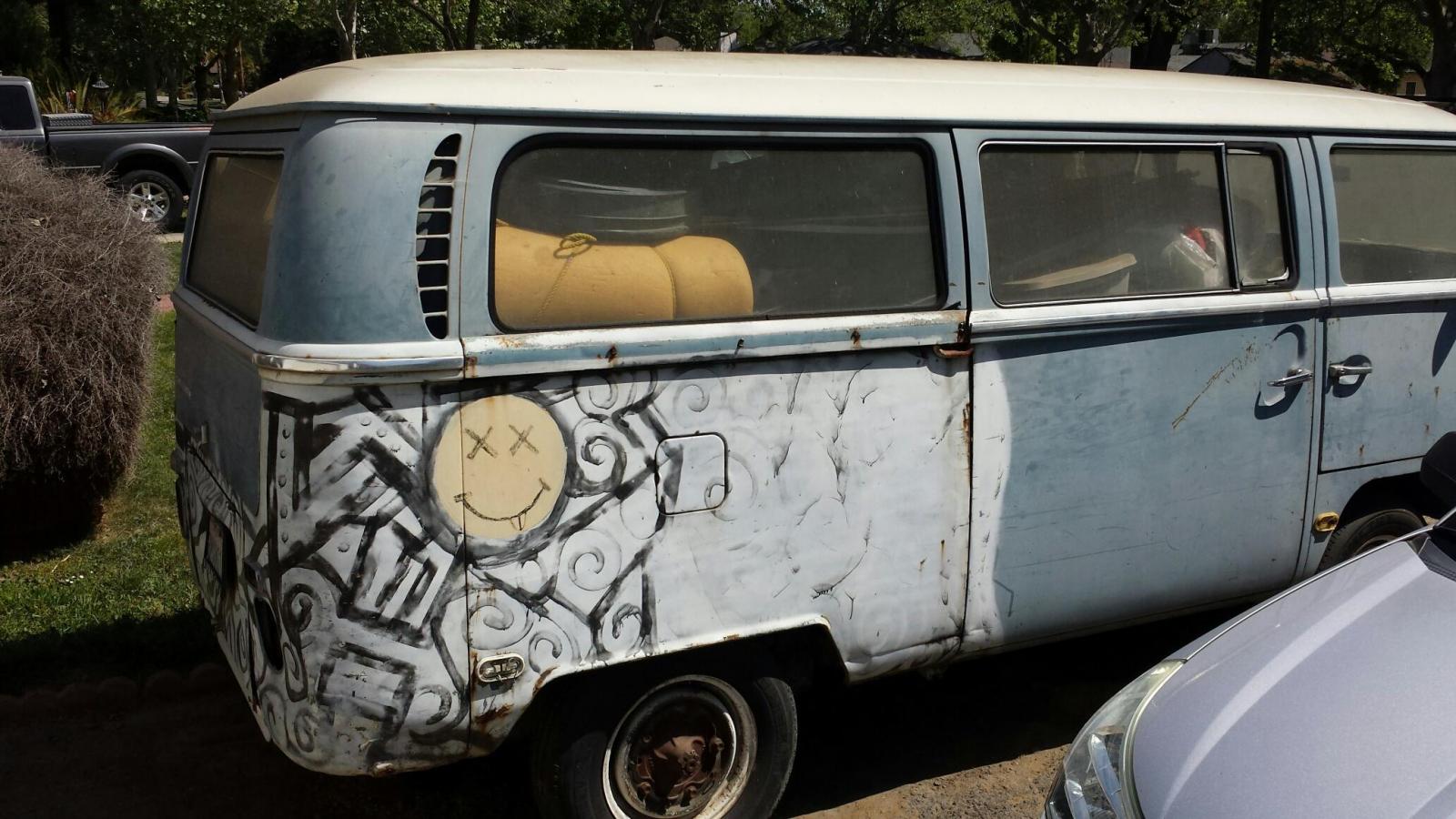

Pic from the PO with the "art"

I did some work on the bus yesterday and today. Yesterday I changed out the headlight switch due to a broken rheostat hoping that it would solve some light issues I was having. The brake lights don't work right when you have the headlights on. Since that didn't work, I'm back to searching for bad grounds somewhere. At least I get to return the switch now and get my $25 back. That wasn't very interesting. Today was a bit more productive. My girlfriend helped by cleaning all on the interior metal of the bus and the seats. That seats came out great and I wanted to reupholster them but now I'm doubting my self a bit since they cleaned up so well. While she was doing that, I started stripping off the rattle can primer that is in it so I could get down to the OG neptune blue.
For this section I just used a rag and some acetone-free nail polish remover. It's a pretty labor and time intensive process but I think it came out better than I could have asked for. (It took almost two hours for that one section) Tomorrow I'm going to try using oven cleaner to strip some more paint and see if I can get the same results in less time. If not I will stick to the nail polish remover since it is so much cheaper. I have considered wet sanding but I think that has the potential to be a bit too abrasive and I really like how it came out today. I also got a $5 off coupon from O'rielly today so I went ahead and picked up some new spark plugs and I'll throw those in tomorrow. I plan on trying to strip off about that much paint or even a little bit more each day and it should be done in a week or two.
I do have a question for everyone out there. On the opposite rear corner of the bus there is some sheet metal damage and I want to pound it out a bit from the inside. Is there any way I can remove some of the interior sheet metal to get to it or do I just have to reach my arm up on there with a hammer from the engine compartment? Thanks.

So I was able to do some more paint stripping yesterday and boy are my hands sore now. It's coming along slowly, but never the less coming along. I have found the best way to strip the paint though. What I have been doing is spraying down the panel with heavy duty safeway brand oven cleaner and letting that sit for a little less than ten minutes or so. Then I'll hose that off and wipe off all the primer that didn't come off after hosing it. Then I go in with the acetone free nail polish remover by hand to finish up the remainder of it. I like doing it this way because the oven cleaner does the bulk of the job without really touching the blue, and then I can finish by hand when I have more control. Heres what we're looking like right now. The front is about 75% done with the nail polish remover and the side is just oven cleaner right now.
Got some nice patina going up above the vent. I like it a lot.
I can't wait to get it all off so I can give her a polish I can put my deluxe trim on!

Alright guys. I have been putting in quite a bit of work into the paint of the bus since I last posted. I have been continuing the method I said works best for me before, the oven cleaner then nail polish remover, but I have been a little heavier on the oven cleaner since it makes the job so much easier. What I have been doing is spraying on the oven cleaner and then once a significant amount of the blue is exposed I go in painting on the stuff with a brush so I don't ruin the blue. Then, once I've gotten to a point where there isn't enough primer to really paint on, I go in with the acetone free nail polish remover. After that I give it one final wipe down with the nail polish remover with a clean rag and then get to buffing with a rubbing compound. I have yet to wax anything because there are some spots that I may want to buff out a little bit more. I really love the patina it has on it too. But I guess pictures do all the talking so here ya go!
First one here is with the gauge cluster and glove box stripped back to black.
This is with the whole passenger side sprayed with oven cleaner without any painted on yet.
This is the start of buffing.
Finished product on the front, just not waxed.
And the side. Needs some more buffing in spots and a wax.
I also through on some new tires yesterday and feel much better about driving it longer distances now. I know the front tires look very small but I'll need them that small once it is lowered, which shouldn't be happening too long from now. I also fixed my fuel gauge as it wouldn't register anything before and now it's all good. I don't feel like I have to fill up nearly as often hahaha. Hopefully within another week, I can get the passenger side and rear all stripped down. I do have to repaint the panel that the fuel fill is on since it was taken down to bare metal for the art that was on it and the engine hatch because it was a replacement and it yellow. I also picked up a hub cap from a local antique store since I was missing one. Got it for 8 bucks. I'm feeling really good about all of it though!
Bagged 1968 Neptune Blue "Deluxe"
